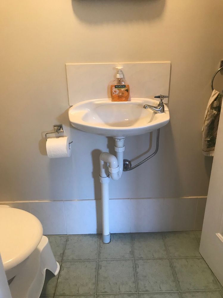

hi there, just wanting some ideas on how to hide these pipes without using cloth material

Thanks Jason. I’m glade I joined. I’ll need something with these dimensions, which I don’t think are very big at all. 43cmW x 70cmH x 20cmD. Thinking of creating a C shaped cover I can just slide into place. Want to do it on a small budget too. Any thoughts

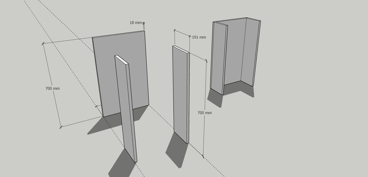

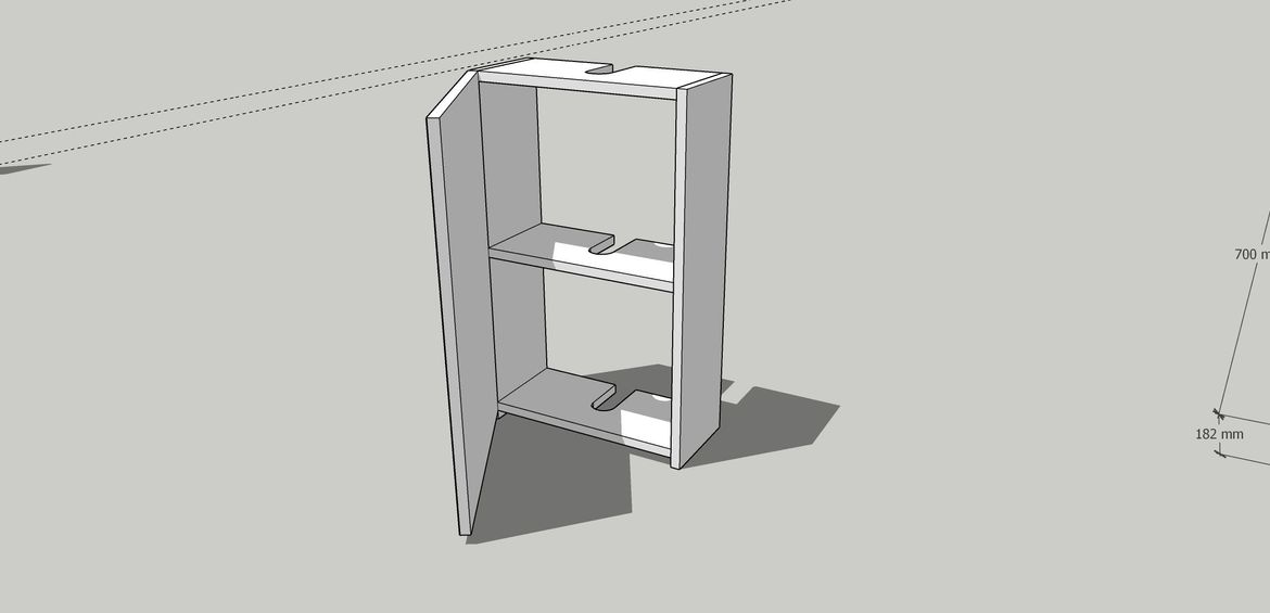

Hello @LeeA2569

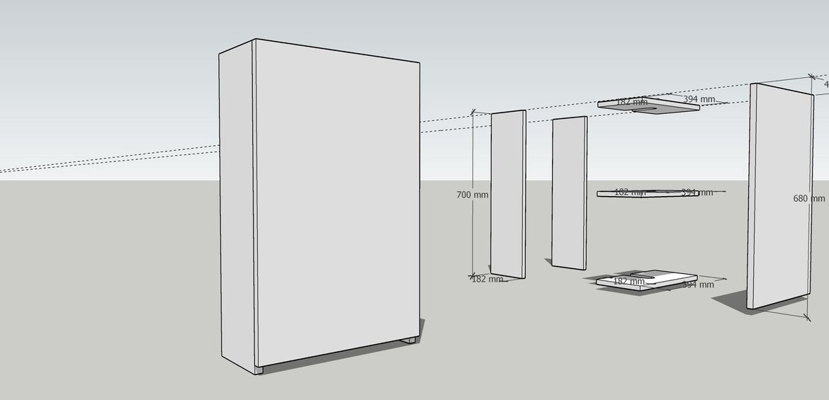

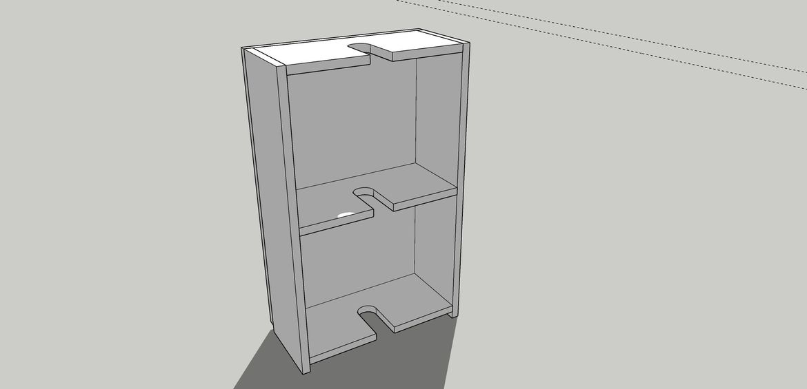

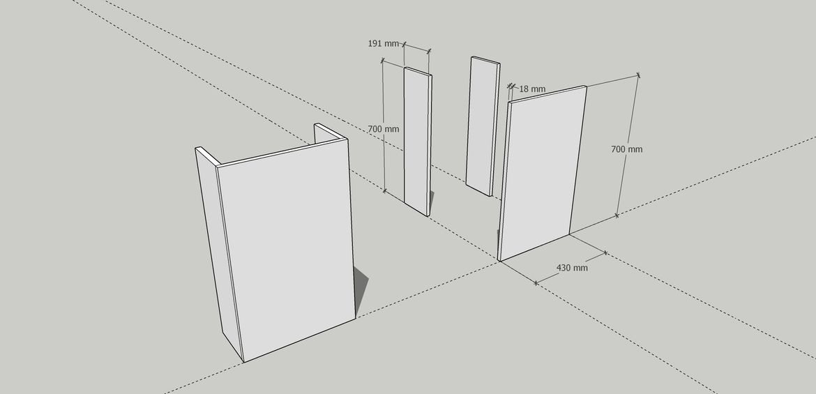

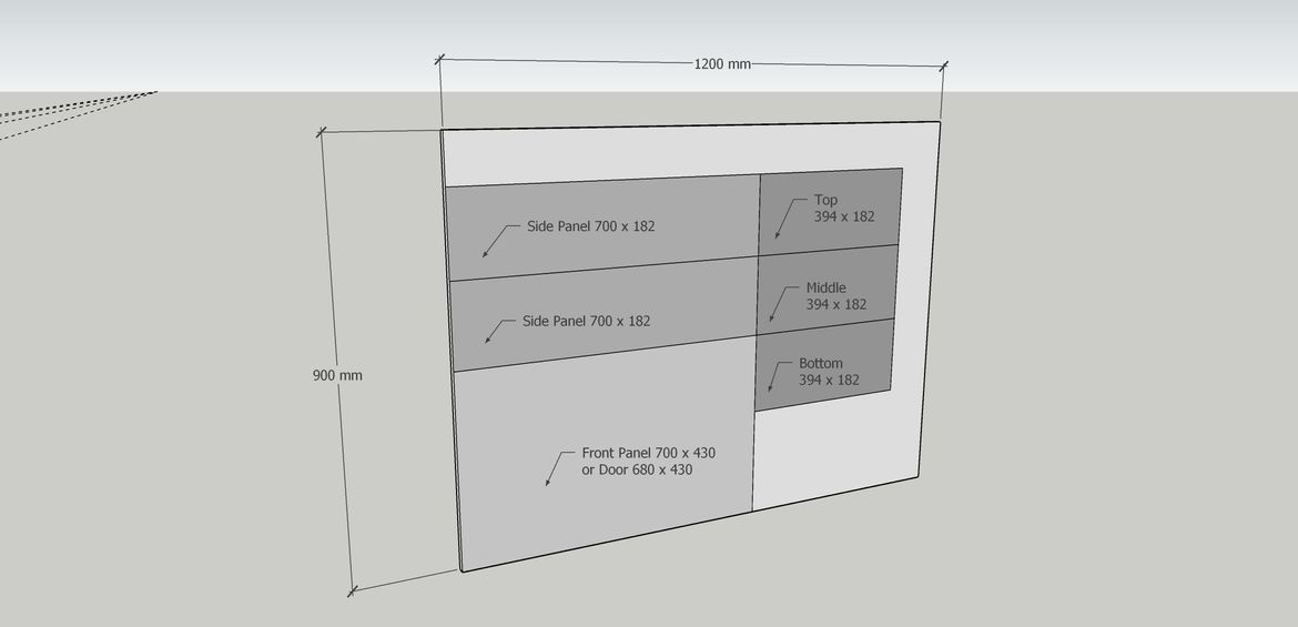

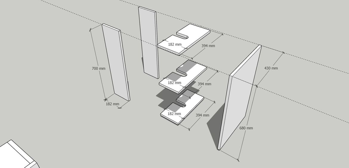

Thank you so much for putting up the measurements. I've made a few sketches of your proposed cover. I've also modified them so that you can get a little bit of extra storage for your vanity cover. I suggest CustomWood MDF 1200 x 900 x 16mm Standard MDF Panel. I've placed a cutting pattern at the bottom but please double-check the measurements as I've placed the thickness of the MDF at 18mm instead of 16mm. I recommend using Zenith 8 - 10 x 60mm Galvanised Countersunk Rib Head External Timber Screws - 15 Pack. Paint it with Taubmans 500ml White Sample Pot.
Please keep us updated with your progress, we look forward to seeing your pipe cover assembled and ready to go.
