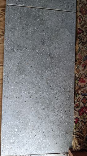

I've decided to put some ceramic tiles to replace some worn old carpet an a high traffic area.
The tiles are Dura Ceramic tiles, 60x30cm, suitable for what I need.

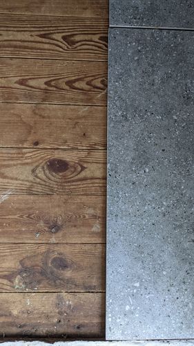

So it's going on a hardwood floor. I've cut the "offending" carpet to prepare the area.

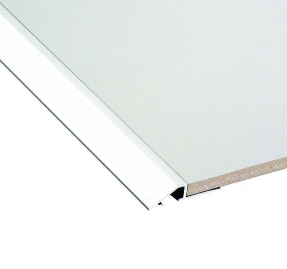

So we went to our local Bunnings to get the trim. This was an adventure. There are various trims, but the advice was this:
So, understand this is the "underneath" part.
Or are we getting it wrong, and this is not the way to go?

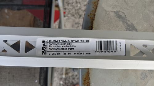

We were going to try Floating floor jr Trim.
We thought that went with the Duratrans (above); yes, we realise the floating floor trim needs "magic plugs" (awful name BTW, and hard to find)
