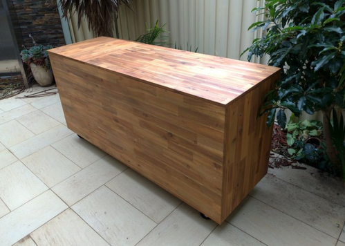

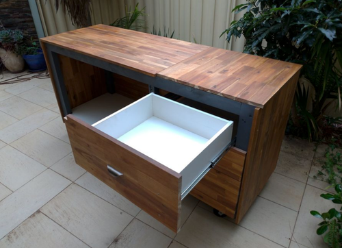

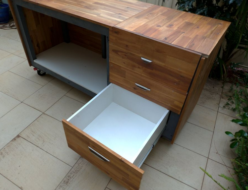

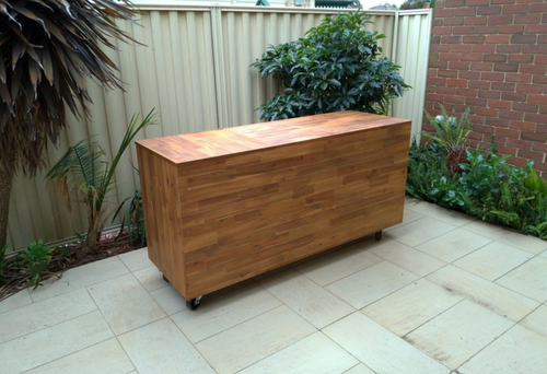

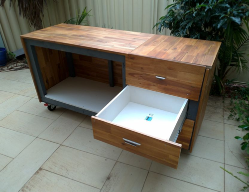

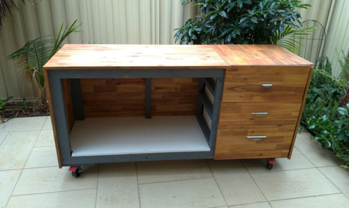

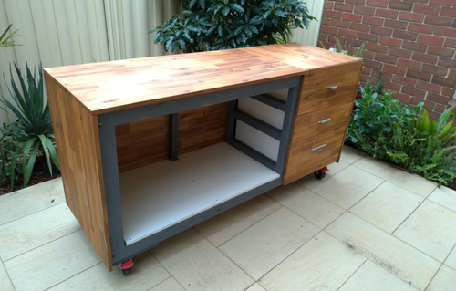

This is actually a project I made a few years ago and sold when I moved to a flat at the time. But I thought I'd share it for some inspiration. My woodworking skills have gotten better since, so I'd recommend spending a bit more time thinking how the draws, etc fit into the unit so you don't end up with weird cuts like mine 😋
The guy who bought it owned a coffee shop and was really happy because he said something like this would cost 1000's and weigh much more (I built it entirely out of wood), so hope that is a big carrot to making one of these yourself.
I used MGP10 framing timber for the structural and if I remember correctly, Acacia panels for the exterior. Now in terms of the MGP10, this would not be suitable for weather exposure (When I built this, I didn't know about treated pine vs MGP10). Also not sure how well the Acacia panels fair externally under rain, etc ( @MitchellMc perhaps you know if they can deal with weather?), but you could keep it in a roofed outdoor space. And use treated pine framing for longevity.
