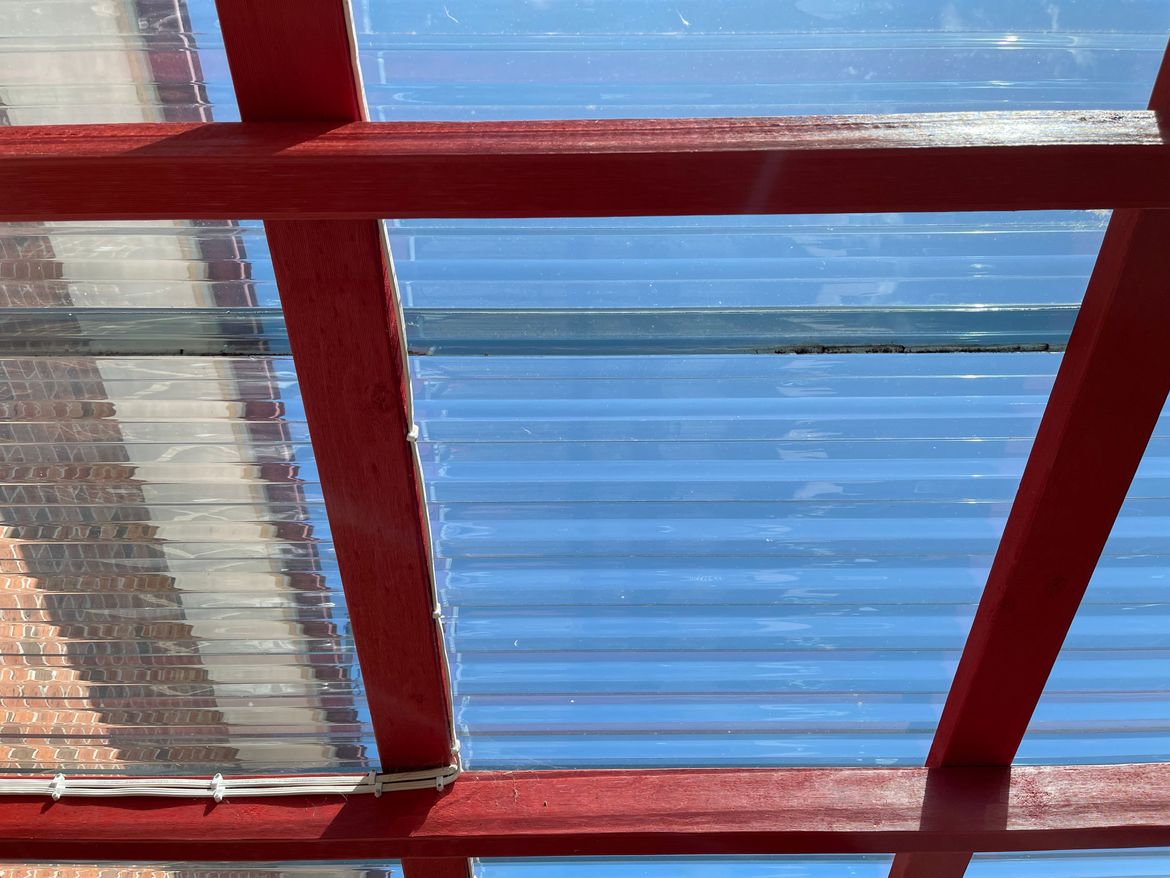

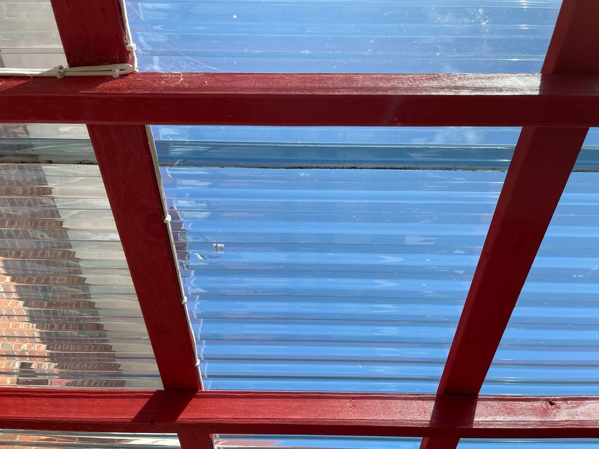

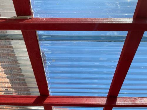

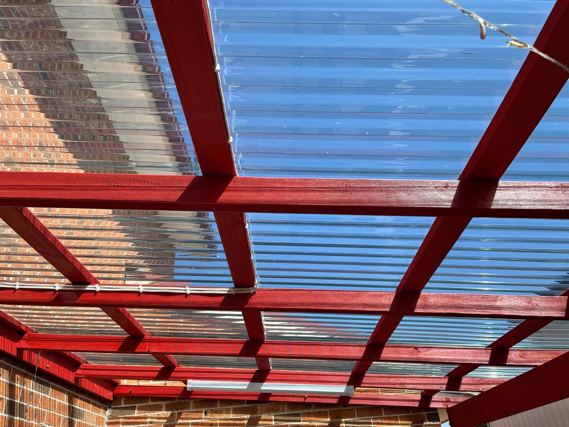

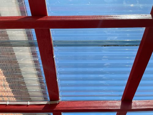

During Summer it gets very hot under the pergola. Any ideas of how to insulate and reduce the heat please. Thank you

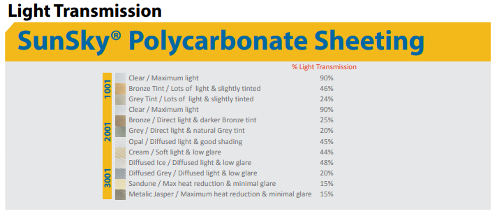

You might like to consider swapping the sheets out to something that doesn't have near 100% light transmission. Once the UV rays penetrate the sheeting they'll strike hard surfaces and heat them up. They'll then radiate that heat increasing the air temperature within the pergola. I like @EricL's idea, but my preference would be to have the shadecloth on top of the roof sheeting instead of below.
