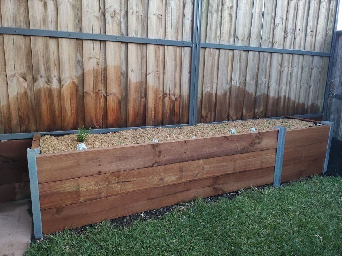

Here is a raised garden bed I have recently built which become a herb garden.
For the garden bed, I have used the following:
Retain it Joint Post
Retain it corner post
Treated pine sleeper
Concrete
Garden Soil
Pea Straw mulch
Some galvanized angle brackets to attach side sleepers to existing retaining wall in the back

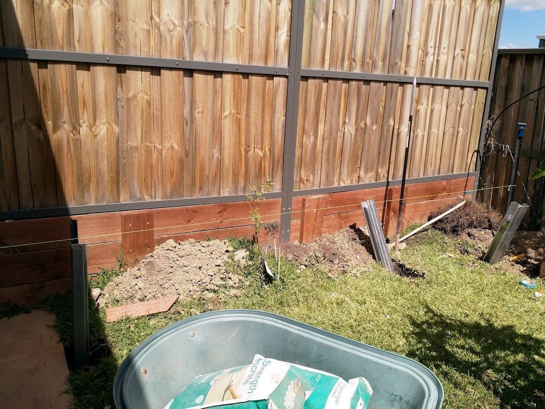

Getting the posts inFilling with soil
That looks fantastic @Neo19. What an ingenious way to use the existing retaining wall to your advantage.
Many thanks for including the products you have used. I'm sure any other members wishing to accomplish a similar project will appreciate the details.
Please keep us updated on the progress of your herbs and vegetables.
