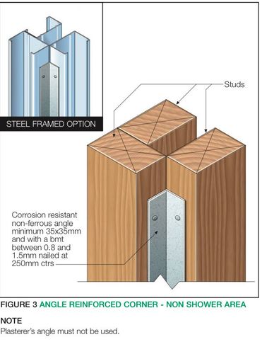

3. What size and thickness aluminium angle do I use in the internal corners to install the Villaboard to the timber stud frame? James Hardie recommend 35 x 35 x 0.8 mm non ferrous angle, however I cannot see any products that are this thin in stock.
