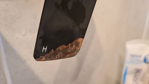

Hi MitchellMc
Thank you for getting back to me. Please find the image attached.

@Aardit,

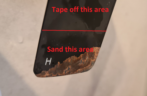

I'd suggest you sand that rust off with some 240-grit sandpaper. Once you have sanded the majority off, take some Dulux 300g Metalshield Epoxy Enamel Gloss Spray Paint Black and spray some into its cap. Use a Craft Paint Brush to try to touch up just the damaged portion at the end. You might be happy with the results, and if you are, that's fantastic. If it doesn't look great, you can tape off a section at the end and sand the untaped area. Make sure you cover the rest of the surrounding area with a drop sheet. Use the spray paint to coat the end. You'll clearly be able to see that the tip is a different black than the rest, but it could look like it was manufactured this way. If you are still unhappy, you'd be looking and sanding the whole tap and re-coating, but I'd try these steps first as it could save some effort.
