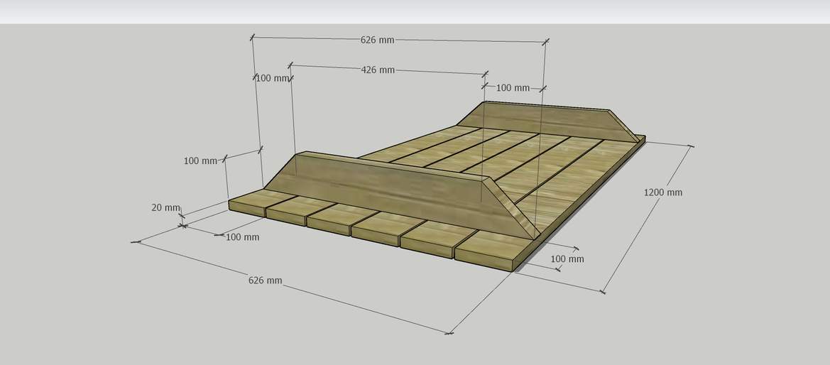

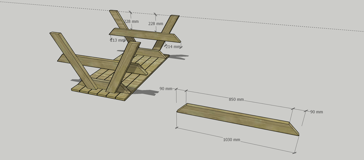

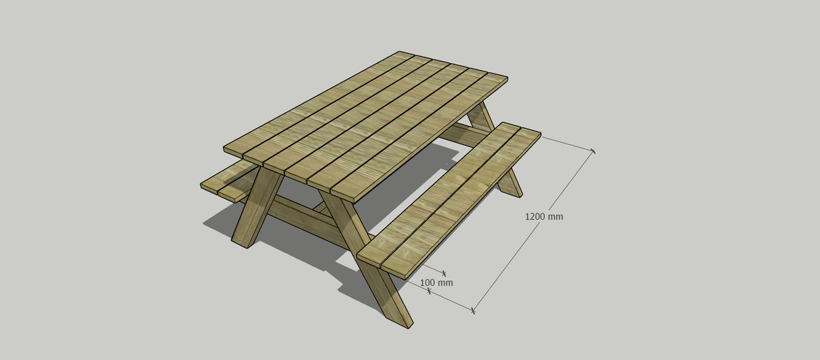

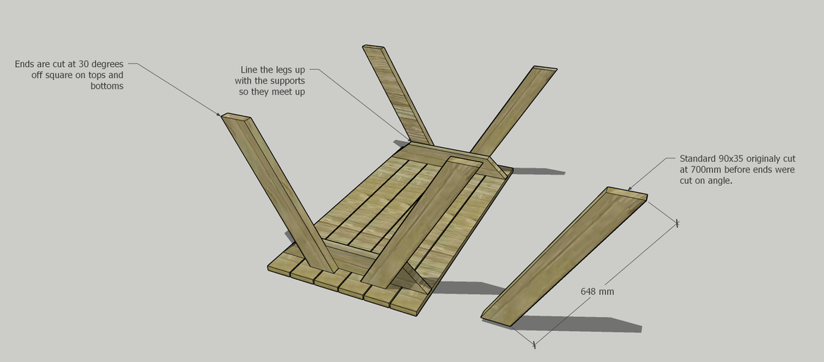

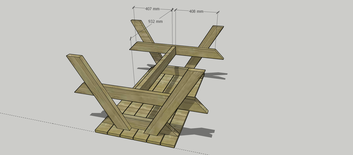

Let me tag @Jjoo6699 to make them aware of your query. I believe that Jjoo6699 mentioned that they based their design from Ana Whites at Pre-school. But with a bit of modification added in the mix. It would be handy to know what the new dimensions are of the picnic table that has been modified. In the meantime, I'' try and draw up a plan for you and as soon as I'm finished, I'll post it here. Please give me some time to draw it up.
Thank you for your patience. I've drawn up a basic general plan to give you an idea of how its put together. Adjustments will be necessary depending on the type of timber you'll be using. In the plan I'm showing you I have used pallet panels 100mm x 20mm. If you use smaller pieces, please adjust accordingly as it will affect the other parts of the plan. For the framing I used 90mm x 35mm which is a standard for framing timber. My best advice is to make sure to use galvanized or coated screws so that they will not rust straight away and provide a long service life.
