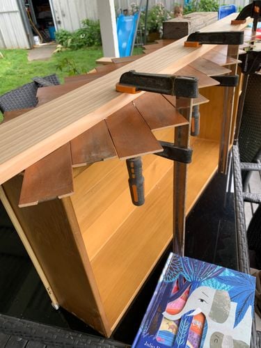

I cut the top of the change table leaving just the cabinet. I sanded the top to blend in my cut marks. The draws were sanded and the under side of the slats to get a good bond when I applied the glue.
I cut the slats approx 150mm and marked a centre line on each draw. I glued the cut slats in a herringbone pattern. I placed a board on top with weights to get a good bond.

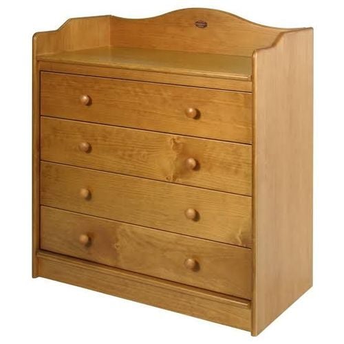

original change table below

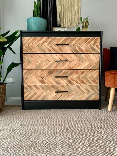

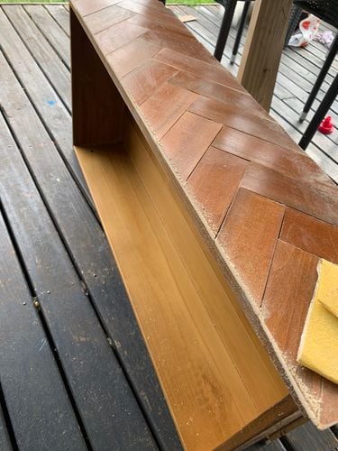

Once the glue was dried, I flush cut the over hang and sanded it flush to the original draws. I left some original stain on the slats as I wanted more of a rustic look.

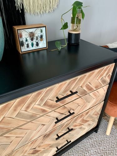

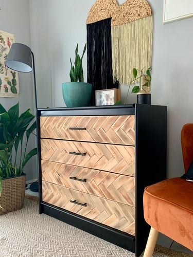

The frame of the draws I used ESP rather than sanding the entire thing. I sprayed the frame with my Wagner spray gun, for a total of 3 coats. I sanded on the second coat with very fine sand paper.
The handles were drilled in and now the kids aren’t getting their draws back!!!
