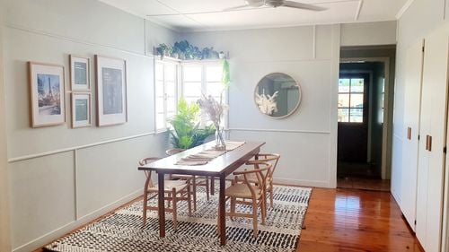

Just wanted to share the dining room table I made from lengths of pine. Quite a bit of time spent sanding this as most of the pine I got wasn't flat. Rounded over the edges with a router. Then gave it a stain and varnish. The hardest thing for me was making it stable. To help with stability I added aprons and some 45degree supports for the legs.
I also made the oak shelves above the windows for the plants. And made new door handles out of oak, using the router to give them a bit of a lip to grab on to.
