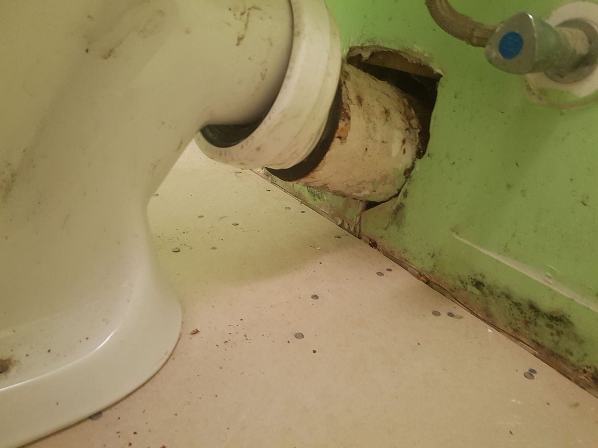

Hi @Maxtiger,
You'll likely need to remove the current offset and measure how far it is offsetting the pipe. You'd then step up to the next larger offset. The issue we'll experience, and I'm sure you are too, is that without knowing what's on there now, we could only guess from your image.
It's likely a 20mm Kinetic Universal Offset Trap Adaptor Pan Connector on there at the moment, so you'd switch it to a Plastec 40mm Offset Flexible Fin Pan Connector. You can see in the image below that the 20mm offset appears very similar to what is there.
The next size up offset is the Plastec 60mm Flexi Fin Pan Offset Connector, which appears to be far too large.
Thanks for advice!
I had a helpful tiler who used the Kinetic offset but there was a little bit of leaking.
He then repaired by sealing it with silicon sealant?
Is this a temporary fix do you think?
He's sealed the toilet down also into place but not screwed.
Appreciate your advice please!
Thanks from M
Hello @Maxtiger
Using a silicone sealant is more of a stop-gap measure than an actual repair. However, if it has stopped the leak, I would leave the repair alone for the time being. The problem with using silicone is that it's difficult to say when it will give out. If it had been Selleys 290ml Clear Storm Waterproof Gutter And Roof Sealant, I would be a bit more confident. This silicone is rated as a clear waterproof sealant and can be applied even on wet surfaces. For the moment just keep an eye out for any leaks. When the silicone gives way, that'll be the time to repair it properly.
