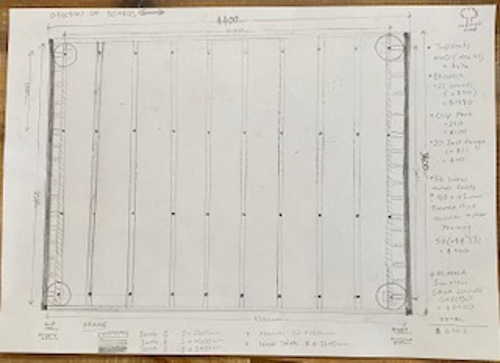

I'm a newbie attempting a deck. Above are my basic plans and rough costings.I
'm a bit overwhelmed at the choice of timber for the joists. I plan to use Tuffblocks for the foundations (the 'dots' in my diagram).
The deck is 3400 x 4400 in order to hold a 3000 x 4000 Mimosa Lava Portsea gazebo fixed on the top. So I needed to consider 2 things - hiding the Tuffblocks (they are 300mm diameter - I've drawn the 4 corner ones in as circles) AND making sure the Gazebo poles sit over the corner foundations.
So the deck extends a total of 200mm out each side (with noggins to stablise) and I've sourced all materials - but what timber should I use? It sits in the tuffblocks, has to be at least 35mm depth. Ideally I'd rather make them 3400mm long (so not buy 3000mm lengths and have to join them). The deck will be made above an existing brick paving area with hte joists sitting 90mm above ground.
