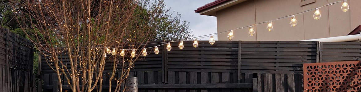

weekenddiyer secured festoon lights using eye hooks and cable ties
Screw hooks and eye hooks are available in a range of sizes and can easily be screwed into any timber. These are ideal for use in conjunction with cable ties. For larger hooks, it’s wise to pre-drill first.
A cable can be slung in a cup-type screw hook and then held in place with a cable tie. Or thread a cable tie through an eye hook and around the cable to secure it. Only use galvanised or stainless-steel hooks outdoors.
