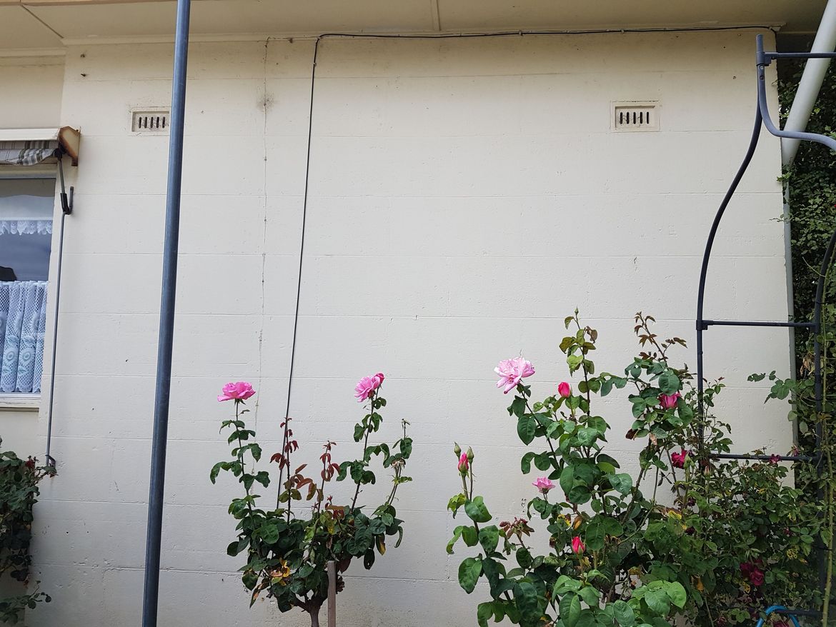

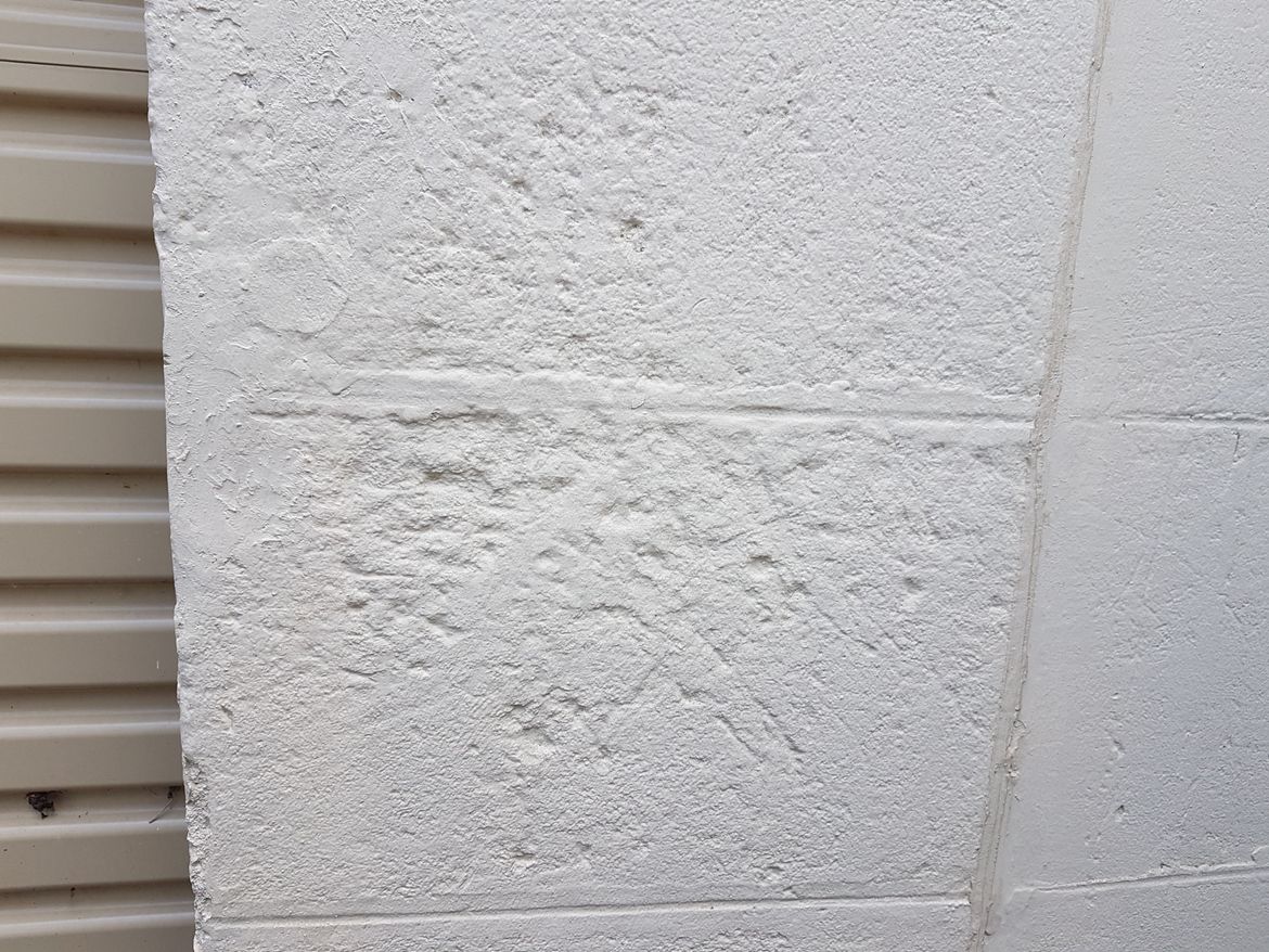

Hi EricL,
I have posted a photo of one of the outside walls of the house to be rendered. The close up shows a couple of the limestone blocks. Any advice on prep work needed and products available would help.
Thank you for posting those photos. The longer I look at your wall, the more I'm convinced it is a cement block wall. I suggest testing a hidden part of the block and scraping the paint off. If you run into light grey dust, it is a cement-based block. However, if it crumbles and is easy to penetrate, it could be a Hebel block. Either way, the paint must be removed from the wall before you render it. I suggest using a Grinder in combination with a Multipurpose strip disc. Make sure to use a Pressure washer to clean the wall after grinding it.
Limestone by its nature is soft and easy to scratch. A cement surface on the other hand is hard and is difficult to damage. Once you've determined which one you have, you can then decide if you want to render it.
If you decide to render it, I recommend adding Bondall BondCrete Cement Additive to your render mix. Make sure to remove all the loose masonry and debris before rendering the wall.
