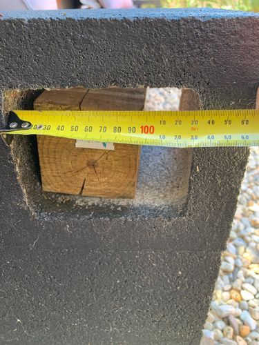

I live around 100 km from my nearest Bunnings, so have to be well organised before I get there so I don't forget anything!! How large are the holes in the besser blocks?
Hi @LaurelS,
@sandy_d might be able to take a measurement for you. The holes would be at least 100 x 100mm as that's the sized post they've used.
@LaurelS The hole is 135mm by 110mm and the posts I have are 100x100. Let me know if you have any other questions. I’ll keep my phone close by today 😊
