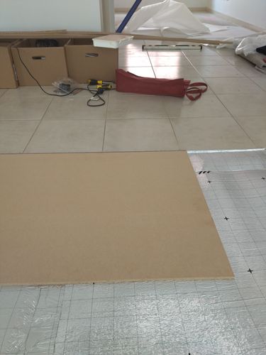

You could use a construction adhesive, but it might be an idea to spread it evenly around with a DTA Australia 4mm V-Notch Bright Steel Trowel. If you squeeze it out of the caulking tube without spreading, you'll likely end up with lumps and wavy MDF boards.
You'll also need a vapour barrier if you are laying laminate flooring over concrete. Any moisture in the concrete will travel through your MDF and into the laminate flooring otherwise.
I don't believe you actually need to adhere the sheets down. You could lay your vapour barrier onto the concrete floor first, then the MDF sheets and then your laminate flooring. It's a floating laminate system and doesn't need to be fixed, so I see no reason why the MDF would need to be either. I prefer the vapour barrier goes down first to protect the MDF from moisture too.

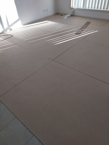

Today I bought 1 sample 1200mm* 600mm 9mm MDF Panel Standard and found it perfect match the level.. so I wound like to get more to have the job done..

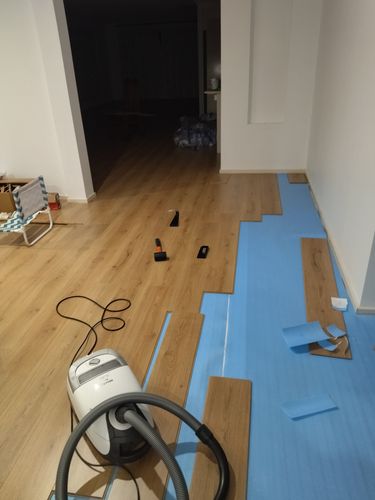

Thank you for your information. They matched price for me. It is perfect level. And now laminy floor is applied. Looking good.
Thank you so much for posting an update. That looks very nicely done. It's great to hear that the MDF panels levelled your floor and you got them at a good price. Did you use glue or did you just lay it out on the floor? Your new laminated floor looks fantastic, I'm sure our members will be keen to see it once it's fully assembled. It looks like you've mastered the installation of the laminate flooring. But if you have any questions we can help out with, please don't hesitate to post them.

Can I ask whether you glue or nail the mdf down or just left it floating?
Hello @metamorphosis56
Thanks for sharing your query about the flooring. Let me tag @Fatsquare to make them aware of your question. You'll note in a previous suggestion the MDF can be just placed onto the floor without adhesive.
