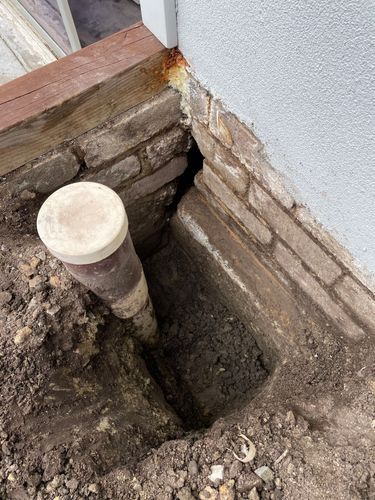

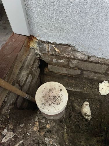

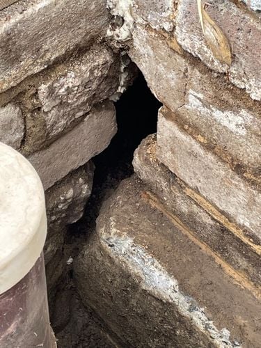

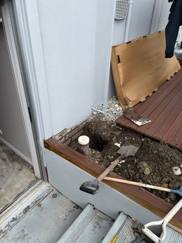

Hi - recent downpour has identified a massive water leak which upon exploration appears to be coming via the channel on top of the footing and down into a large hole where previous owners have added a brick wall/ stairs. I’ve dug down to expose the brickwork and the hole is pretty deep - it appears that some bricks have been removed to put in the wall. This lets water in during heavy rain.
ideally I’d like to plug the hole rather than pulling all of the internal wall apart which I do t think will help me get to the other side of the hole anyway.
I intend on putting in a sump pump to ensure any future deluges are suitably captured but need to fill the hole which is awkward to get into - any advice would be appreciated - see pics
