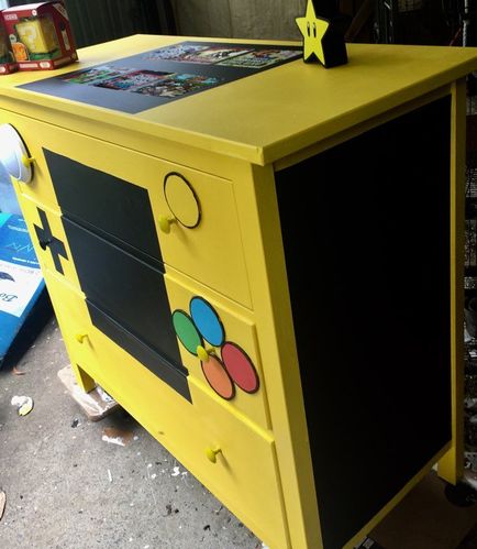

Well used drawers from MarketplaceTrusty Ozito sander, I started with 80grit and then a 120grit for a smooth finish.Trusty British Paints 'Paint and Prime'One coat. Lightly sand. Repeat.British Paints 'My Favourite Yellow' Sample pots are awesome if you're not sure of your colours.One coat.Marking out the details....and then doing it again!This old girl needed a new sheet of fibreboard on the back. The old one was pulling away from the frame and was sagging and generally just old. Ozito Jigsaw and a new skill learnt thanks to Husband! Bunnings has a huge range to choose from.Ozito Nail gun to attach new back.Measure twice cut once.Blackboard self adhesive for all the black parts. It gave a clean smart finish. I used wood glue on the back to make it extra secure.Wooden circles from the craft section, covered in coloured paper and glued on.Fiddly Bits spay paint.New handle hole needed.These lights are only $7 and come with batteries! Touch lights that have both velcro and a hole for a small screw.Fits perfectly. The little touch point glows in the dark!!Old game covers, laminated and glued to adhesiveBlackboard adhesive on the side to keep score (or to leave a note to do homework!)All finished and ready for my gamer child!

I really like your addition of the touch light so they can find the dresser easily at night or really early.
