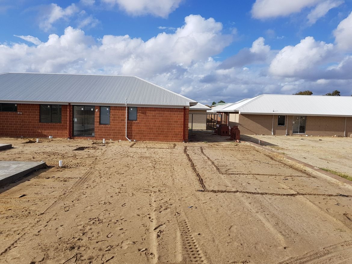

I've marked out the pool area and sunken fire pit in our first crack at the sizing and location of the two. We're keeping the main entertaining area (6.5 x 3.6m alfresco plus areas below) to one side of the yard while the rest is a general play area for the kids and includes some garden beds.
Back fence to back wall of house is 9.5m and the block width is 15m. Total pool area is 10 x 4.5m (pool is 0.5m in from back fence and 1m in from side fence) and swimming area is 7m x 3m. I need to get an engineer lined up to do my pool drawings for council approval and to certify its position on the block.

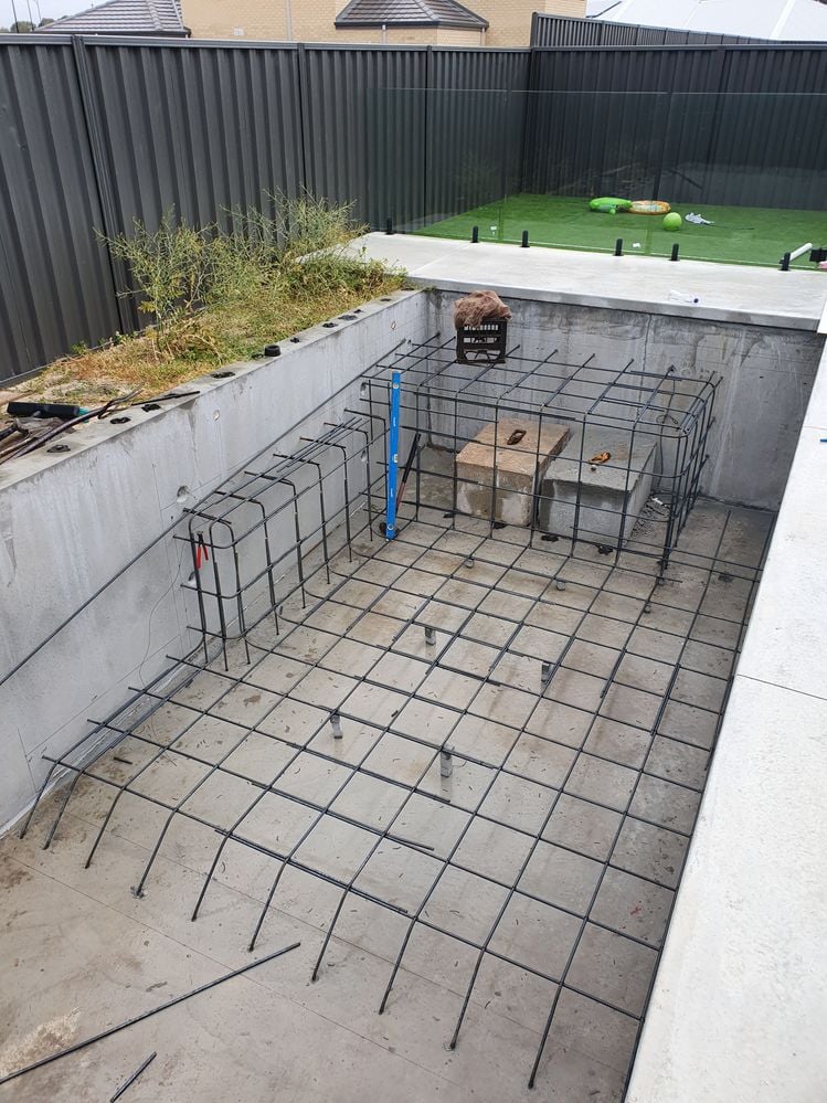

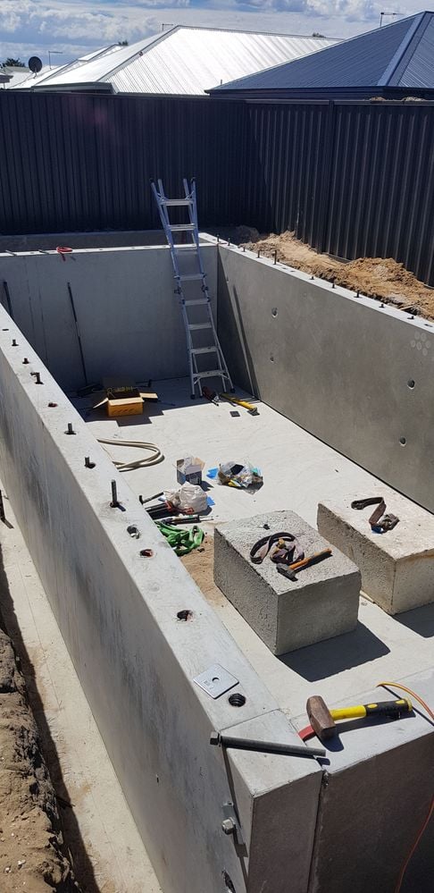

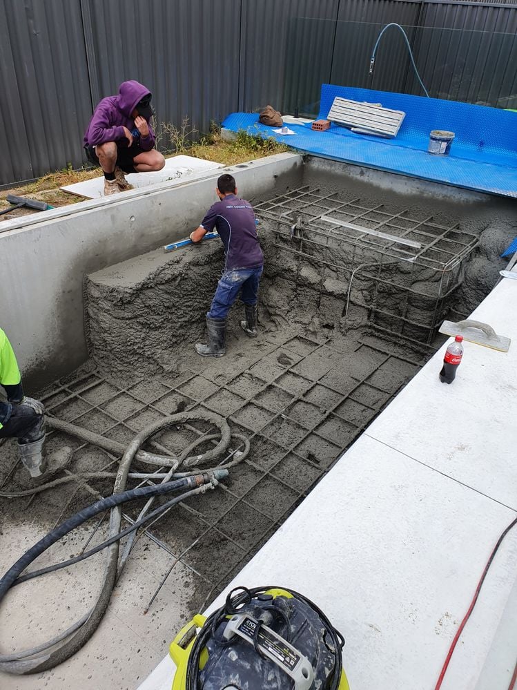

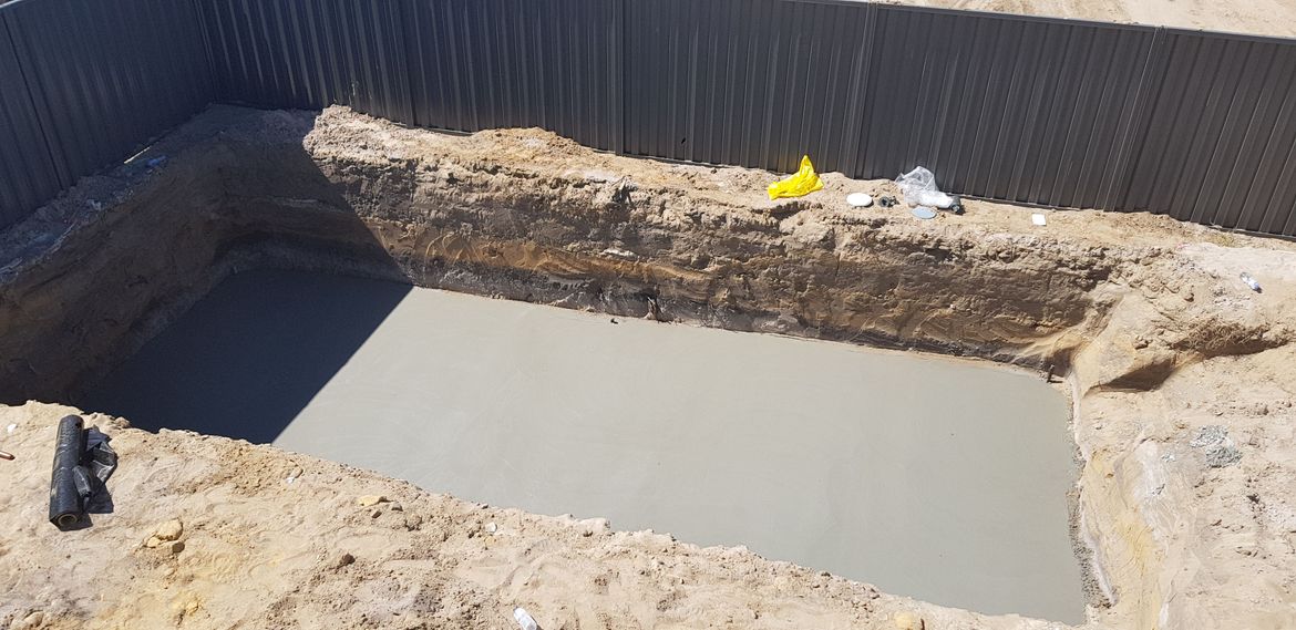

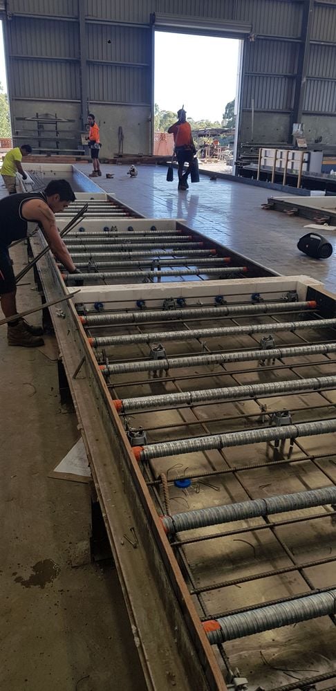

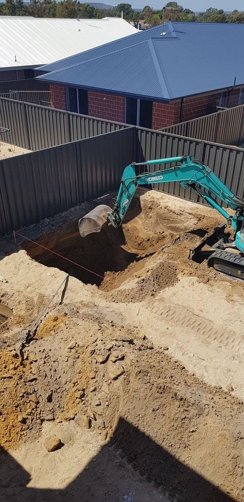

It's been a crazy week getting my chemical grout injection (CGI) done, hole dug, base formed and poured in situ and precast panels made and installed.
The pool area itself will consist of concrete and decking as we push for different textures and dimensions, keeping things as raw as possible. We're considering using Jarrah or Pacific Teak decking along two sides of the pool and for the lid of the hidden pool pump and filter enclosure. I also want to build the lid high enough that it doubles as a platform to jump in from. I will be putting some hydraulic struts in to make lifting the lid nice and easy.

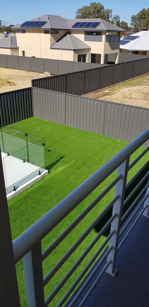

Concrete has been poured around the pool, the glass fencing is in with amazing black spigots and hardware and artificial grass surrounding the pool is in place.

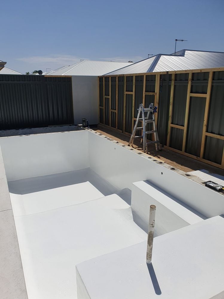

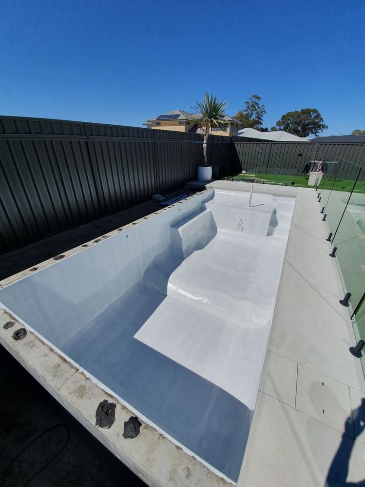

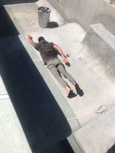

The internal layout has been completed, including stairs, a laying platform and a sitting ledge.

Torn elbow tendon and hip flexor has slowed me down of late but nearly finished the deck at the front of the house and painting the pool. Below is the first coat. I'll be doing three in total. Loving how it's turning out.
Next I'm doing a feature fence in the pool area (extended height from 1800mm to 2100mm in preparation), then decking and cacti feature garden. Looking forward to being able to kick back and enjoy all this hard work. Nearly there!
Third and final coat. Now to finish the surrounds, install equipment and underground roller, and fill her up.
