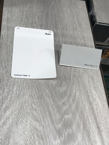

- Dulux Renovations range Milton Moon for all benchtops

- Dulux Interior paint – Lexicon Half-strength for walls

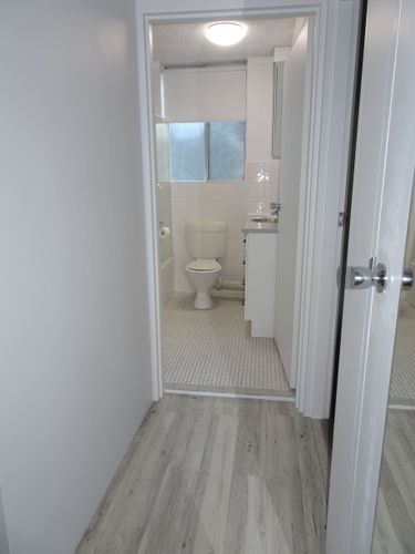

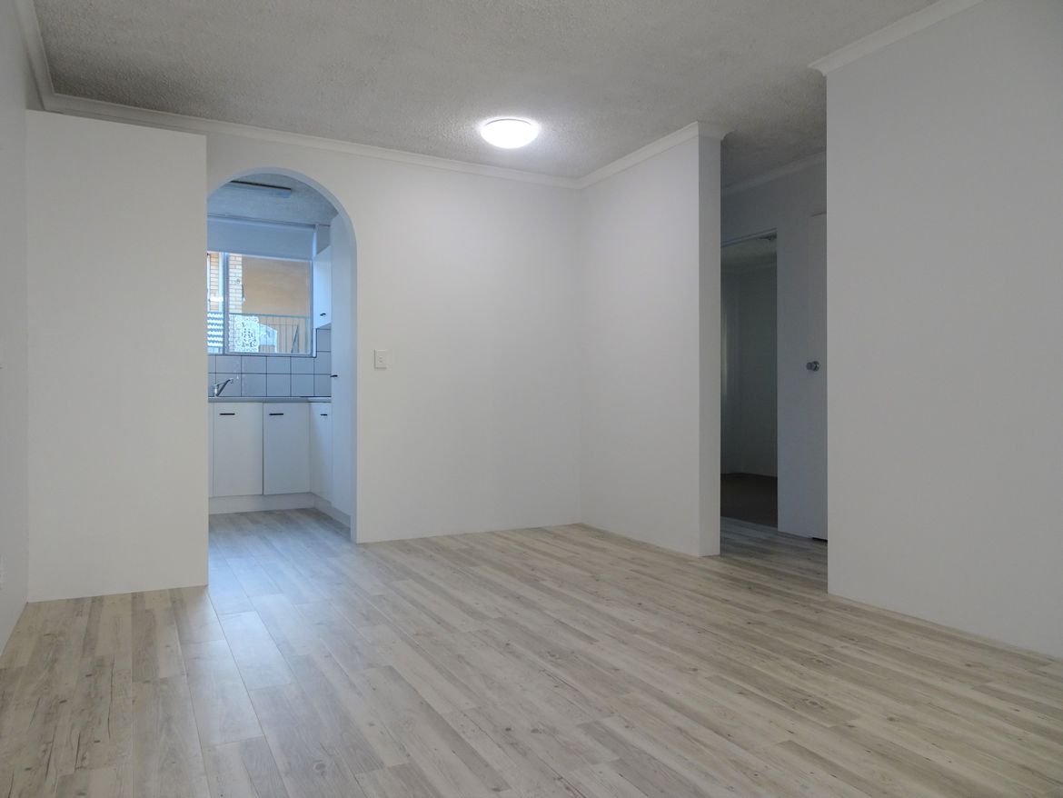

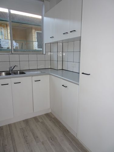

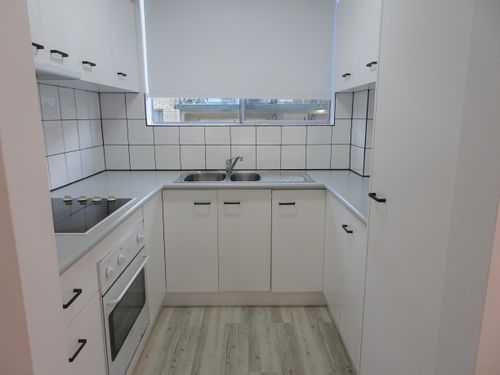

Top tip 7: for the Dulux Renovations range, follow the recommended instructions for mixing, painting and allocated times. Don’t think you can shortcut it! Make the last thing you do in your entire work schedule the two top coats of clear coats and leave it for a week! A year on, even with tenants (two young students in their first adventure out of home!), the kitchen, bathroom and floors look great. Why? Because I followed the correct installation instructions!

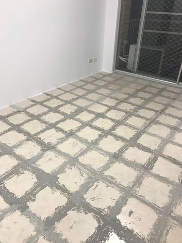

Top tip 8: for the Gerflor Senso vinyl planks, again, follow the instructions. Realise that filling the grout gaps between tiles to achieve a smooth subfloor, takes HOURS!!! It’s back-breaking work and really hard on one’s knees. However, if you want your floors to look good and remain smooth, it MUST be done. Triple the time you think you’ll take.

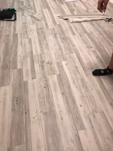

Top tip 9: for the Gerflor Senso vinyl planks, laying the planks is relatively easy; the tricky thing is the measuring of the fiddly bits for cuts around corners, etc. Factor these into your estimate…and then double it! I laid the entire floor (kitchen, living/dining and hallway) in one night but I saw the sun rise and didn’t finish until 10am.
Top tip 10: for the Gerflor Senso vinyl planks, replace your Stanley knife blade at reasonable intervals. You’ll need a few.
Top tip 11: spray your cabinets, if possible, as it gives a very professional finish. We used the idea recommended in the Dulux videos of the blocks with screws in them. My husband did the primer first on both sides of the cabinets; then he followed with two coats of the top coat on the back of the cabinets first, let them dry for a day or so, then flipped them for two top coats and two coats of clear gloss to seal them. Again, let these dry for as long as possible before you reattach the hinges.
Top tip 12: mark the doors correctly. We wrote in each of the hinge holes, then covered that with painters’ tape so it wasn’t sprayed with paint. We also wrote the corresponding numbers on tape and placed that in each cabinet and drawer. I also did a ‘mud map’ of each numbered door and drawer. This prevents wasting time on working which door goes where – the more time you muck around with each door increases the likelihood of damaging the paint before it’s cured completely.

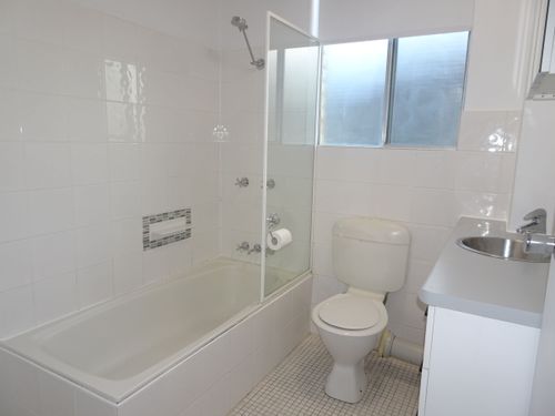

BONUS EXTRA: back yourself. You can do it! Have a go and be proud of the results. I'd never tiled before but took an outdated soap dish to a contemporary shower shelf.
