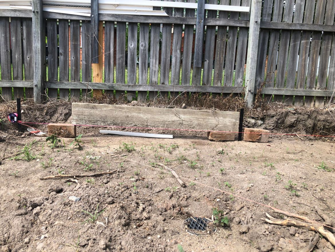

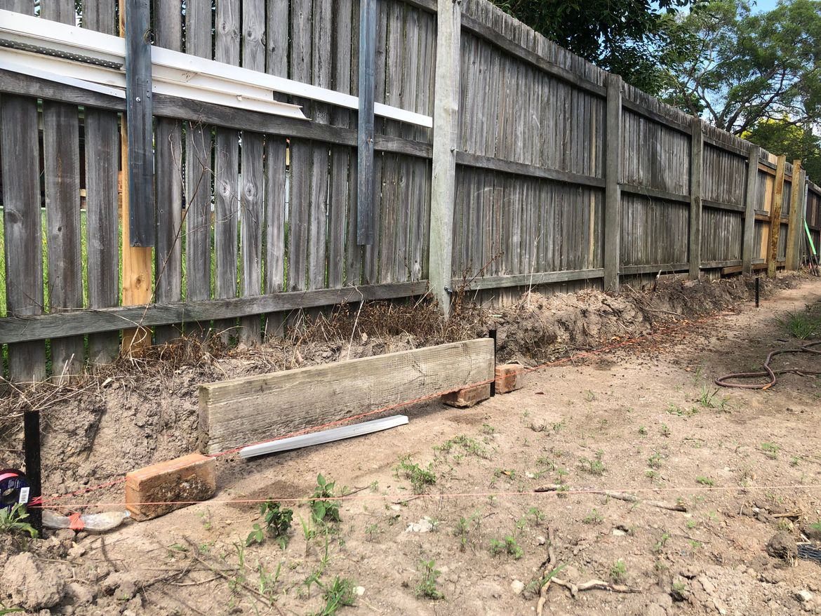

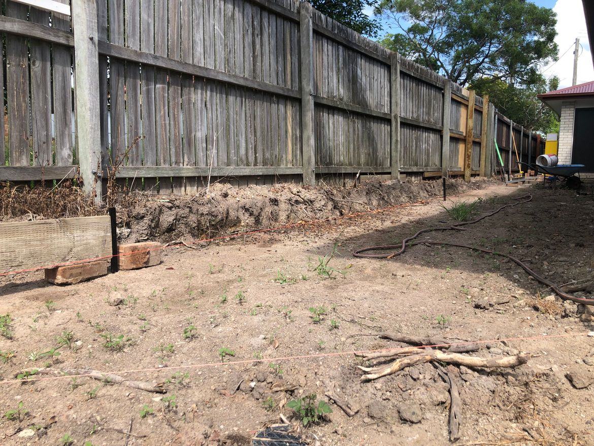

Thank you for posting the photos of your proposed garden area. Just to be clear on the location of the drain, are you asking if a drain needs to be placed under the garden bed or outside the garden bed? The only reason that you would put a drain under the garden bed is because water is not draining away. However, if placed outside, the best spot to put it in is along the area where water is most likely to puddle into. I recommend using Vinidex 100mm x 20m Socked Slotted Draincoil.

Thanks for your reply. Photos are uploaded.
The red string line is the level of the paving. The garden bed/retaining wall is 300mm in height from the red string line.
