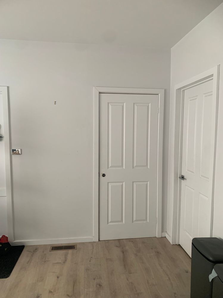

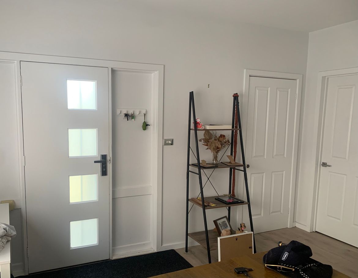

Hi I am looking to install a barn door in the space Above. Replacing the hinged door (infornt) as it currently opens outward and into the way of the bedroom door (right). I don't want to replace the hinged door to open inward and I think it would be a nice feature for the room.
I want the barn door to completely cover the doorway skirting, so i will require a door 1000mm wide. It is also 2100 from ffl to the top of the skirting. so i am looking to use a door 2100mm tall but i have noticed that quite a lot of the barn doors for sale are 2150

The door will need to travel 1900mm as to stop before the light switch to the left and this will leave the door finishing flush with the internal of the doorway. this will only leave me with 100mm spare/ 50mm on each end of the track to mount the stoppers? will this be enough to fix the stoppers to the track? Or do i need the 3000mm track?
