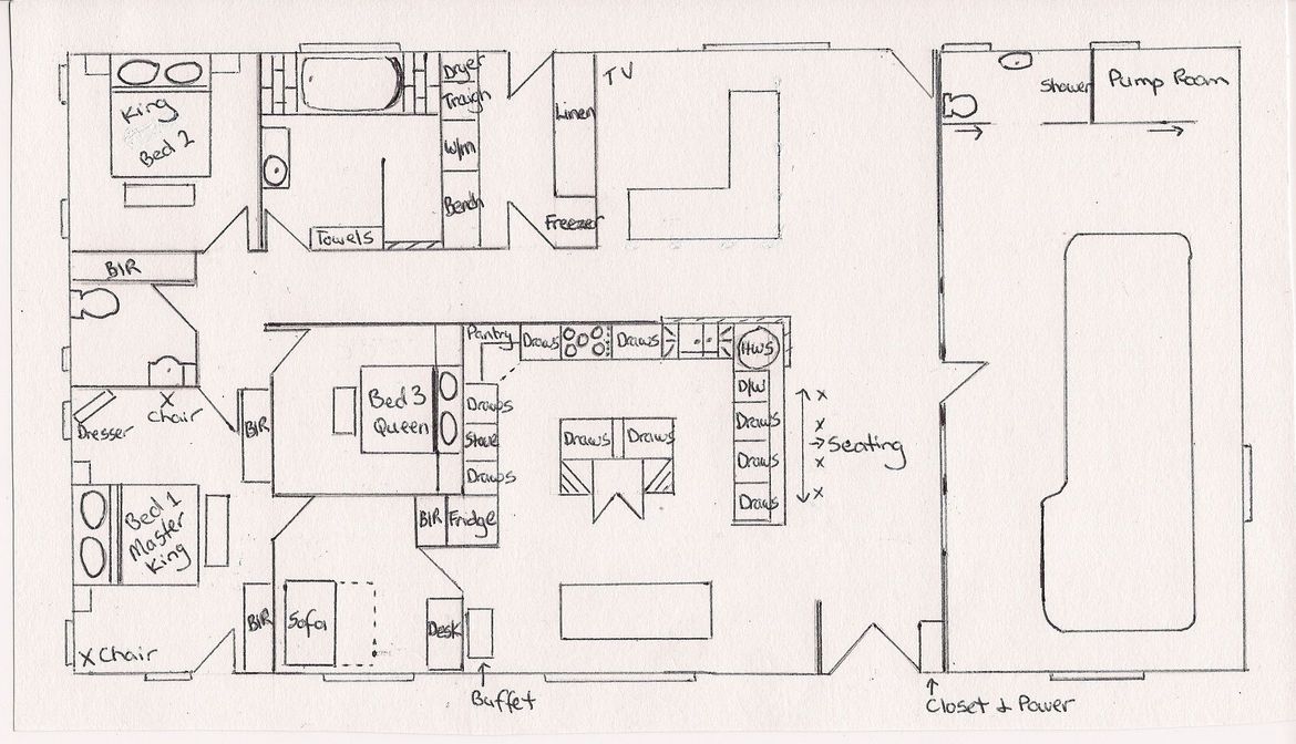

The home we are building is about 45km west of Geelong in Victoria. It is approximately 30 squares including an indoor pool. I drew up the plans to scale and then sent them off to be professionally drawn up by an architect.

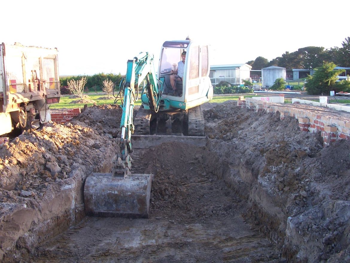

First the pool hole had to be dug well before much else could be done with construction.

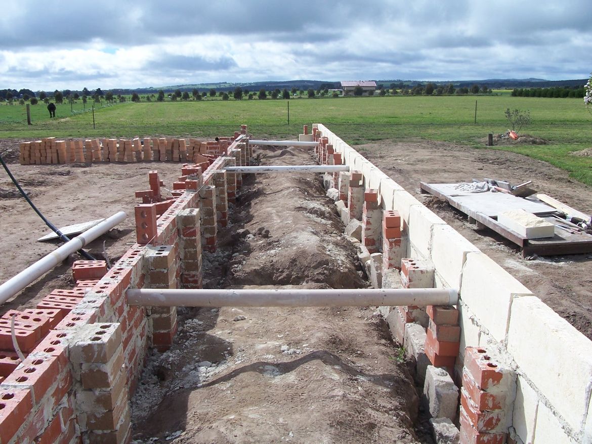

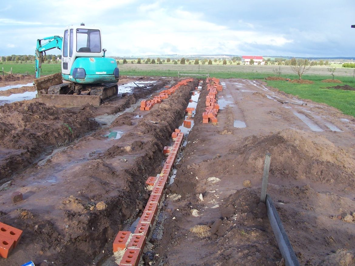

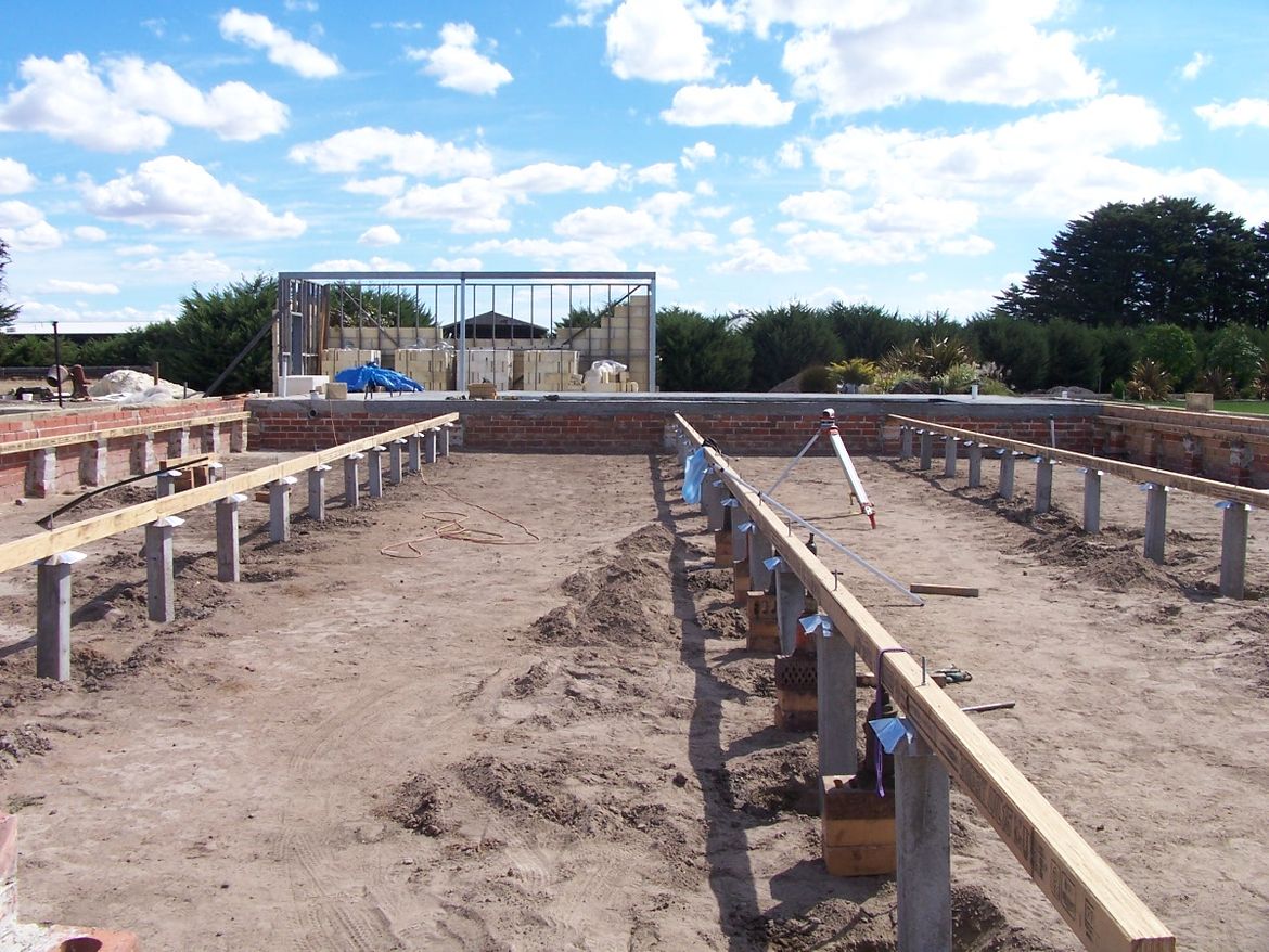

These standard clay bricks were used to build up the foundations to the required height for both the house and verandah.

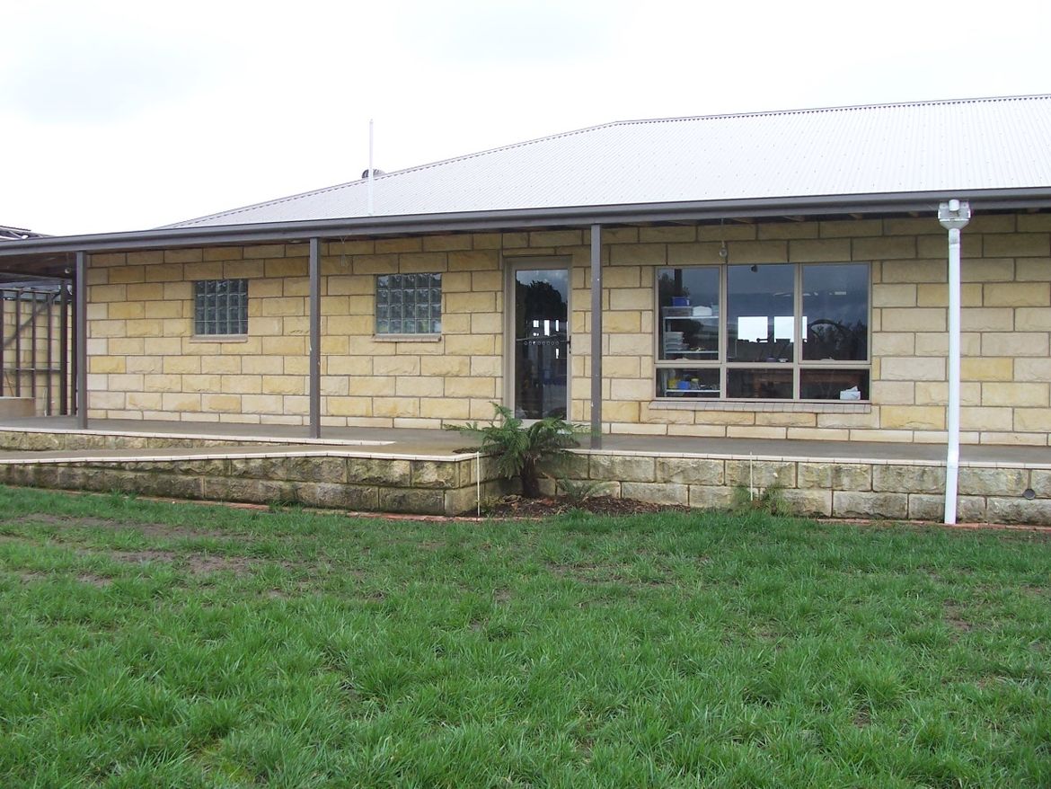

We used Mt Gambier limestone blocks for cladding.
We decided early on that we would not have timber verandahs for maintenance reasons. We used 90mm poly pipe at 5m intervals for ventilation under the home.
We used LVL bearers that were 6m long and 12.5m long.

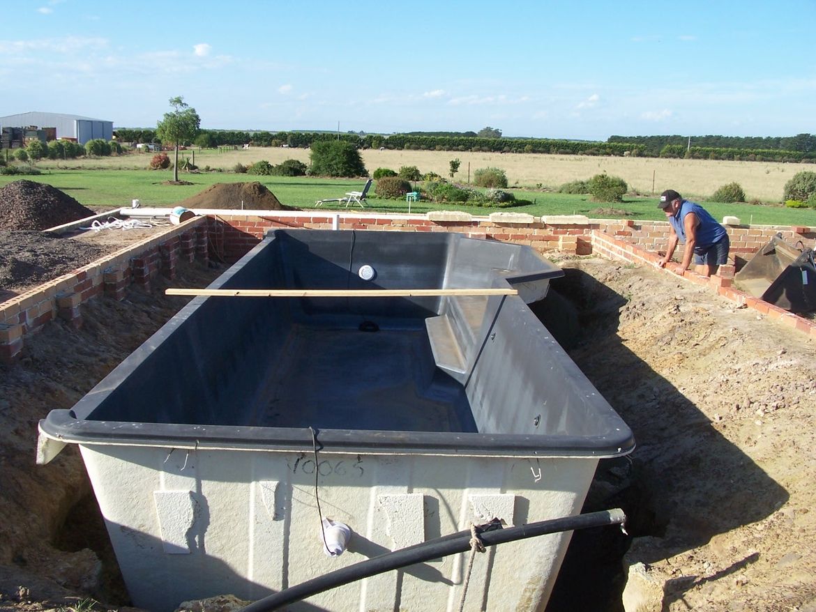

Pool placement.

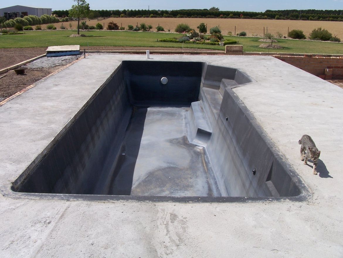

Completed pool prior to framing with my site manager Pipi checking the process as usual.

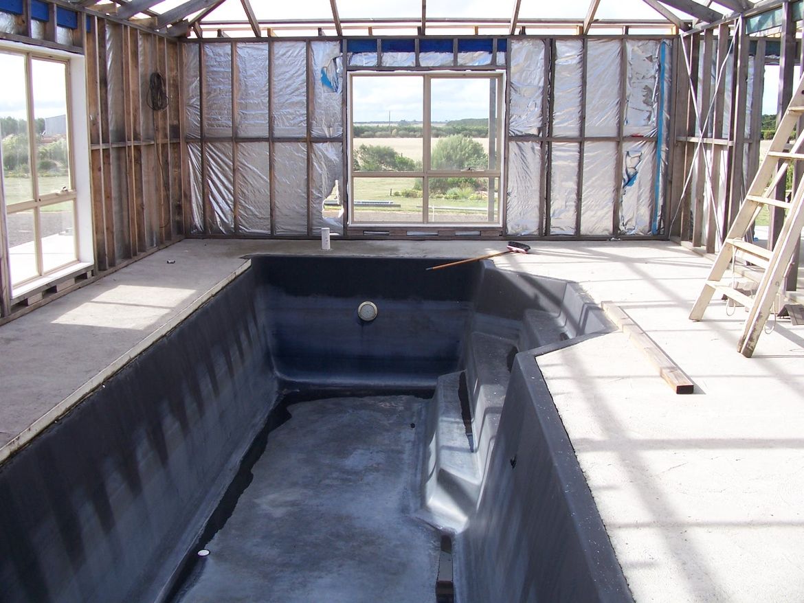

Pool with framing going up.

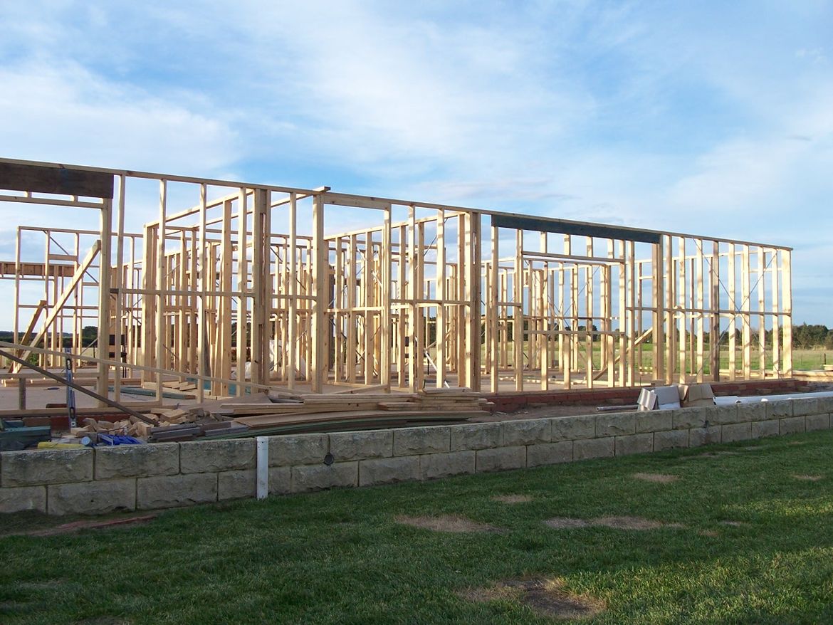

Framing in full swing.

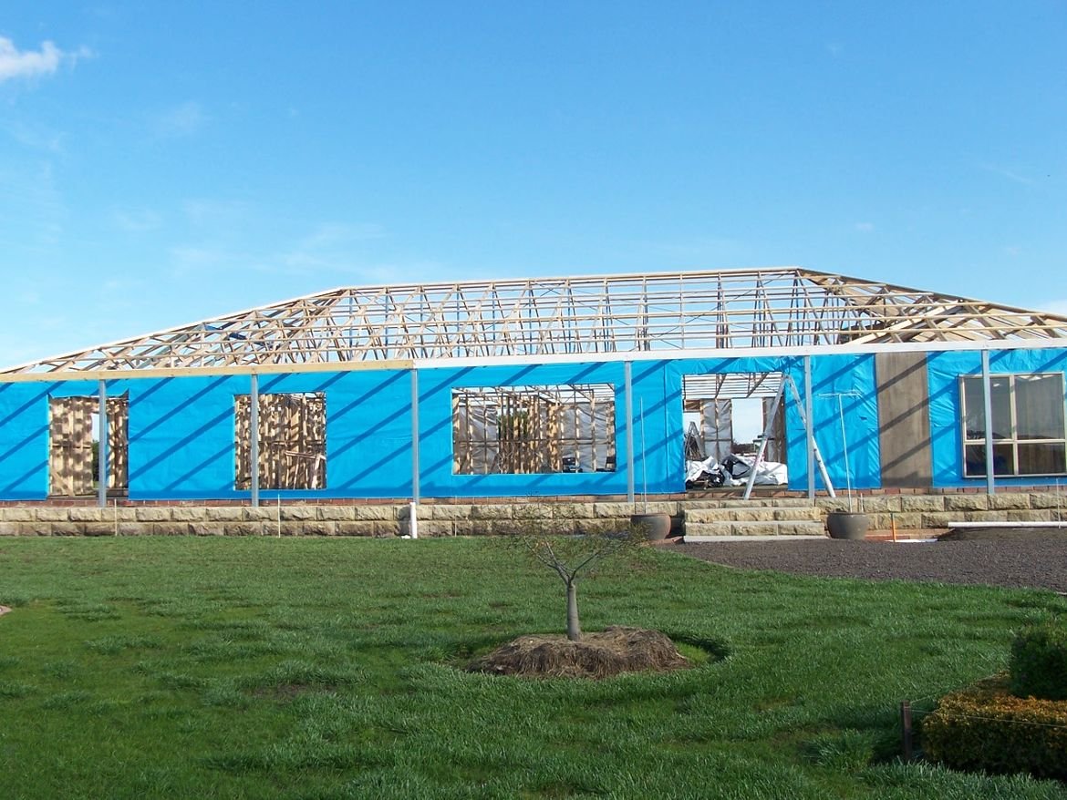

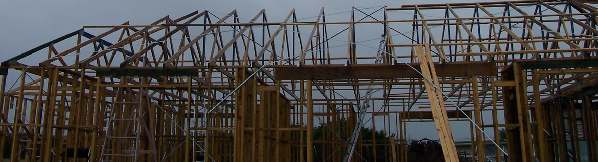

Then came the trusses, which was the most challenging part of the project so far.
The trusses were 12.5m wide with about 10cm overhang on the top plates. To pick the trusses up, we fastened two 8 inch x 2 inch timbers in the main triangle section of the trusses so as not to compromise the Gang-Nails. We then lifted them up with the trusty front-end loader and sat the truss on the east end of the house. Then we fastened a rope at either end of the trusses and dragged it from the east to west, some 17m, lifting or jumping it over the odd Gang-Nail until it was right up the west end and ready to stand up.
We used a long board to start to lift the truss and took up the slack with two ropes fastened at the centre or top of the truss, one rope pulling east and the other west. Slowly and painstakingly, we loosened one rope and tightened the other rope and mostly we succeeded with each truss. The odd one slipped off the top plate and we had to lower the truss, lift it back up onto the top plate by hand and start the lift again. To get the truss back up on the top plate, we had to completely skew the truss, even though we only had to gain that small amount of 10cm.
Fourteen trusses later and we had them up. Then there were the smaller hip trusses but they seemed rather easy compared to the main trusses.

The brickwork on the south side is almost finished with only 80 blocks away from completion. Five windows on the east side of the home means lots of cutting. It's easy with a 9" grinder but very dusty. Limestone is great to work with as we're able to fashion it easily.

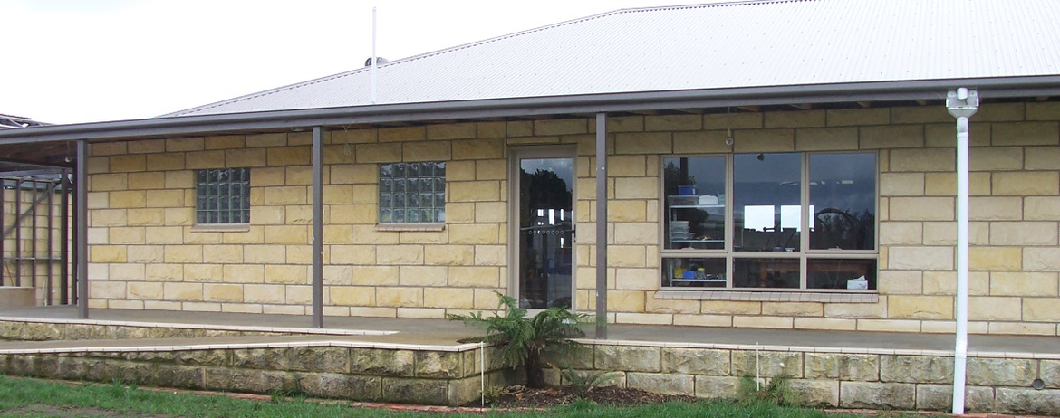

South side of the home showing the glass brick windows in the indoor pool room, back door, lounge window and the access ramp. We've been mindful during the build to make provision for such access both into the home with minimal height door sills, and also through interior features such as a step-less shower, accessible toilet and 870mm doorways.
It's taken nine years to get to this stage doing all the construction ourselves so we're very proud.

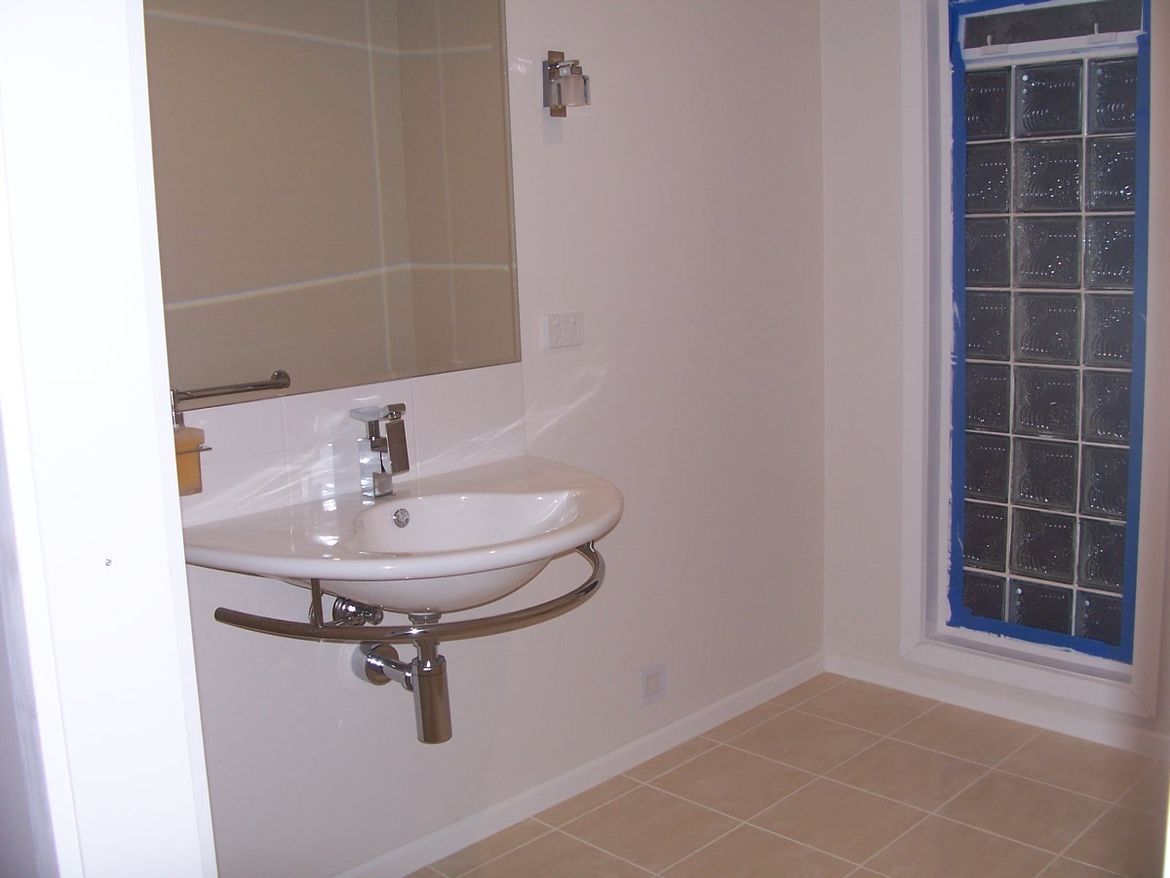

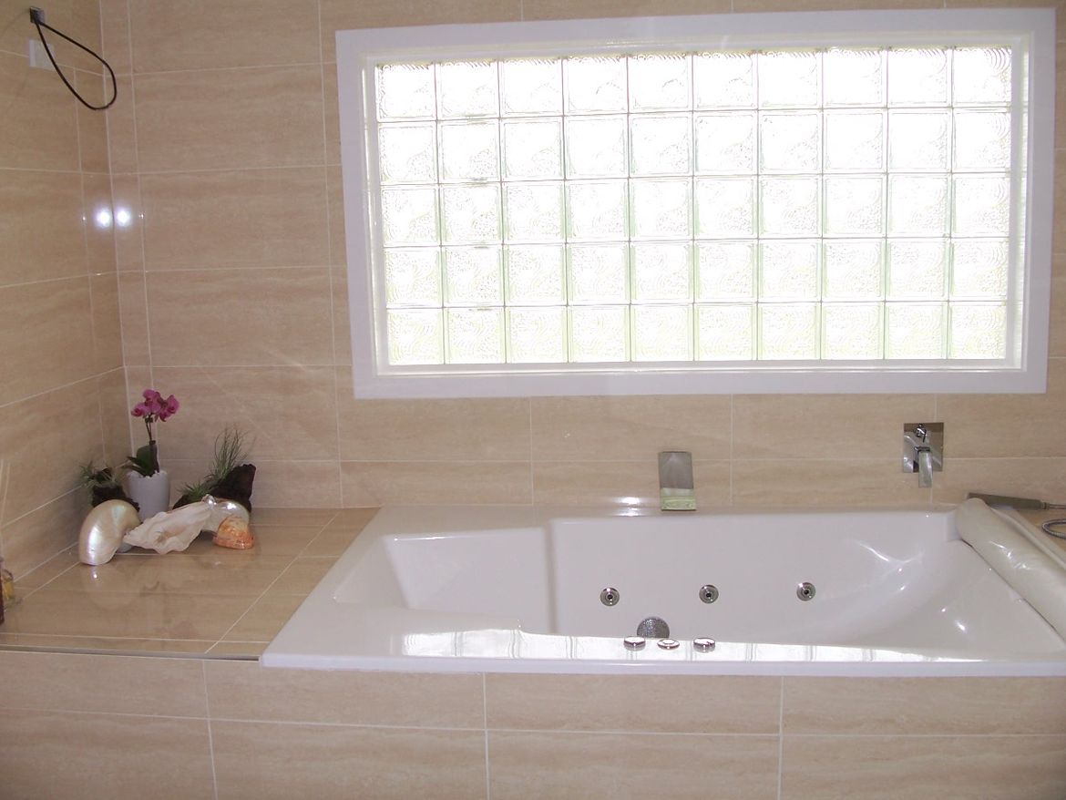

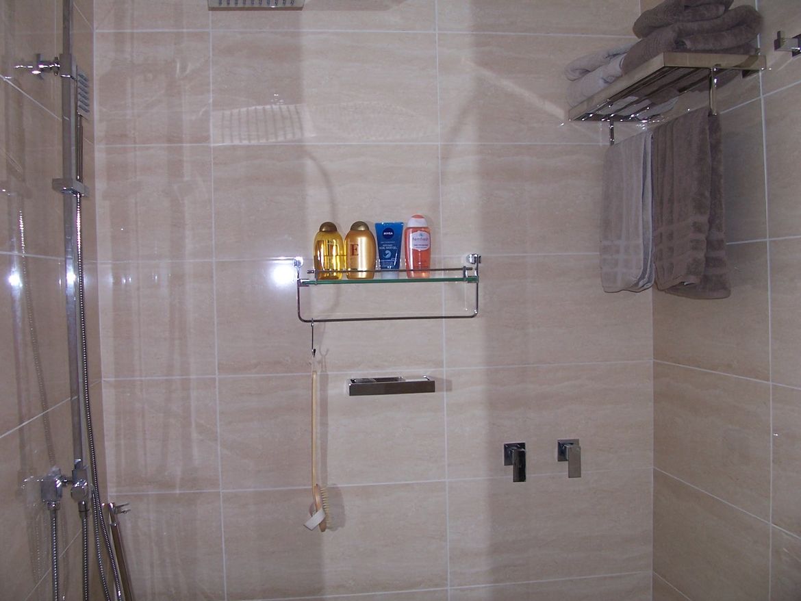

We just completed the main bathroom. Huge job using 600 x 300 wall tiles and making sure we matched the grout lines with 300 x 300 floor tiles. Very tricky but we got it. Still have to finish grouting.

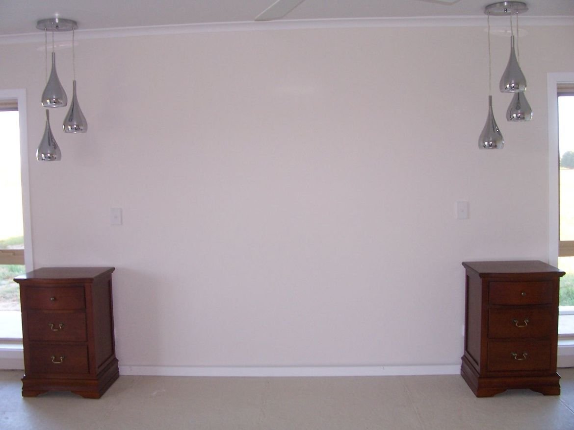

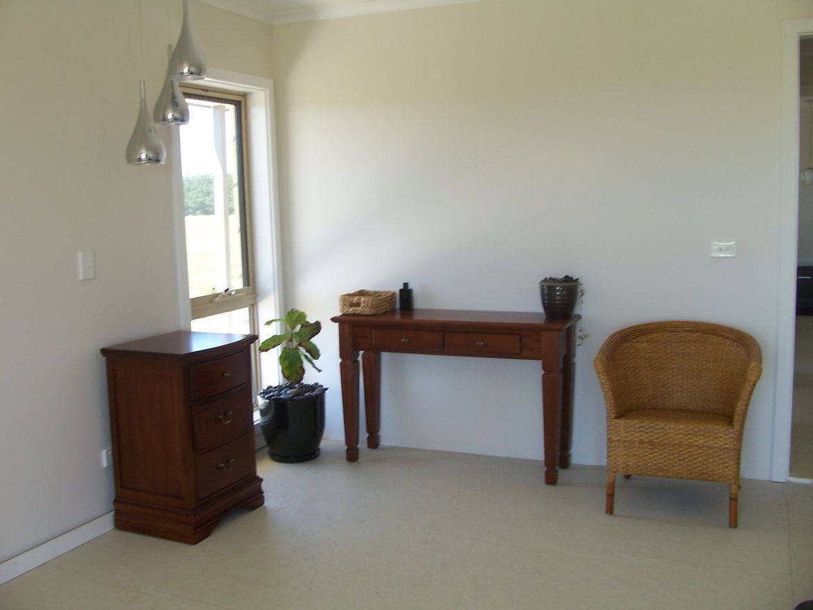

The house is almost finished with two bedrooms decked out. No carpet yet so we've got painted flooring for now but it looks and feels cosy.
Master bed has some furniture but we are still living in the cottage until we get the skirting boards up and painted.
Second bedroom.
Third bedroom.
Main bathroom is complete including TV cable.
The ensuite as I call it (it's a small bathroom in our indoor pool room) is complete.

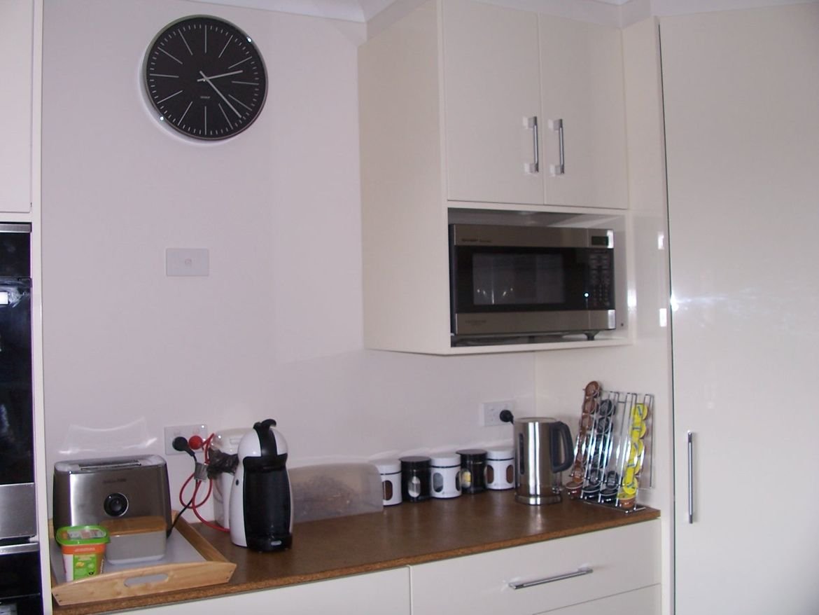

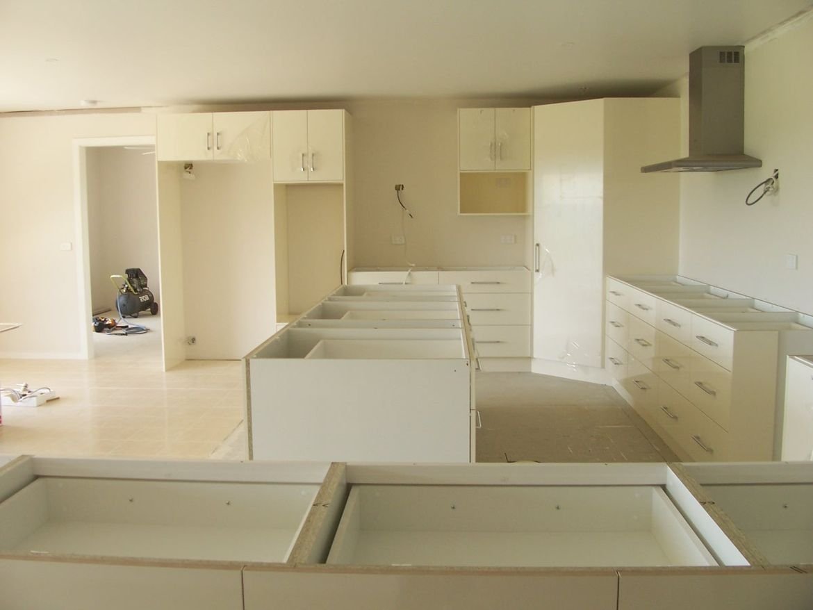

Kitchen is in. We'll wait until next year for the benchtops. We used varnished green tongue flooring for now. Ovens are in situ and just need connecting. Hot plates should be ready to pick up tomorrow. We've got some safety switches to do once the ovens and hot plates are connected as well as finishing the cornice and painting the bulkheads.
March 2018
We've now moved in. The kitchen is useable with polyurethane flooring as makeshift benches for now. We'll soon cover it with stainless steel. Stone benchtops to come in a few years at a further $7000 cost, so the stainless steel will see us through until then.

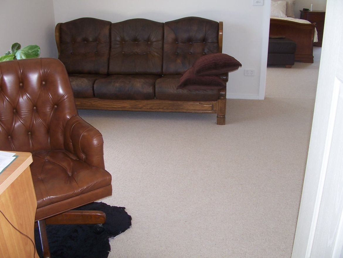

Completed office with lovely pure wool carpet.

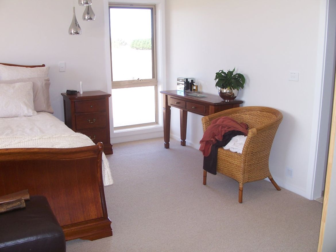

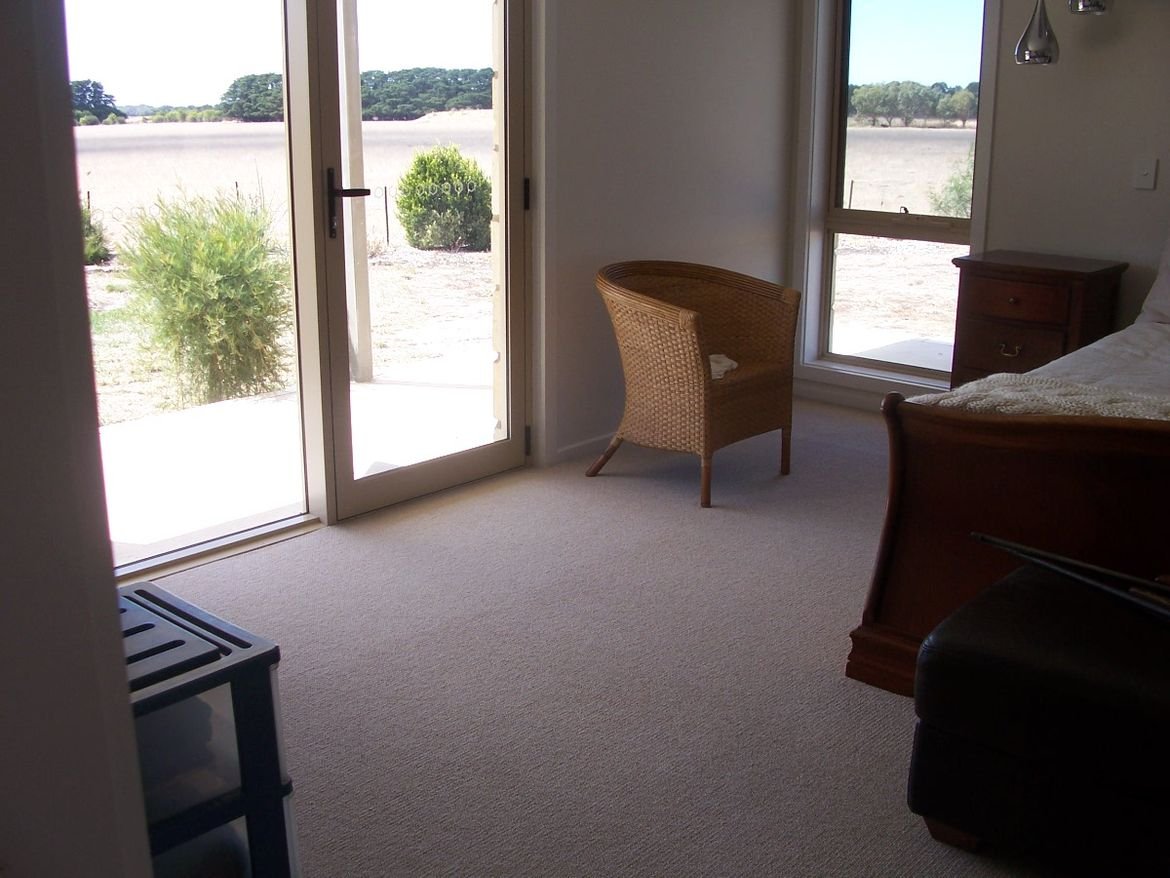

Master bedroom complete with carpet.
Master bathroom complete with TV to watch a show and relax in the spa.

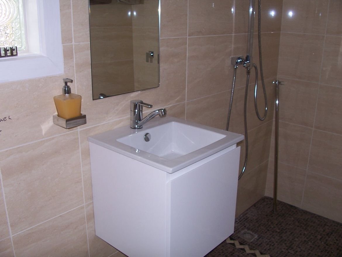

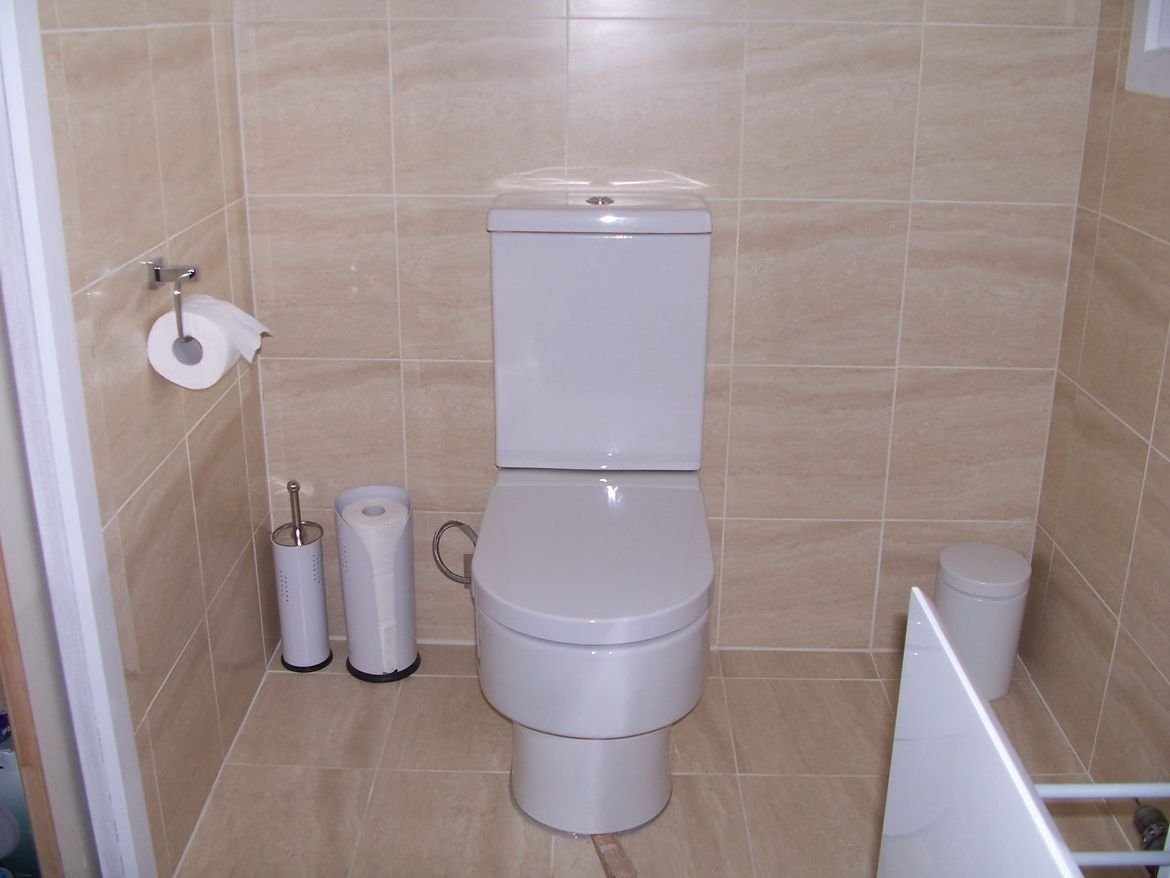

Accessible toilet complete with hand basin and hand rail.

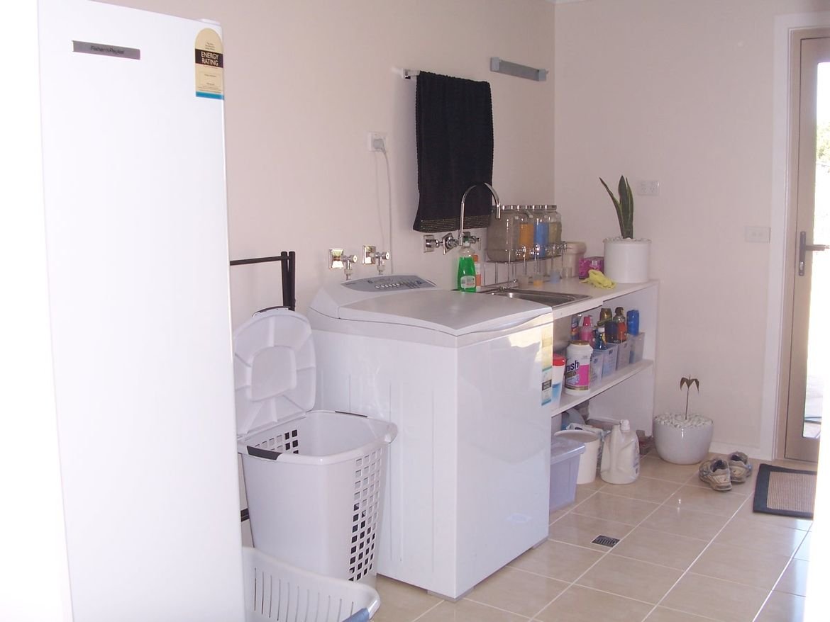

Laundry with makeshift bench once again using the trusty green tongue flooring. The water-resistant laundry cabinetry alone is over $5000. Dryer yet to be hung on the wall to the right of the towel rail.

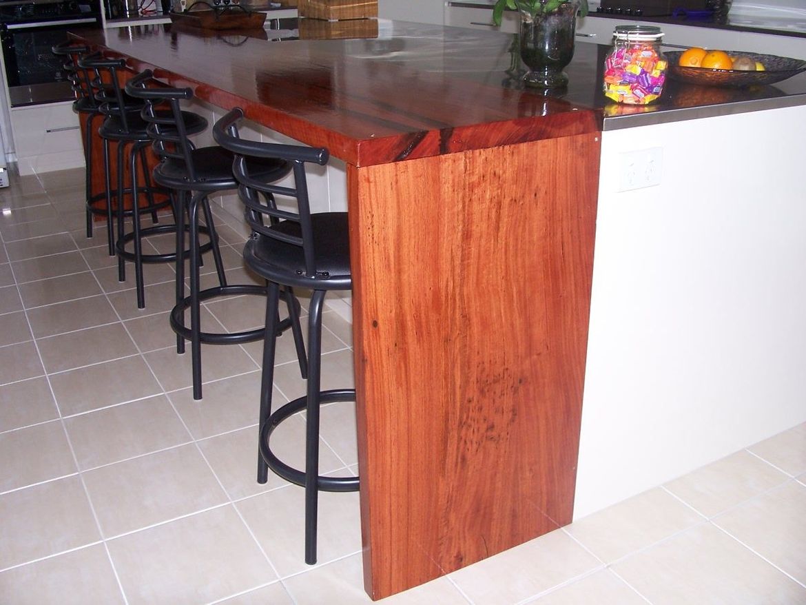

Refurbished Red Gum table with liquid glass top.
Completed laundry with stainless steel benches and splashback.
Our Red Gum island extension.
If I were to change anything about this project it would be the spacing in the office. As a result of the decision to put a doorway where I put it to make the kitchen layout work, I restricted the size of desk I can have in my office. I can't go beyond 140cm and I had no idea how hard it would be to find a desk with the features that I want that is only that wide.
This is my office and on the other side of the built-in robe is our fridge. This combination worked perfectly but not so much for a desk on the other side of the door.
I had also taken 300mm from the adjacent room to accomodate a doorway into the master that wasn't there before. You might say I could put the desk on the wall where the sofa bed is, but I put six power points on the wall specifically for the desk and all that's needed to run a business such as a printer, computer tower, desk lamp, monitor, shredder and heater.
During the frame stage I decided to widen the doorways and take them from 720mm to 770mm. I wanted to make sure a wheelchair could fit through and it did't seem to be a big project, so I did that myself.
