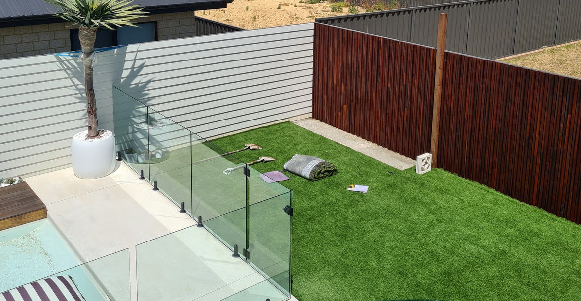

My wife set me the challenge of building a cabana by our pool area to turn a wasted area into a relaxing space.

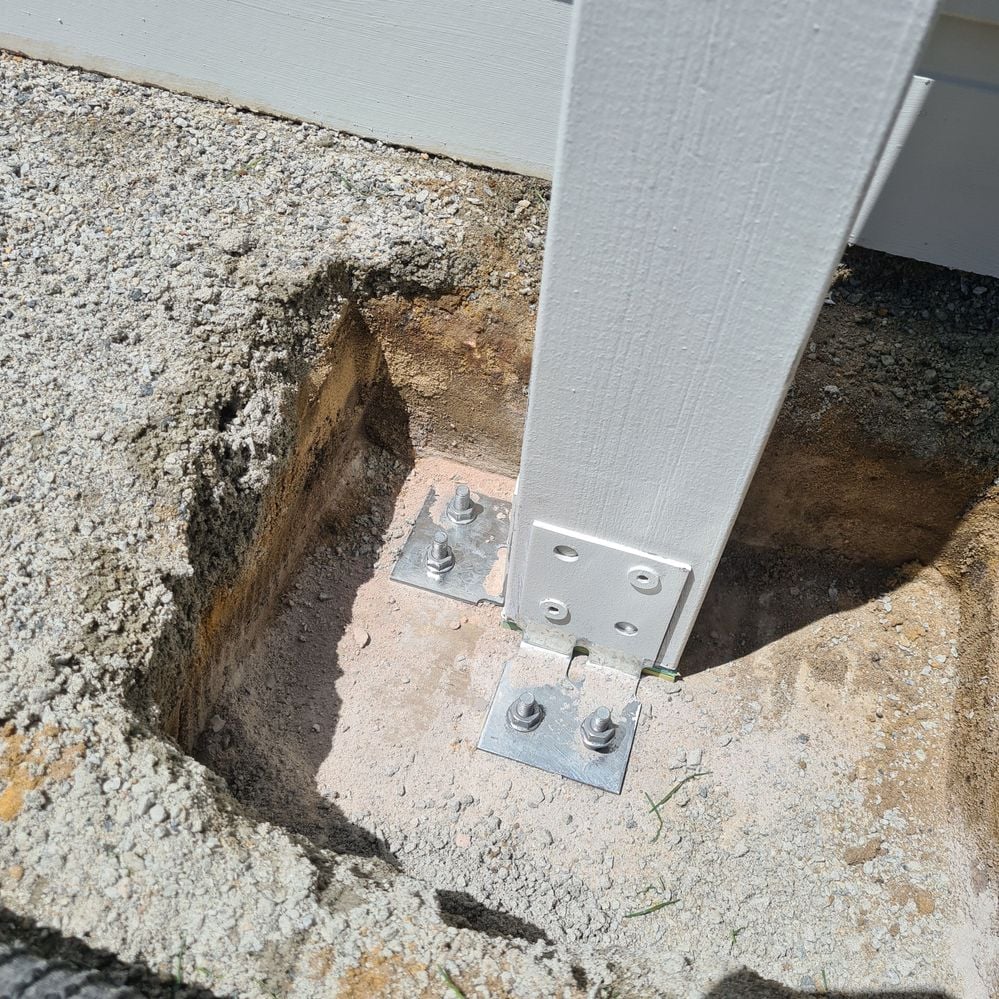

Double rebate join on all posts. Gives a professional finish up top and allows the fixings to be more easily hidden.
I concreted in and secured two posts on the rear boundary to a limestone retaining wall using DynaBolts, while the other two posts were concreted 600mm into the ground.

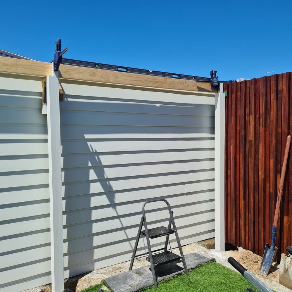

While confirming that all levels were bang on, I also checked how much we want the pointed ends to overhang.

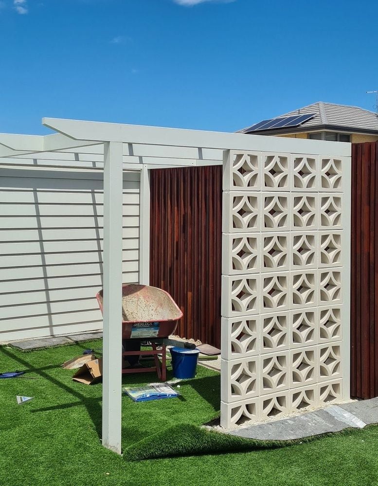

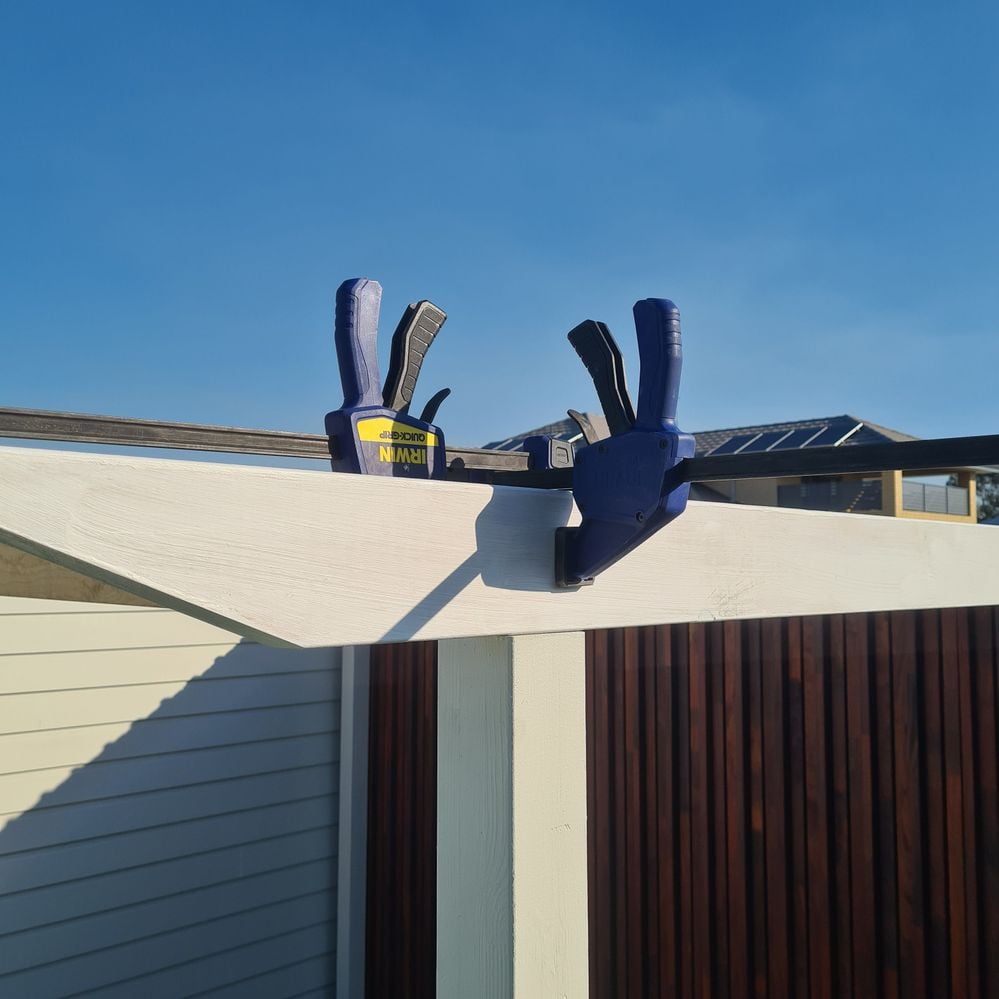

I clamped the roof to the post to give the finishing height of the Breeze Blocks. I was then able to work back from there to set the footing and make sure we used full blocks right through. There's a 10mm rod through each row of mortar that is set into the timber post for plenty of strength. These Breeze Blocks are made with 20mm channels on two perpendicular sides to make the rod easier to embed.
With the Breeze Blocks in, I finished the rest of the timber frame and fixed with bugle batten screws. I notched out parts of the frame to flush-fit the cross members. They support the bamboo roof and also add a nice feature. This was made easier with a multi-tool to make the initial cut (after a few taps with the chisel to give the multi-tool a crevice to start in and follow) and then fine finished with the chisel.

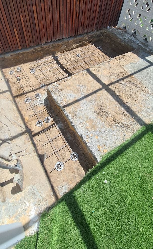

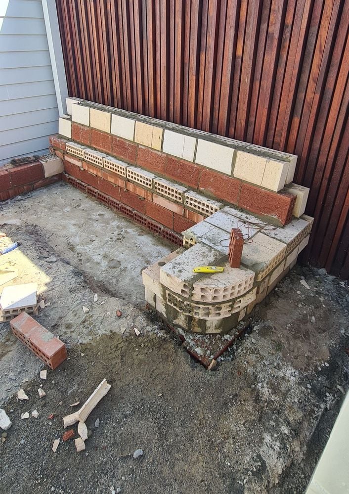

Next, I dug the footing, installed a bit of reo, and poured concrete ready to start building a curved concrete bench seat.
I was going to build the concrete bench seat myself as I have the skills to do so, but after seeing a design by a local professional I decided to enlist his help. Given he did such an awesome job on the bench seat, I got him to quote the crazy pavers too. Again, I could've done the crazy pavers myself but his price was so good that weighing it up against the time and effort it would take me to do it, it just wasn't worth it.

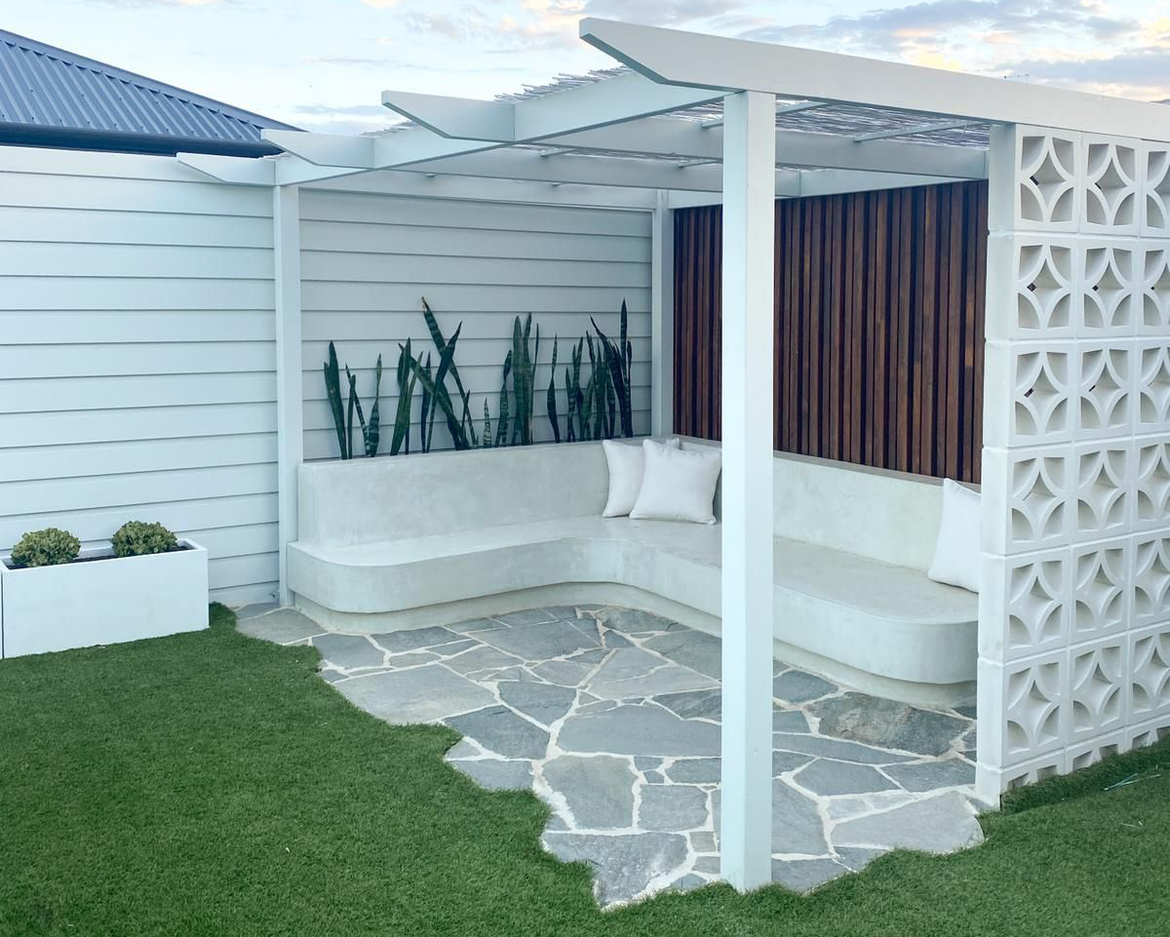

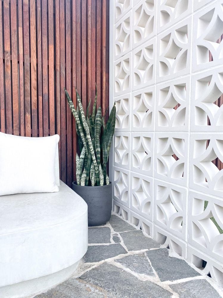

With all that work done, it came down to the finishing touches such as sealing the bench seat and crazy pavers, cutting the artificial grass to fit around the natural edges of the pavers and popping some greenery in there.

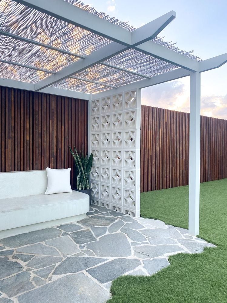

That bench seat! Curves in all the right places, tapered back rest and polished concrete-effect finish.
Super stoked with how it all turned out and got it done just in time to enjoy all the festivities that've followed throughout this beautiful Perth summer.
