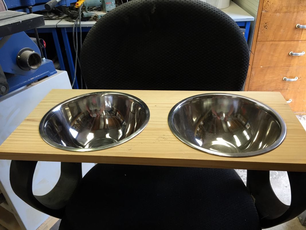

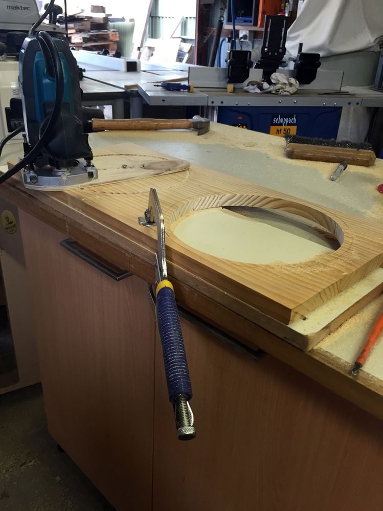

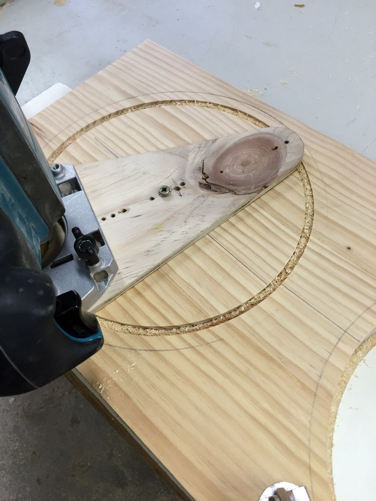

Then using a home-made circle cutting jig attached to the base of the router, I cut out the holes that the bowls would eventually sit in. I traced the outer circle with a pencil and then measured the rim of the bowl to calculate the cut-out size.

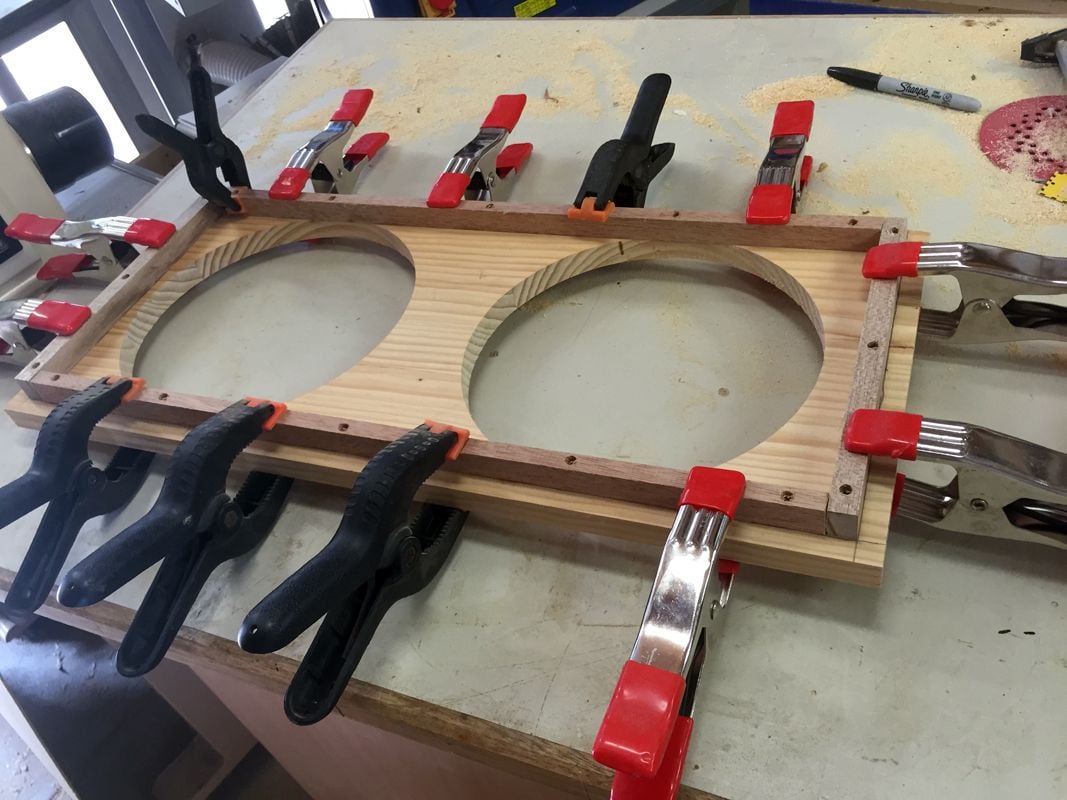

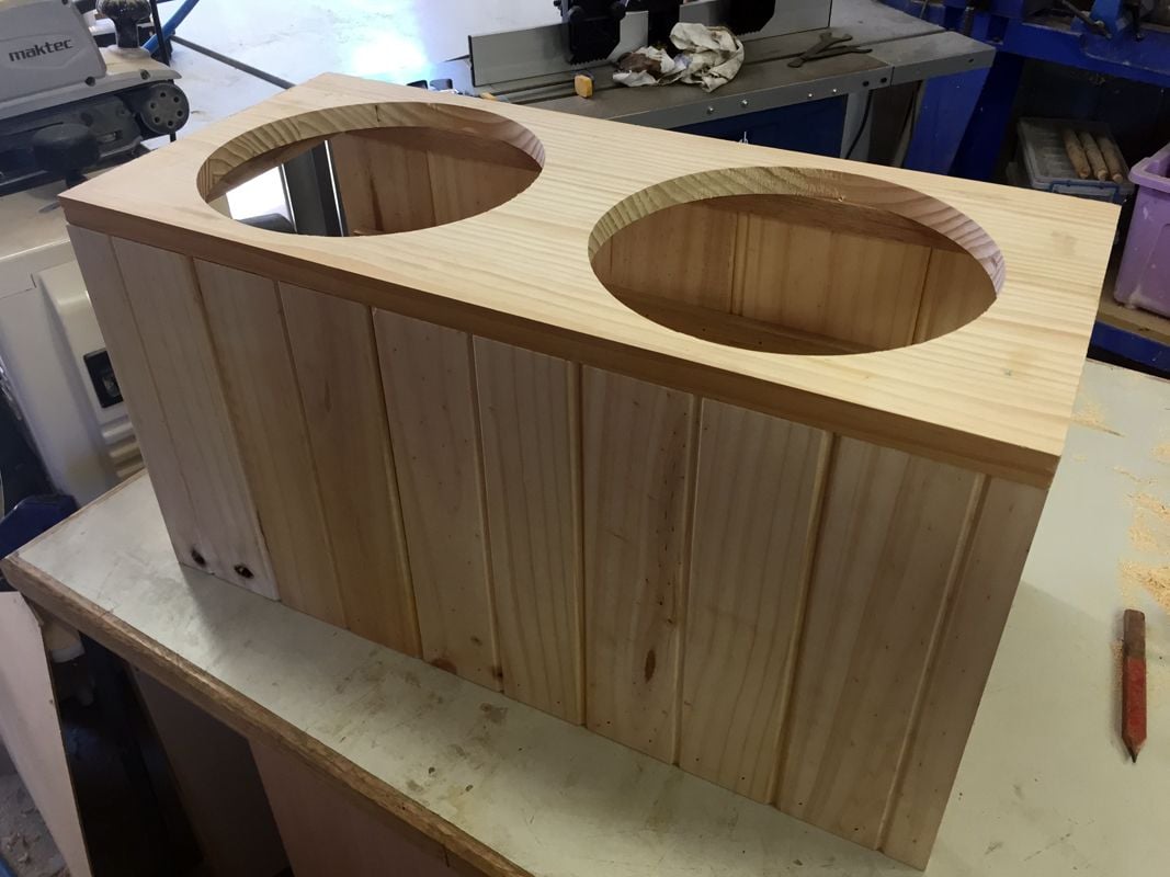

I screwed and glued a framework under the top so I could secure Match Pine panelling to the body of the unit.
I made the sides and ends with bracing and base panels to lock it all together and add strength.

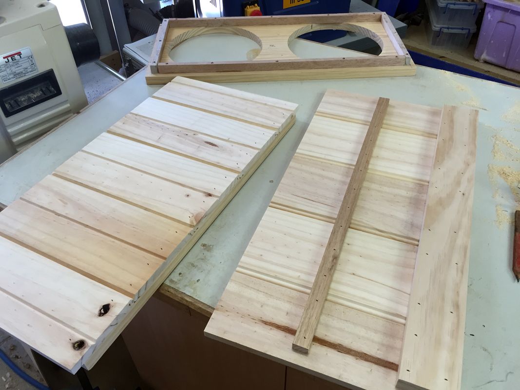

A test fit of the front and back together with the top. Taking the final measurements for the ends.

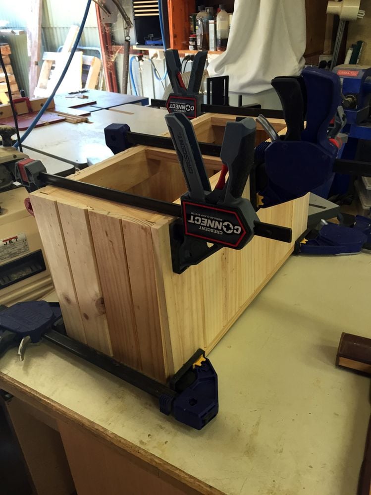

Then glueing, brad nailing and clamping it all together. No mitred joints ends just butting up against the sides.

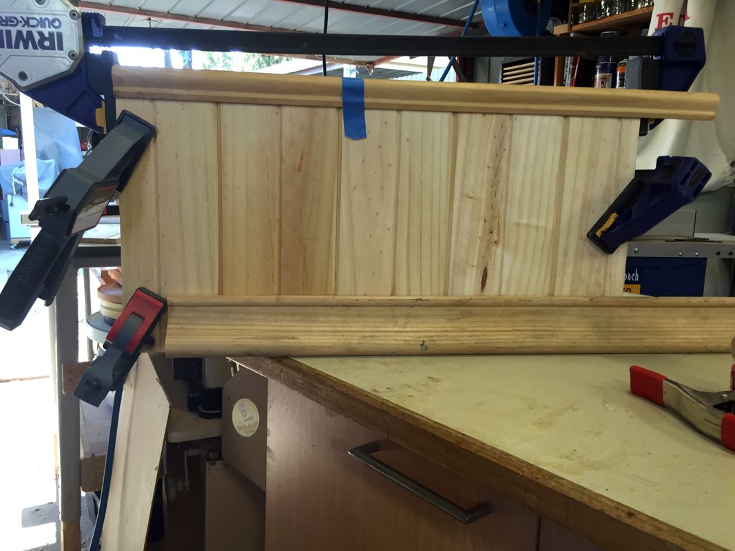

I had a range of moulding I had sourced from a woodwork shop closure and experimented to find which I thought looked best.

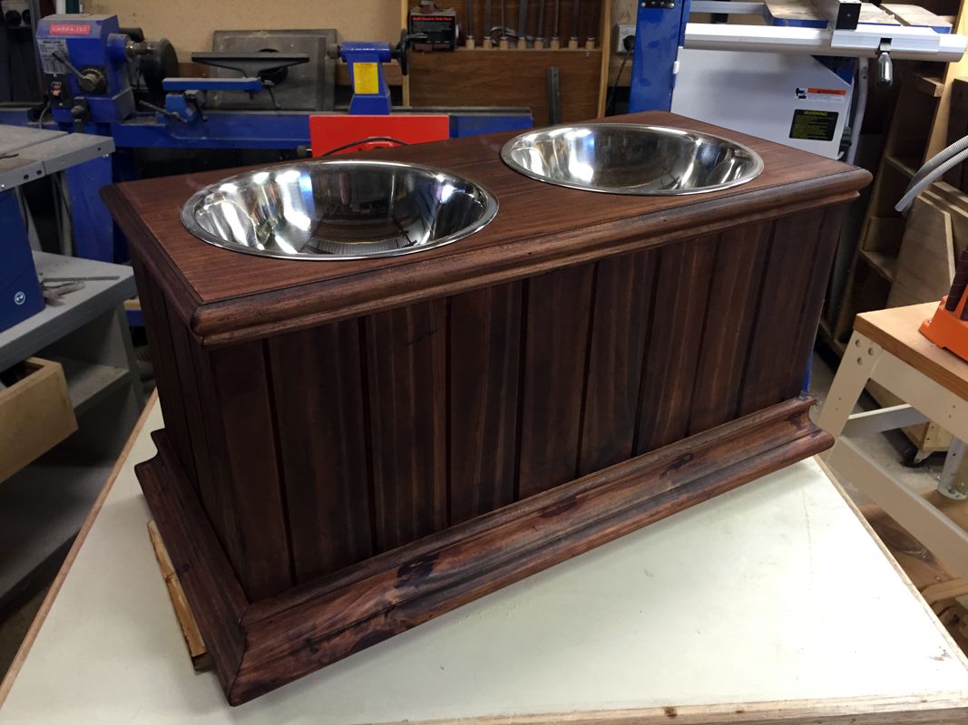

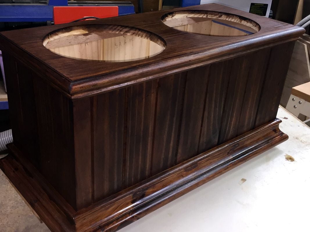

I rubbed in Mahogany stain and then cut the moulding with mitred ends.

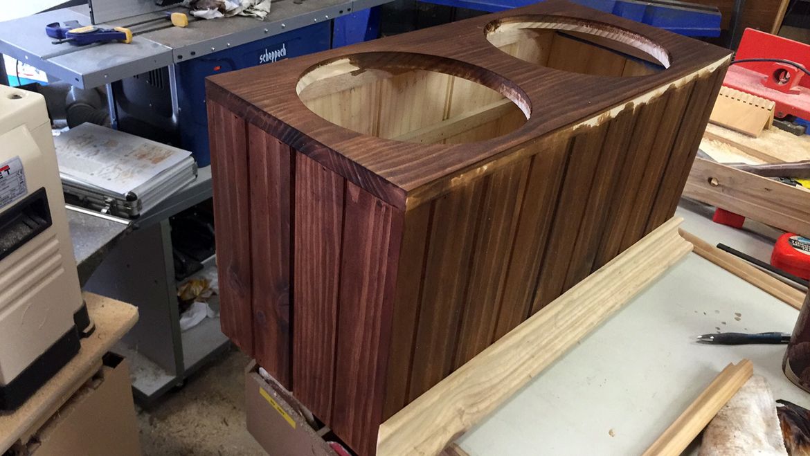

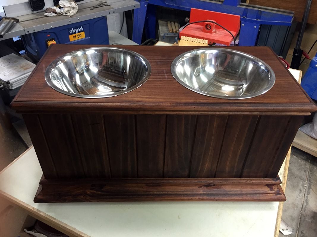

Mouldings attached and stained. I botched up the filling and sanding of the nail holes in the mouldings and this reacted badly to the stain, but went ahead anyway. Having a peak of how it will look with the bowls inserted.

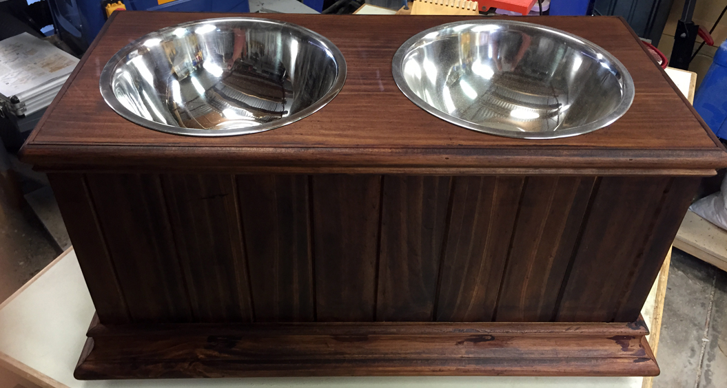

First coat of Minwax Wipe-On Poly after rubbing back with 0000 steel wool. I applied three coats for a great finish.

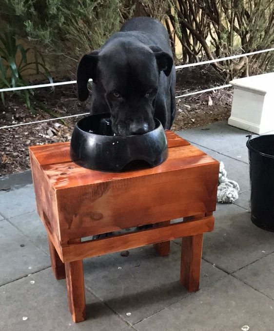

Workshop member kbcreations created this timber stand to raise the bowl for their large dog.
