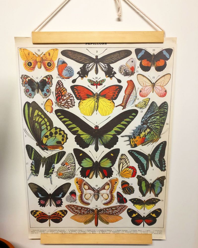

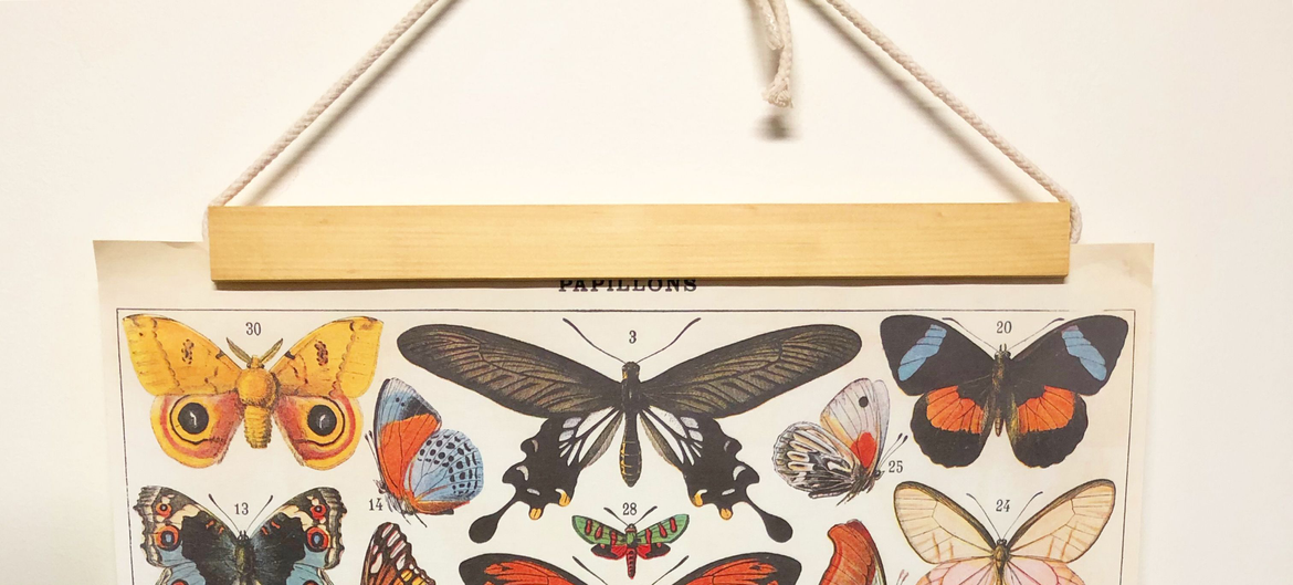

I found some cool old prints that I wanted to frame and thought I'd give it a go myself. It was easy, inexpensive and all materials were sourced from Bunnings.

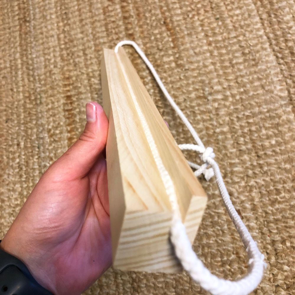

First profile attempted. Next time I'd probably make it a bit thinner to sit closer to the wall.

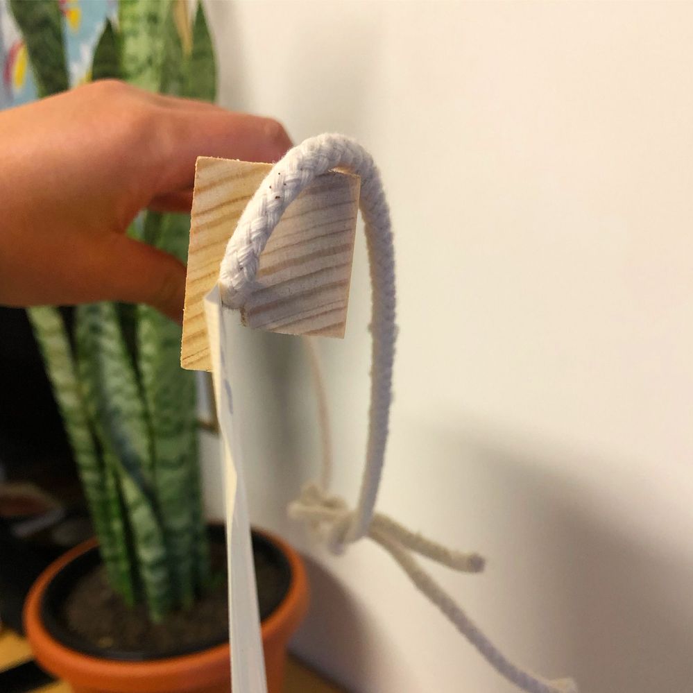

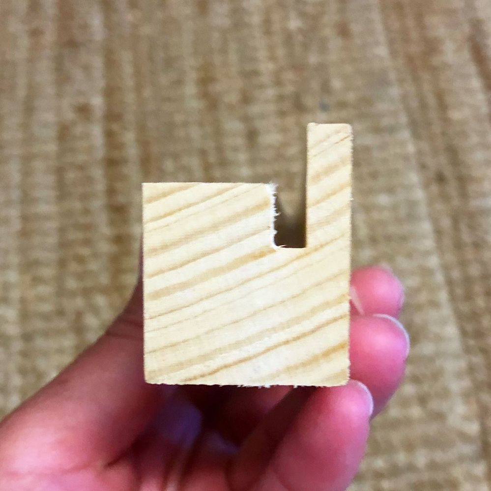

Cord fits snug in the slot and holds print in place.

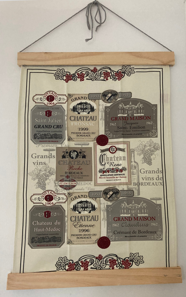

Workshop member Jesse1 used this idea to hang a beautiful tea towel that she bought on a trip to France.
