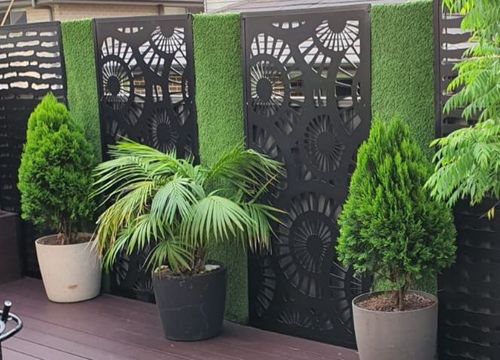

I would like to install this type of screens in my backyard .I am not able to understand how to install this artificial turf between the screens ..any recommendations will be appreciatedÂ

Hi @mann,
The grass doesn't appear to be installed very tightly, so taking a guess, I'd presume they've just screwed it into the side of some posts, as I've illustrated below. I think you could achieve a much more professional finish by wrapping it around a solid board and then attaching that to the posts with angle brackets. With my method, you'll be able to pull the grass much tighter, and it won't look so sloppy as in your image. You could even glue the grass down to the board.
