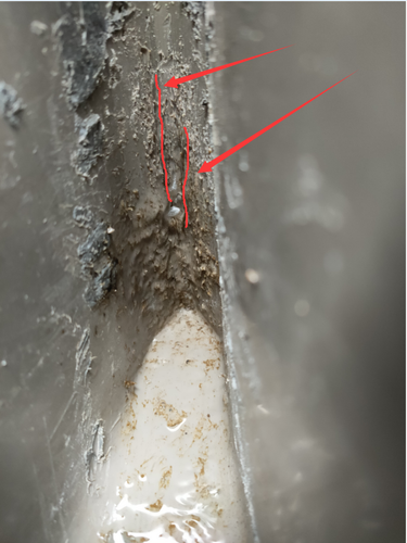

Ifound 2 leaks on my poly rainwater tank, what is the best adhensive I can use to plug it ?

The issue is the water pressure behind the crack. Although it is a slight trickle of water, it will take some force to stop it permanently. How much water is in the tank?
The putty needs to be pushed firmly into the cracks and it looks like you might need to use some time of push stick if it is a confined area.
The Selleys Roof and Gutter Silicone won't seal an active leak. Potentially if you drained the tank and painted it on both sides of the crack, it might seal. Once again, a product like Gripset Betta 1L Waterproofing Membrane Bitumen Rubber would be best applied from the inside. Sealing a leak on the outside is like putting a bandaid on a leaking tap. It might stop it dripping periodically, but eventually, the water will find its way past.
You could try either of those products or Gorilla White 100mm x 3m Waterproof Patch & Seal Tape, but I'm not convinced they'll work.

I managed to take a video today.
As you metioned "If you manage to get it into the hole/crack, it could do a reasonable job of sealing it", is that means I have to push the putty into the tank through cracks? As you can see, they are very fine cracks, so what should I do? Should I push the putty really hard, so it get into the cracks?
I went to the local Bunnings today, it seems Rust-Oleum 240ml Crystal Clear LeakSeal Flexible Rubber Coating Sealer is out of stock.
Is there anything else I can use? How about Selleys 300g Roof and Gutter Silicone Waterproof Sealant? or Gripset Betta 1L Waterproofing Membrane Bitumen Rubber?

Have you tried anything previously, or is that how the tank usually looks? It just doesn't look particularly smooth in that area which isn't necessarily bad as the texture will give an epoxy a chance to stick to it.
A plastic welder is the most appropriate way to repair a hole or crack in a poly tank. The hole/crack needs to be melted back together as not many products will stick to plastic. If you clean the area thoroughly with soapy water and then dry it, you can try some PC Products 57g PC Marine Epoxy Putty. It's a two-part product which you mix up and smear into the damaged area. If you manage to get it into the hole/crack, it could do a reasonable job of sealing it. I'd suggest you then paint over the exterior area with a product like Leak Seal.
