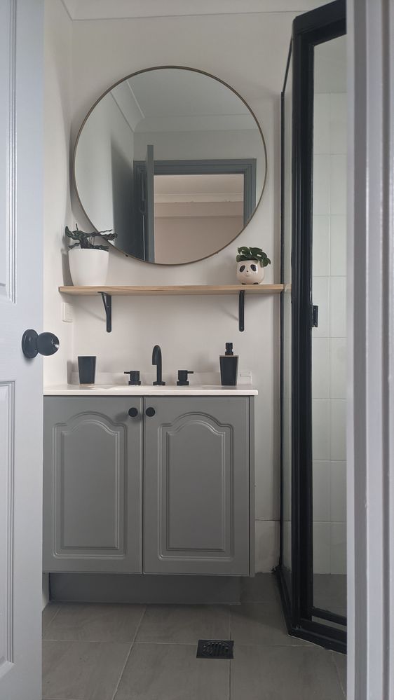

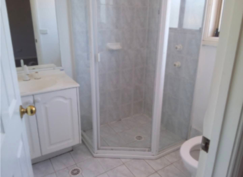

I renovated my ensuite with a new toilet, mirror, shower mixer, tapware, floor tiles and floating shelves.
I scraped all the ceiling paint off as it was flaky and damaged due to moisture. I used Aquablock Waterproof Primer Undercoat to seal and prime before painting the walls and ceiling with Dulux Natural White. I also painted a feature wall with Dulux Ticking.

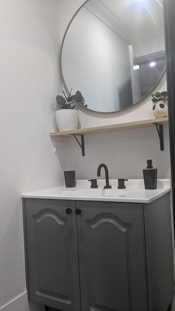

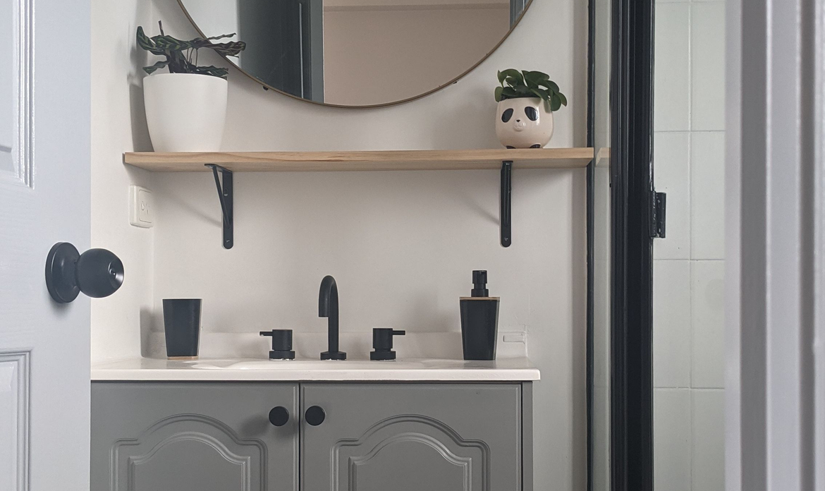

I painted the wall shower tiles and bathroom vanity top with Rust-Oleum Tub and Tile Refinishing Kit and the cabinets with Dulux Timeless Grey.

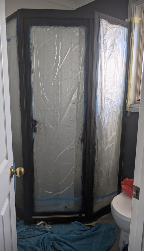

I sprayed the shower screen with Dulux Metalshield Epoxy Enamel. I used a plastic sheet to cover the screen before spraying. If I were to do it again, I would paint the shower screen by hand as it would give a much smoother finish.
