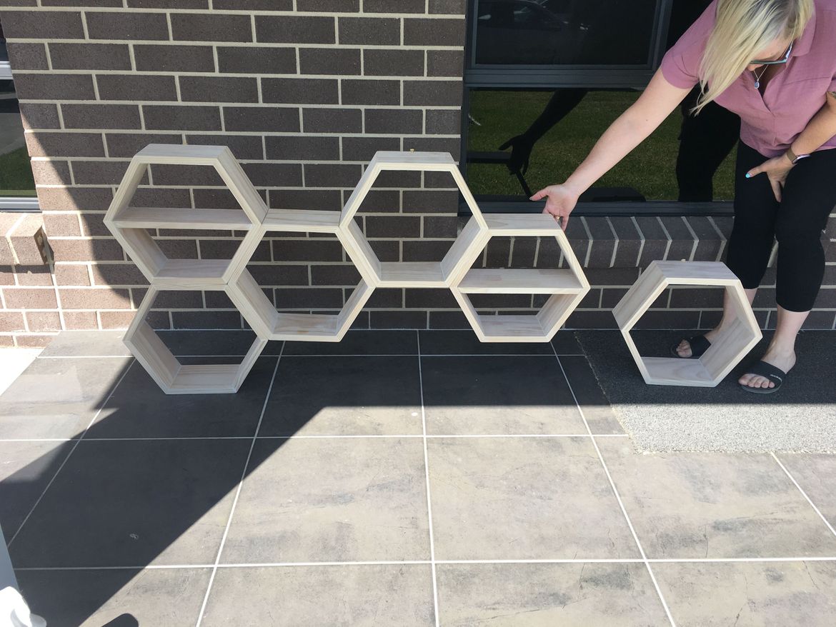

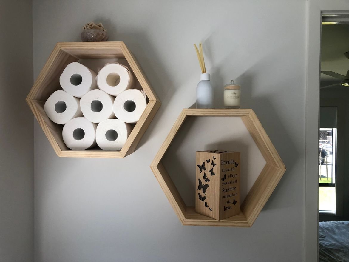

This collection of hexagon shelves is a fantastic storage solution that could be utilised in a bathroom, bedroom or living area.
The project
It started with my daughter asking for some hexagon shelves for her bedroom and it ended with my wife asking for shelves for restrooms.

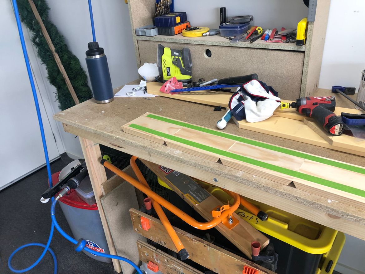

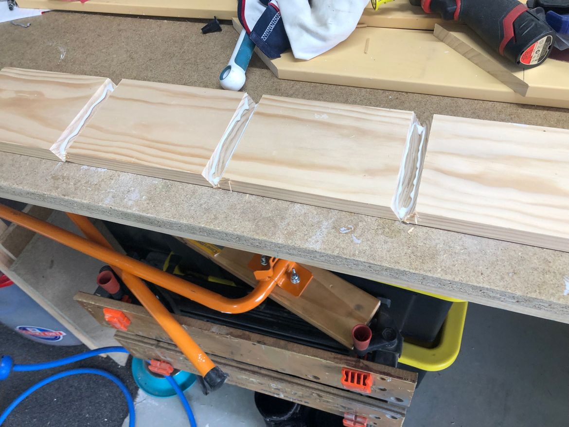

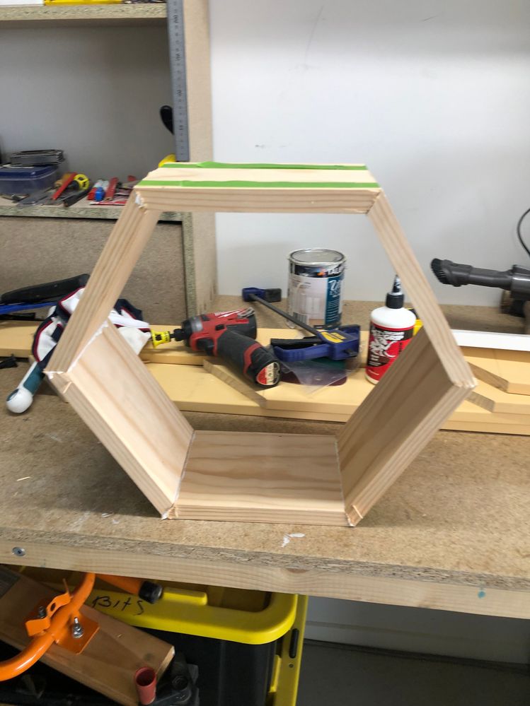

I used a drop saw to cut all the sections. It was set at 30 degrees. I then turned them upside down and taped them together.
Once I had them glued, I used a nailer to ensure the pieces held together. I sanded them down and finished with bees wax.

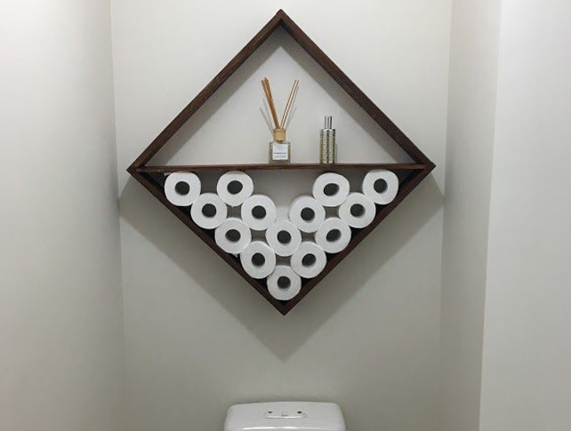

How to build a toilet roll holder shelf
Organise and decorate your bathroom or powder room with this streamlined shelf that not only looks attractive but also makes fantastic use of space. Check out the guide How to build a toilet roll holder shelf and Rodney's toilet roll holder shelf project that inspired it.
