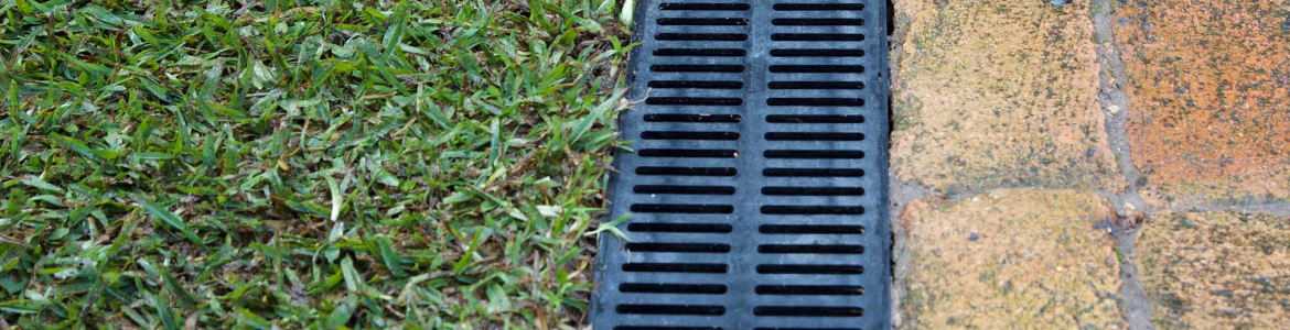

The lawn was becoming boggy because too much surface water was coming into the area and then being blocked by the paving. Water was also flowing over the pavers, leaving them very slippery. The solution was simple – add a modular grated drain.
First, we dug a trench alongside the paved area, ensuring that there was a fall of at least 5mm every metre.
The grated drain now collects waterWe mixed concrete and spread it evenly along the base of the trench. Then we added our drain modules, tapping down with a rubber mallet to firmly bed them in. We used a flexible, non-slotted drainage pipe to run the water to our outlet spot.
This drain now collects surface water from the lawn, keeping the surface flow off the paving.
