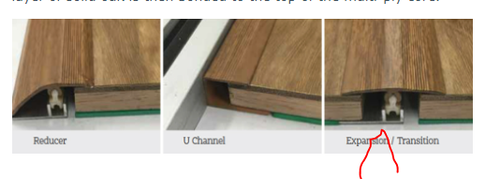

Hey team, I am installing laminate flooring in a few weeks. Ive got various transitions to existing rooms - laminate to carpet and laminate to tiles - the tile edge should be approx the same height as the laminate once in, and the tile edge has an aluminium angle already installed to protect the tile edge.

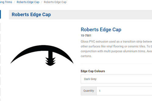

Any thoughts on the easiest way to cover and which items to buy. I am super confused. I'd be happy with something like the qep pcs covers to be honest (https://www.bunnings.com.au/qep-black-vinyl-edge-cap_p6822319) but does that require a "u channel" or is there an easier way to do it.
Also should I leave off the edge strip to our new bedroom which has yet to have carpet installed and let the carpet people take care of that edge?
