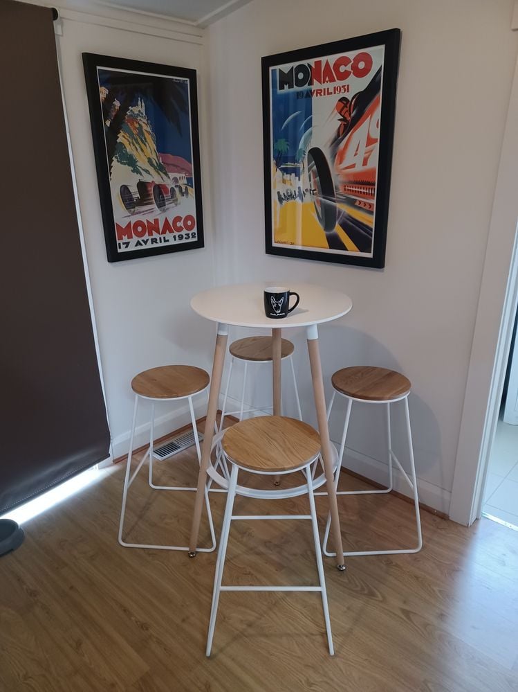

Well-used bar stools were freshened up with varnish and paint.

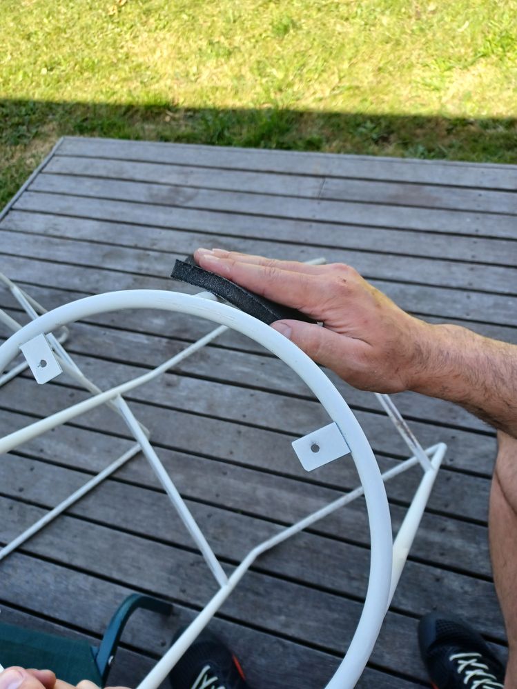

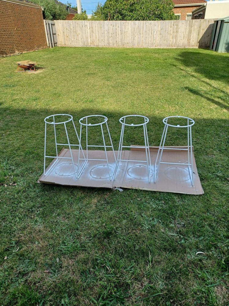

We took off the wooden seats, lightly sanded the metal base and then sprayed the base with Dy-Mark White High Gloss MetalPro Quick Dry.
Then we sanded the seats using an Ozito detail sander with a course and then fine sandpaper.

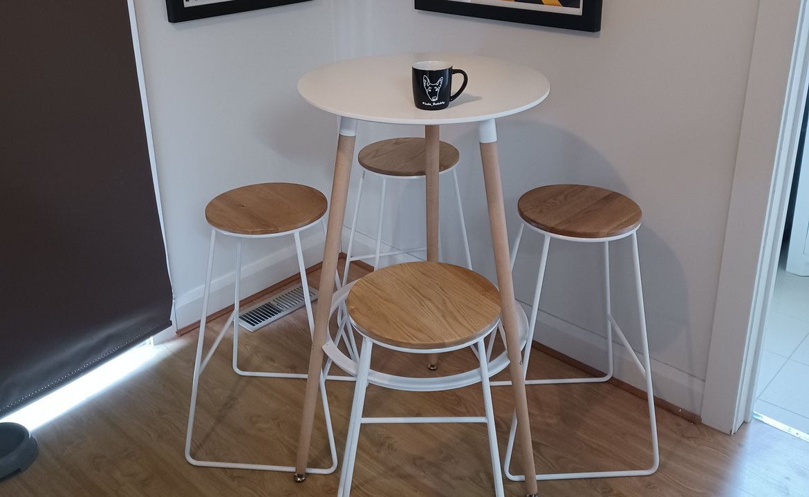

Finished off the project by applying Bondall Satin Monocel Clear Timber Varnish to the seats. We decided to keep the light colour of the timber as is and give it a hint of shine.
Don't use old clear gloss for this kind of project. We thought we would finish up an old tin of clear gloss for the seats. Bad idea. It left white dots on the seats and it was sticky to the touch after drying. We ended up having to re-sand the seats – luckily we only applied the gloss to two seats.
We refurbished the stools in the morning and by evening they were ready to be used. We waited until the next morning to sit on them and enjoy a cup of coffee.
