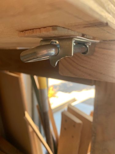

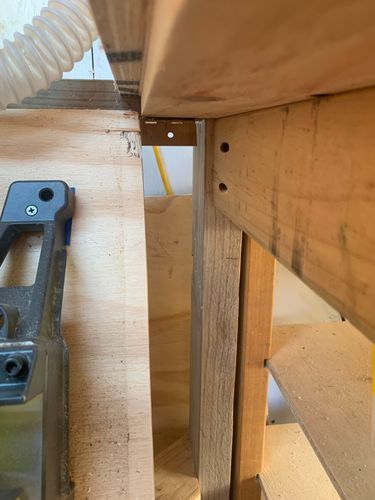

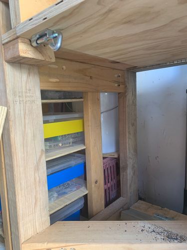

Thought I would give everyone a look at my latest project. I made a bench each for my 18V saw and my sliding compound miter saw. The saw are each on a plywood tray, which folds up and fixes with a barrel bolt underneath either side, and folds down to allow fitting of a lid, giving a flat bench top beside one or other of the saws. The levers underneath actuate castors which are mounted on a hinged board, and lift the benches off the floor to allow them to be moved easily.
The designs are not mine, I got them from various YouTube sources, but the overall result makes such a useful workbench I am amazed how much I use it. The plastic tubs are for wood screws and metal screws.
