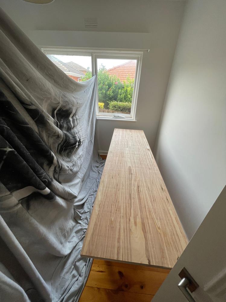

After decided which side of the timber I preferred as the top side, I measured and drilled the furniture leg and braces in place. Equal space from each edge of the timber and evenly centred along the 600mm depth of the table were the important considerations here.
A couple of runs of 120 grit sand paper to soften the top and sides and damp cloth to clean off any dust.
Once that dried, a matt finish Cabots Cabothane (Cabot's 250ml Clear Water Based Cabothane Interior Varnish Matt - Bunnings Australia) applied with a brush brought out the great natural colours.

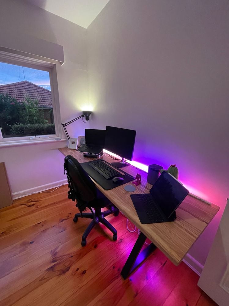

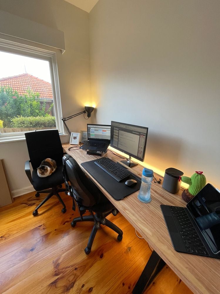

And last, a LIFX light strip around the back edge for some added detail (LIFX Smart Lightstrip Colour Zones Starter Kit 1m - Bunnings Australia).
I enquired through a number of furniture makers for something of similar size and look to what I made. Prices were anywhere between $1200 - $1700. Total shopping list for this desk was between $325 - $375, and completed over a weekend (between many other projects).
