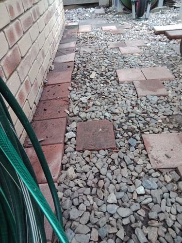

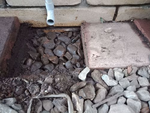

I had intentions of straightening a row of pavers (IMG_1.jpg) that was all uneven and wonky and slopes down. However, upon lifting a few, I found they were all sitting on a bed of stone and not sand (IMG_2.jp2).

I should point out, that this area was awash with rain water during the recent storm which entered from the side of the house (the side of the house is at the top of IMG_1).
With every heavy rainfall over the last few years, we've found a whole lot of drainage issues with this house since purchasing it!
The area where the row of pavers (along the wall) are, are all under a patio and generally remains dry if the total rainfall for the day is less than 10mm. Anything more, and water seems to seep up from the ground.
