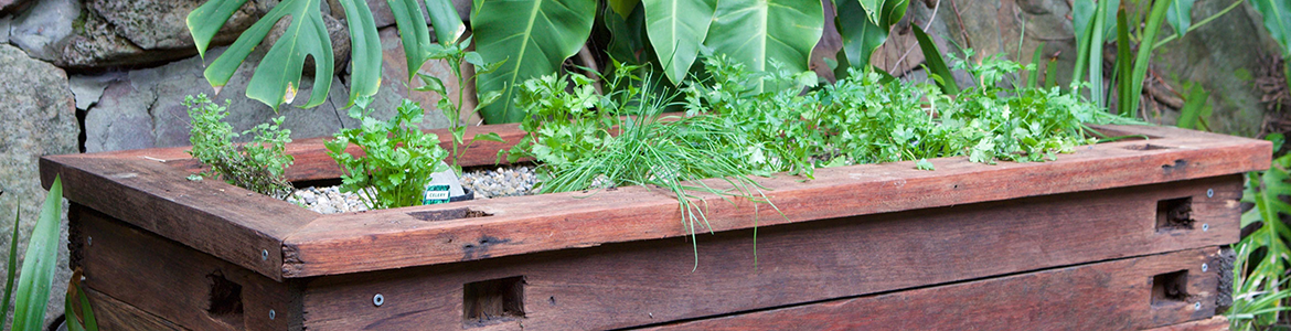

There are two main parts to an aquaponic system: a pond, which can contain edible or ornamental fish; and a grow bed for growing plants.
The grow bed is fully sealed or lined to retain water. It is filled with fine pebbles or gravel, or another free-draining growing medium.
A pump moves water from the pond into the grow bed. The grow bed gradually fills to a set point, at which a siphon valve opens and drains the bed, returning the water to the pond, and the cycle starts again. This is often called a “flood and drain” system.
Colonies of beneficial bacteria will develop quickly in the gravel in the grow bed. These consume waste materials in the water, converting them into liquid plant food. This nutrient-rich mix turbocharges the growth of plants, especially leafy vegetables.
The process also cleans the water, which returns to the pond clean and clear.

What plants can I put in my grow bed?
Aquaponics are great for herbs and leafy greens, such as basil, coriander, lettuce and silverbeet. Experienced aquaponics growers say these can grow up to four times as fast as they do in soil.
You can grow other vegetables and annual flowers too, though the results might not be as good. This is because the water tends to be high in nitrogen, which promotes the growth of leaves rather than fruits and flowers.
Every system is different, so it can be a case of trial and error. Add a tomato plant and some strawberries and see how it goes!
You can use regular seedlings from punnets, or more advanced plants. The important thing is to remove the potting mix from their roots. This must be done gently, preferably in a bucket of diluted seaweed solution.

How big should my grow bed be?
The size of your grow bed has to suit the size of your pond. If the grow bed is too big your pond will be drained dry. If it’s too small it won’t clean the water as well as you want.
Home-garden hobby systems often have a grow bed the same size as the pond. This won’t drain the pond because the gravel takes up at least 75 per cent of the volume of the grow bed. The ideal gravel depth in a bed is about 30cm.
The most common growing medium is pebbles or gravel smaller than 10mm (larger sizes won’t create the pockets for the beneficial bacteria to live in).
All gravel should be thoroughly rinsed so silt and contaminants don’t cloud your pond. Don’t use recycled crushed-concrete gravel as this may affect water pH.
“Expanded clay” products are very useful because of their high surface area but too expensive for the average home system.
