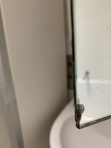

Hi,My mirror is over basin, length is 840mm,width is 685mm.Its edge is broken ,about 4mm. Does it need a frame or sth? Thank u!

Could you please also share a wider shot showing the whole of your mirror and its surroundings so we can see where it would be possible to install a frame or whether it might be best to repair or replace the mirror.

Hi @vica. I apologise for the delay in my reply. Many thanks for your question, I'd be happy to give some advice.
You can create a frame out of Metal Mate 12 x 12mm x 3m 1.4mm White Powder Coated Aluminium Angle and glue it to the mirror with Selleys 310g Liquid Nails Mirror Metal And Glass. That will certainly protect the edge of the mirror from further damage.
Can I please ask if that portion of the mirror is coming in contact with anything or is there a contact point outside the image area which it is bumping against? It would be unusual for damage like this is occur without an impact of some sort. If there is a contact point we can perhaps address that also with a buffer of some description.

Hi@Mitchell,Good morning ,thank you so much !
I bought this house two years ago, ignored the mirror at that time. Also the broken point was not so serious .
I plan to renovate house step by step . Wish further help from you , You are  so sophisticated !

 I am sorry to ask how can I cut the
Metal Mate 12 x 12mm x 3m 1.4mm White Powder Coated Aluminium Angle ? I mean I haven’t  tools and am not able to use them. I think maybe Bunnings service can help me .I can pay for it.

I'm sorry but we don't currently have a service for cutting aluminium. You can cut the mitred corners with a Rolltrak Flyscreen Mitre Box and using a hack saw.
If you needed advice on how to do so or had questions, please let me know.
