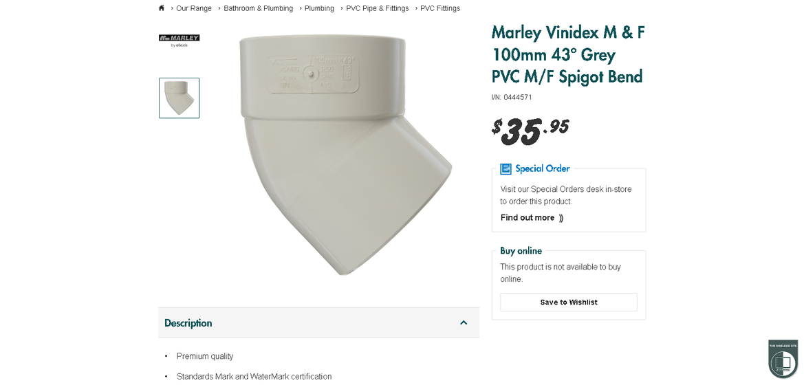

My first thoughts are that the pipe coming out of the wall is at an unfortunate angle. You're dealing with an offset and an unusual angle of approach from the incoming pipe. Do you happen to know what the offset is on the current connector that is leaking?
It might be a matter of trial and error, but I believe if you cut the pipe back to the wall and attach a Marley Vinidex M & F 100mm 43º Grey PVC M/F Spigot Bend, then an offset connector would have a better chance at fitting. Once the spigot bend is fitted and you have two pipes parallel with each other, you could select the correct offset connector to suit.
Offset connectors join pipes that are parallel to each other but not quite inline. As you've experienced, because of the rubber fitting the waste pipe can have a slight angle to it. However, once that angle becomes too large, they'll start to leak.

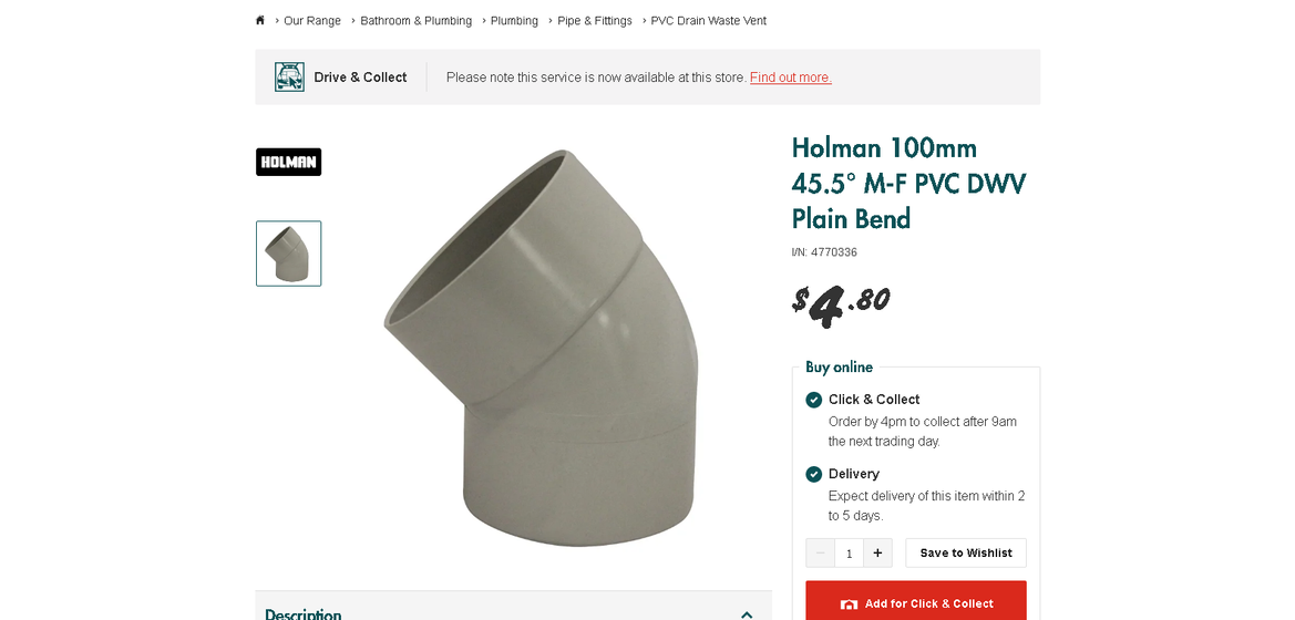

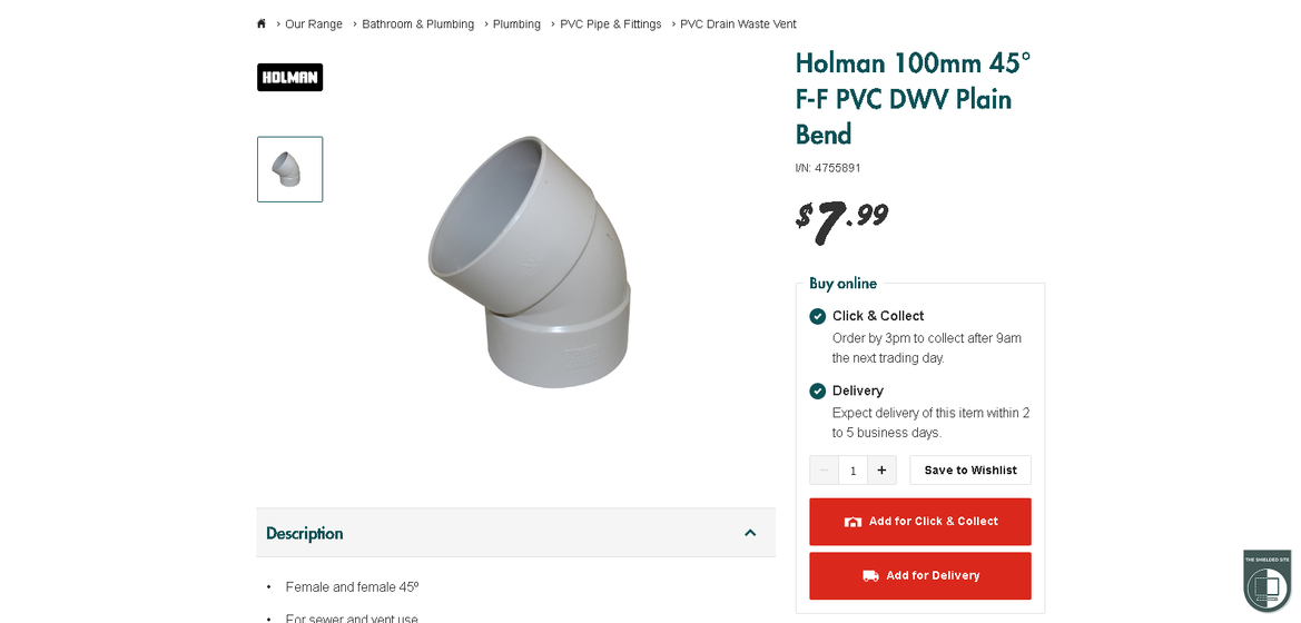

Just to add to @MitchellMc 's suggestion you can use 2 x 45 degree bends to increase the height of the current exit pipe. You will have to cut a bit of the pipe back to install the additional bends but it will increase the height so that it lines up with the toilets current level. I suggest using a Nucon pan connector a much better seal of the outlet. I've attached pictures below.
Cheers,
Red
Screenshot_2021-03-07 Holman 100mm 45° F-F PVC DWV Plain Bend.pngSee if you can find a NZ equivalent.See if you can find a NZ equivalent.Better over all seal with rubber all around.Better over all seal with rubber all around.There's the NZ equivalent!There's the NZ equivalent!
