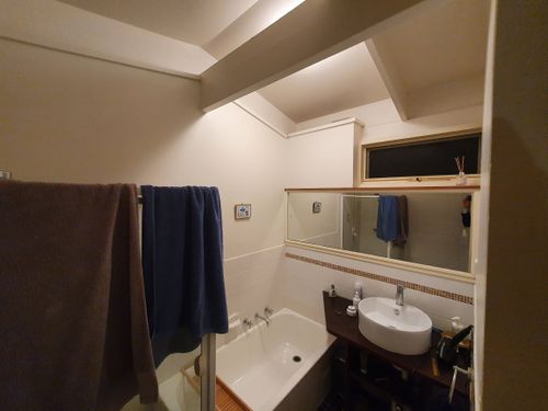

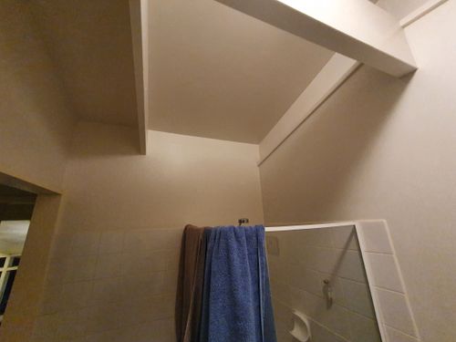

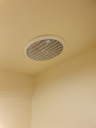

Thanks Mike that us all helpful info.
I've got these photos here which are from the ensuite. The first is the heat and light unit and the other photo is of the fan which has a whirly bird on top of it. The darker photo is of the light in the bathroom in question
How do you suggest I approach a sparky about doing the job? The couple I've contacted have either flat out refused the job or said that it would be too hard to do a 3 in 1 unit.

Your photo of the heat and light fan enclosure looks to be promising. I suspect the sparky only wants to do the connecting part and not the building part. However, before building the enclosure, is the distance from the heat and light unit to the floor in accordance with council regulations? That could possibly be another reason why no fan was installed in the roof area due to the distance. I suggest asking the electrician, what if everything was built ahead and all they needed to do was to connect the wires? Perhaps they will be more open to the idea of installing it for you.
Thanks Eric. This info will give me a bit more to go with when asking some trades about the job. I think I'll look to get a wall fan out the window and then have the heat / unit installed where the light is. Would be handy to know who did the job for the ensuite but we have only been in this property for a year.
