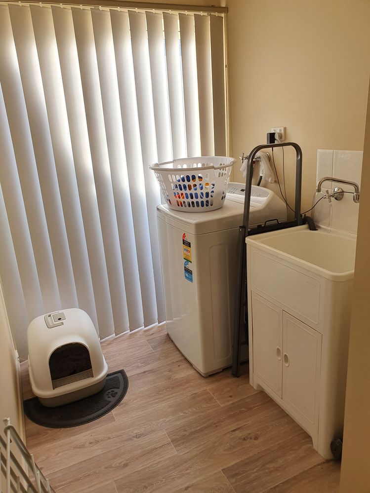

Hi everyone,
Just bought a new place and want to have a go at my first reno job!
I have  laundry with nothing but a freestanding trough. Wanting to have bench space plus cupboards. I have done a sketch of what I am thinking but thought I would ask other more experienced people if it would work!
Length of alcove is 170cm. Width (out to be in line with existing linen press) 59.5cm. Want at least 87cm height for bottom cupboards to fit a frontloader washing machine under the bench.
Attached some photos :smile:
Any advise or tips would be greatly appreaciated. 20200221_184005.jpg20200221_184018.jpg20200221_184032.jpg20200228_142845.jpg

hi sarahb, can you please give me measurements of the wall behind the washer and laundry sink from the cupboard , also does the sliding door open from the left or from the washing machine side. cheers kb54

Hi there @kb54 .
That is the 170cm measurement.
Sliding door opens on other side. Not near washing machine. I don't use this door so happy to put cupboards blocking it. Obviously can't go all the way across cos of the window. The measurement is to start of wall (near window).

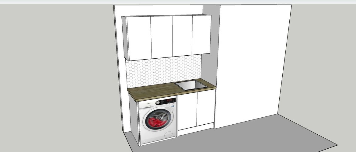

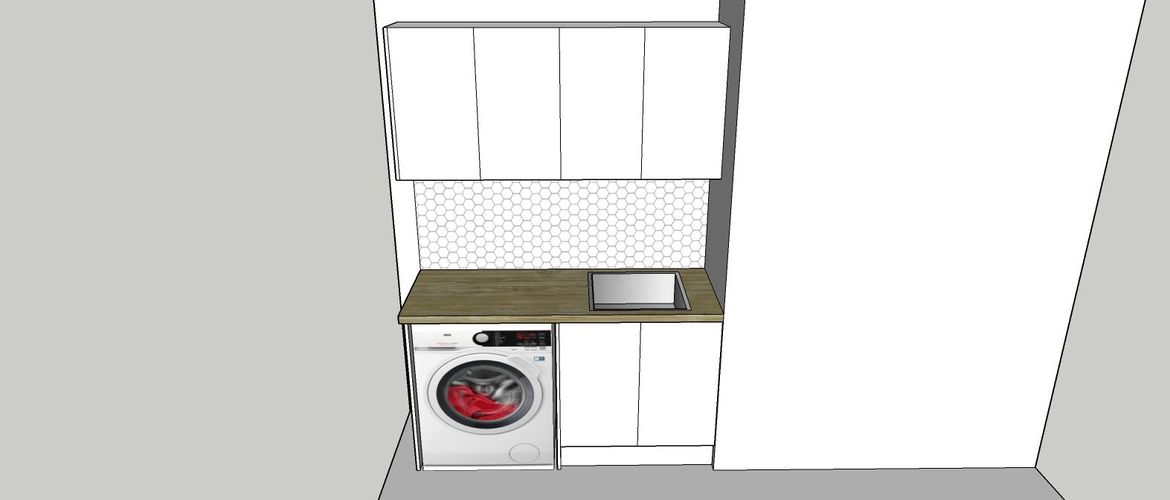

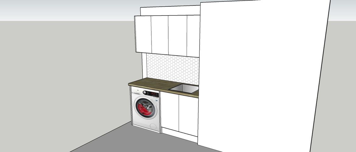

Hello @Sarahb
Below are some drawings I made for you. However it is on the assumption that you will change your current top loader for a front loader. You will need to leave enough space for your vertical blinds to open and close. The plumbing may need to be moved a little bit to the right, depending if the new laundry sink is centered to the new cabinet that will be placed there. The drawing shows that I did not remove your existing pantry and only placed the units that will fit in the space. I hope it gives you a better idea of how it will look and possibly help you to decide how you wish to proceed. Just message me here on workshop if you have any more questions.
Cheers,
Red

Re: Advise please - for a small laundry reno
Sorry for very late reply. Work had been a little hectic.
Thank you very much for the drawings @redracer01 . That's exactly what I have pictured in my mind. I thought moving the trough down like this too, to give a larger continuous bench space area.
I thought I might only get 3 cupboards above but looks like I'll get 4 such is exciting!!
Where would I put washing machine taps? Leave where they are or would it be better to move under bench?
