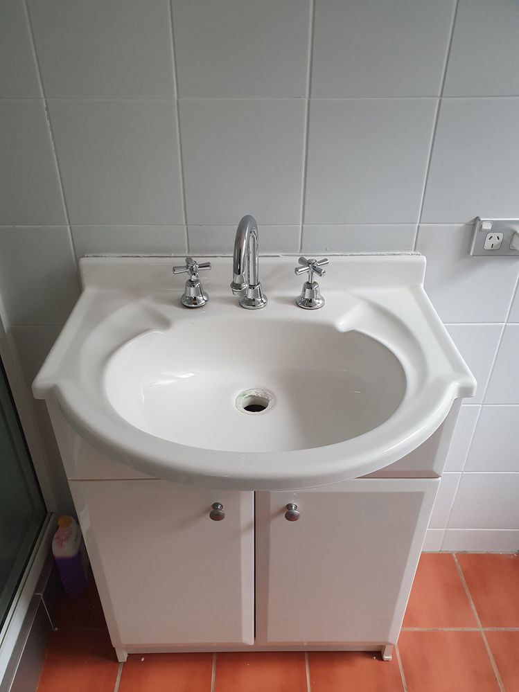

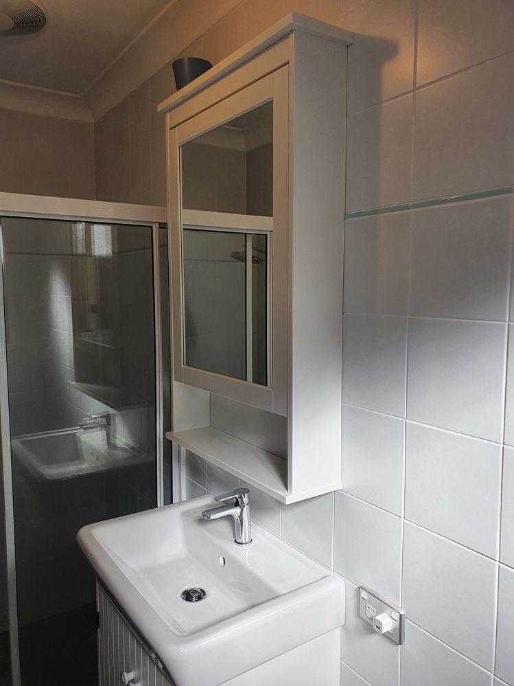

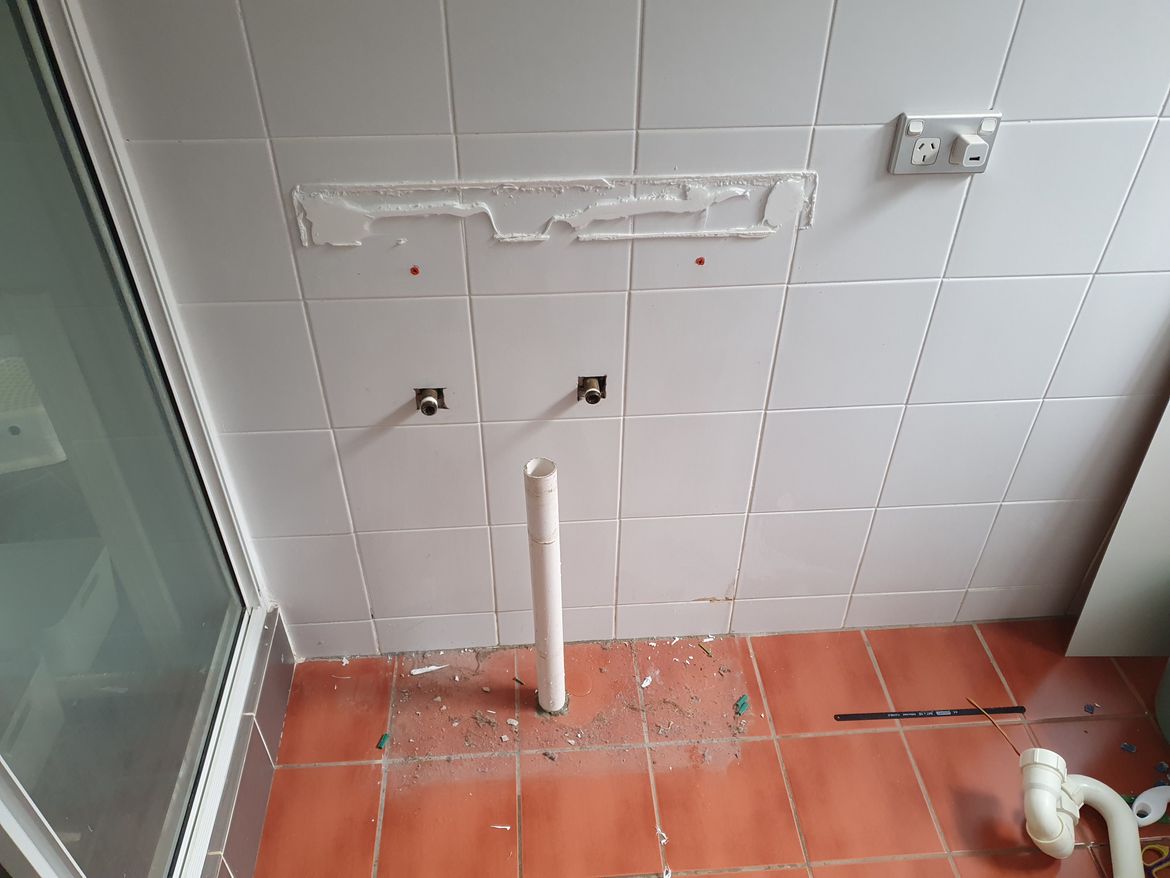

Just wanted to share with everyone our affordable vanity ensuite install. Trying to keep the cost down, we did the install ourselves and sold the old vanity on eBay. It was a tight space, so we went for a narrow vanity unit and also put in a medicine cabinet. Most of the plumbing supplies I bought from Bunnings, while the vanity/sink/cabinet from Ikea.
AfterAfterMedicine cabinet is so usefulMedicine cabinet is so useful20200709_115748.jpegOld unit was sold on ebayOld unit was sold on ebayDemoDemoplumbingplumbing

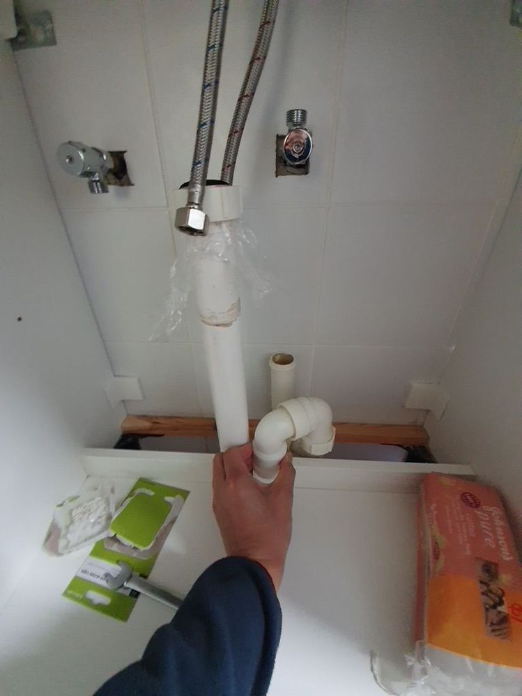

Hi @MitchellMc
Thanks for comments. When we started, it's always hard to visualised the final results, but we are happy with the outcome. As you said, the build was easy, and the hardest part was finding the right size vanity. Doing the plumbing was a challenge as I wanted to push everything to the back to maximise space. In our old vanity unit, the S trap was right in the middle which took up so much room. I ended using the Abey PVC connector waste trap and arrange all the plumber flush to the back. It looks really neat and creates more storage.
