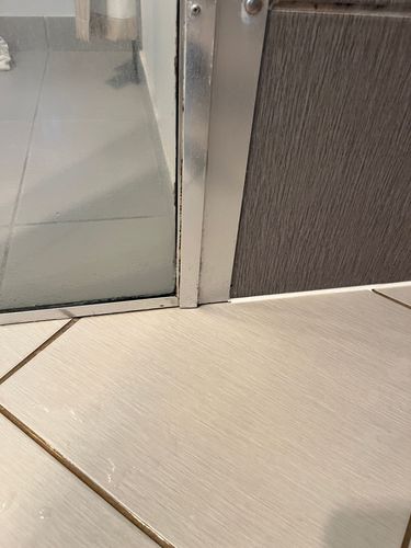

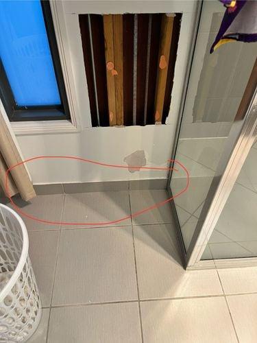

I’m trying to determine where I have leak coming from my shower. After doing a flood test, water did seep through the corner of the shower. There is a silicone gap from inside the shower. I’ll redo the silicone and also scratch out some of the grout that’s cracked and reapply new grout.  But was also wondering if outside the shower where the floor and skirting tiles meet, if it’s meant to be sealed with silicone?

Thank you for sharing your question about your floor and wall joints. Renewing the silicone seals inside your bathroom is a good step in keeping the shower watertight. Sealing where the floor and skirting tiles meet is not a bad idea and serves as a precaution. Should water ever flow in that direction you can be confident that the skirting tile and floor are sealed.

There is no harm in sealing the wall to floor tiles, Tho I would expect the waterproofing that is under the tiles (wall and floor) should be covering the waterproofing. Within your shower and the flood test (they scare me lol ever since an asser from an insurance company come out to see if water damage was covered in my old shower, it wasnt and the shower failed spectaculary) you have done, wise move btw.
