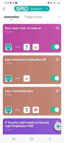

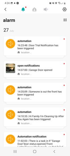

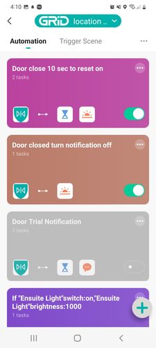

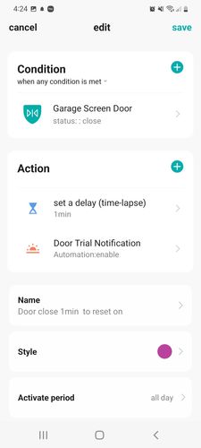

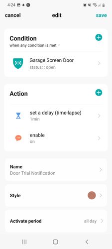

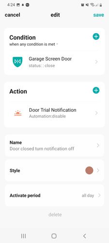

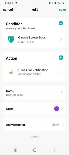

Hi,  I was trying to use the contact sensor to warn me if if the laundry door had been left open but cancel the notification when the door is closed.  Currently I have it set up with the following automations but after 30 minutes I get the notification that the door is open even after it has been closed.
1. when the contact sensor is open a delay of 30 minutes applies and then a notification goes out.
2. When the contact sensor is closed automation 1 is disabled
3. When the contact sensor is closed a delay of 10 seconds is applied then automation 1 is enabled
Not sure what I'm doing wrong or maybe it's just not possible.  If not I would like to suggest that an option be added to allow for this type of thing.

Personally, I haven't used the scenes in the app, but from a coding perspective, I wonder if rules 2. and 3. are superfluous. When the door is closed, the contact sensor isn't open, so I wouldn't think it would send out a notification, or you'd need to disable rule 1. with rule 2. and then re-enable it with 3.. Or, is there a reason you've included them like it won't reset to monitoring the contact sensor for open and repeat rule 1.? As mentioned, I'm not familiar with the scenes, and you've likely included the extra lines as rule 1. wasn't enough on its own.
