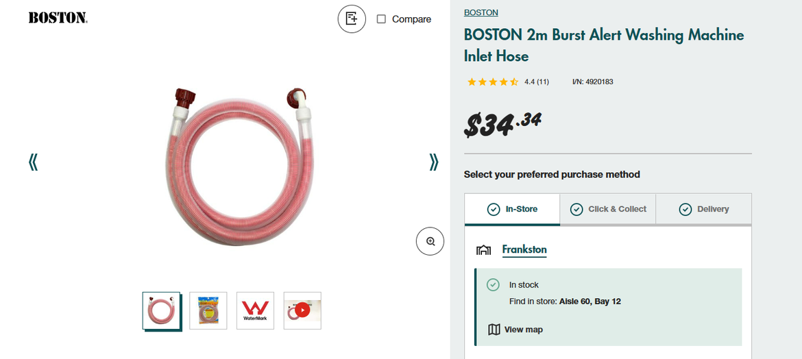

I fitted a pair of these "burst alert" hoses a few years ago - been good. I noticed one was red and the other was clear - so I went to Bunnings to buy a new one. There were 5 on the shelf and they all looked red too. So I have one clear hose and one red hose (that looks like the ones in stock). I thought they were only supposed to go red when the inner hose burst?
Hi @pauldavidson,
The hoses appear red from new but will turn bright red if a leak is detected. They are not clear to begin with. You can see one still in the packaging below. What happens is the burst water is captured in the outside opaque clear sheath and makes it go translucent, and the red appears brighter. I'll include an image of that below too. Check out the product page and click on the video. It shows you what will happen and how it looks when a leak is detected.
