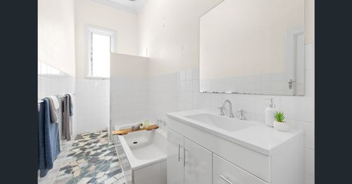

I'm currently looking to remodel my bathroom. It is a really long but narrow space, it is around 3.9m (length) x 1.3m (width) - see the floor plan and photo below.
Really keen to get some ideas/suggestions on the new bathroom layout as I would like to fit a toilet somewhere, and ideally I would still want to keep a separate shower and bath. I have a couple of ideas but not sure if it will work.

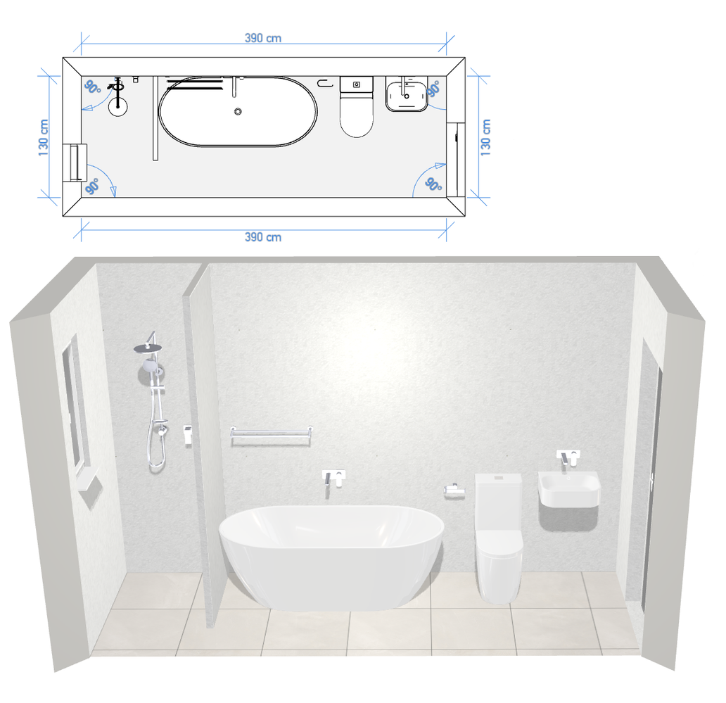

Hi @Susu,
If you were to go with a free-standing bath, reduce the shower space slightly and minimised the sink, then it looks like you could fit the toilet. It's going to be fairly tight but still achievable. I'd suggest reducing the sink's size more than the shower as there is nothing worse than a cramped shower.

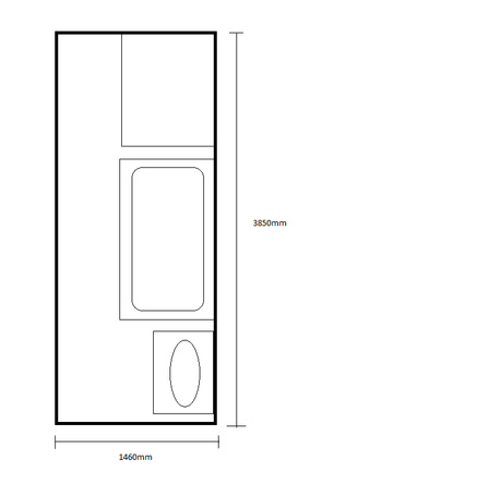

I did a proper measurement today and I realised the width of my bathroom is actually 1460mm wide and the length is around 3850mm. I have resubmitted my floor plan with measurements. see below.
I think with the new measurements, I might be able to go with my plan 3 of fitting my bathtub at the end horizontally with a separate shower, new toilet and perhaps even a double vanity? see my drawings below. I wonder if something like the below would work? Would you guys know what is the recommended spacing for things like a bathtub, shower space, the gap between the toilet and the glass panel and the vanity?

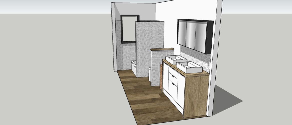

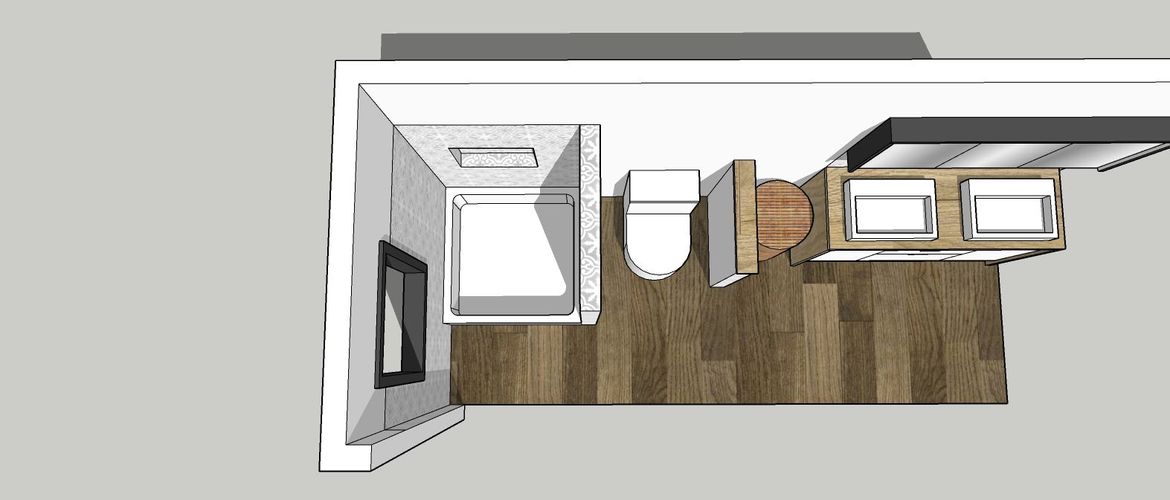

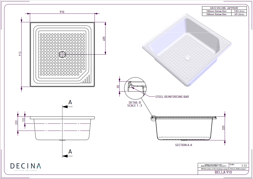

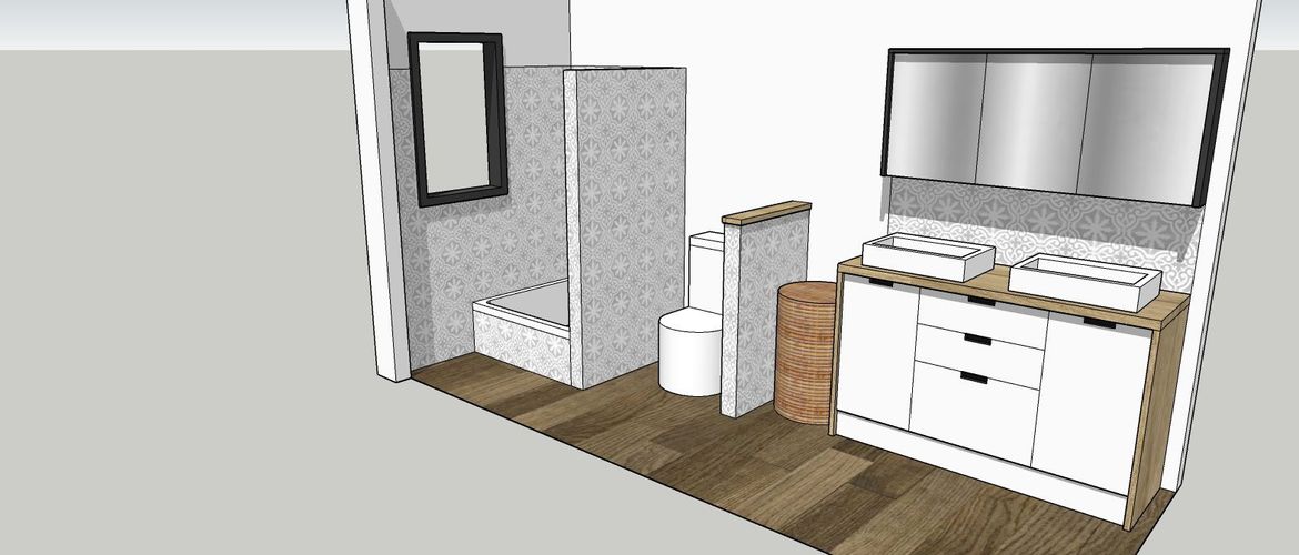

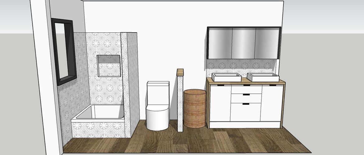

Welcome to Bunnings Workshop! Thank you for sharing your project with the workshop community. I see @MitchellMc has given you a very a very good idea of a possible layout. Since you've proposed a shower over bath there is a bath that does not take up a great deal of space and is almost the same size as a standard shower enclosure! The Bella 910 Inset Shower Bath is perfect for your application. When you want a soak simply push the plug to close and you can soak in the tray itself. It is of course for those times that you feel that a quick soak would help or perhaps when the kids want a bath! I've included the dimensions at the bottom of the post. Now when you are at the far end of your bathroom you will see that I've hidden the toilet in a small wall. Visually speaking it looks like there is no toilet but as you walk in further it slowly reveals itself. In this configuration it affords you to have a 1200++ vanity and a laundry basket. But if you feel that you want a full length bath then you will have to compromise on the size of the vanity and we will have to squeeze in a toilet that requires a space of at least 800mm. Please have a look and if you prefer the configuration with a larger bath I will redraw your lay out for you.
To answer some of your questions :
Re-locating the plumbing will not cost you a great deal, obviously less if you leave the plumbing where it is.
The space for your bath tub is dictated by the size of the bath, there are no fixed rules for bath spacing for installation yes, but you can have as much or as little space as you want near the bath. Same goes for showers, I have seen 750 x 750 showers and sometimes even smaller. Again there are no fixed rules, but perhaps for the ability to actually have a shower in a very confined space.
because the bathroom is so long you are tempted to fill it with as many bathroom appliances as possible. I suggest having a ponder about what you really need for your bathroom. Will having no bath affect the family? Do you prefer a bath to a shower? Do you have seniors in the house that might trip in shower over bath configuration? Once you've determined what you need then, laying the bathroom out should become much easier. I say should because there are a dozen more things to decide on like tile color to tapware. Below are the sketches I've drawn up for you have a look and tell us what you think. If you have any more questions please post it here on workshop and we will try to answer them as best we can.
