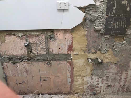

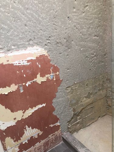

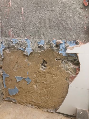

Not sure what to do with the walls though - there is a mix of rendered parts, sheeting, and grey blocks. I think the original bathroom had a built in tub and it looks as though a sand based render was applied to the original blocks to fill it in to the same level as the rest of the wall (see photos of lower 60-70cm of the wall). Similar to the sand based screed on the floor this has been falling away in clumps as I remove the wall tiles.
The rest of the wall has a thin pinkish cement based sheeting over the grey render that was easy to remove in some parts but pretty well stuck in others (see photos of some remaining sections and where this has been removed).
My plan at the moment is to remove all of the loose sandy render and the pink sheeting down to the grey render. But should I also remove the original render down to the blockwork (this is what the plumber suggested)?
