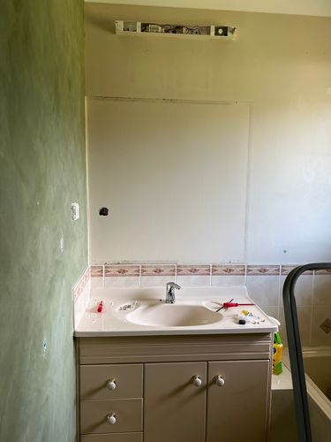

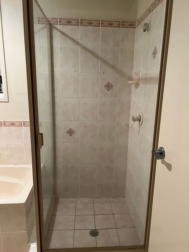

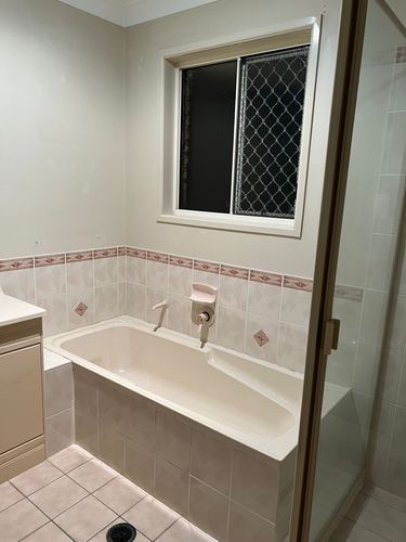

The existing flooring and tiles were in decent condition, however there was a lot of grout worn away, mould underneath silicone etc. Vinyl was peeling off the vanity unit, old fluoro light fitting.
Here is what I had to start with... 🙄
Mirror already removed in this photo
Beige tiles and dated feature tiling
More beige...
... and the beige continues!

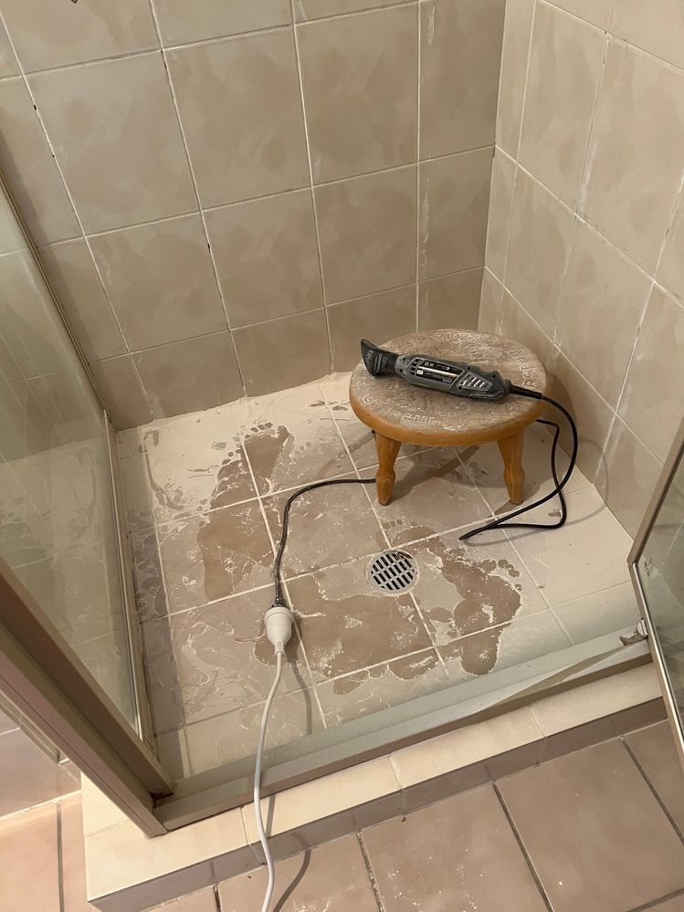

REMOVE SILICONE and GROUT
- Cut and scrape away silicone from all edges around bath and shower recess. Clean throughly to remove all traces of silicone.
- Scrape away grout between all wall tiles (around vanity, bathtub and shower recess).
- I used a combination of a grout scraper and a Dremel with grout-removal attachment.
- More care should be taken where re-grouting (as opposed to removing tiles).
- Use a mask, gloves, glasses etc - it gets VERY dusty!
Removing grout in the shower

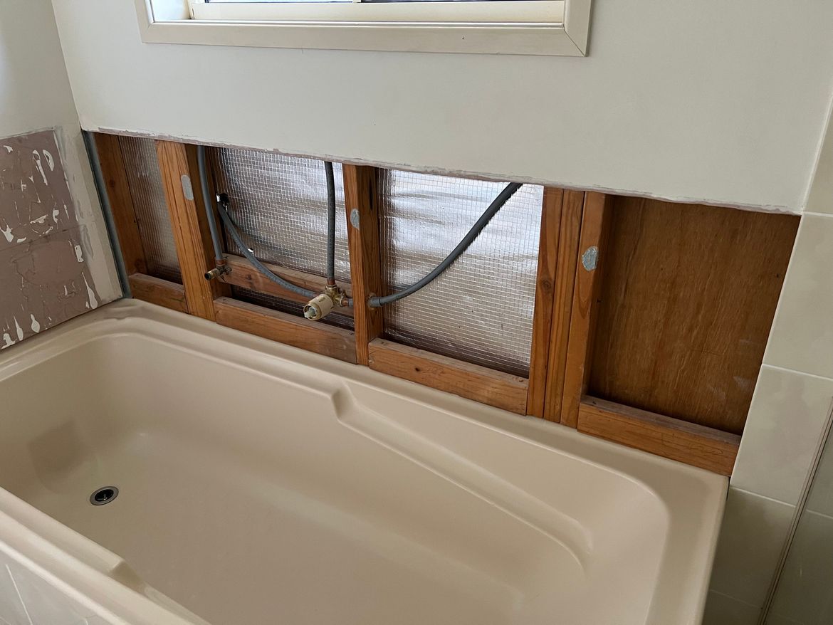

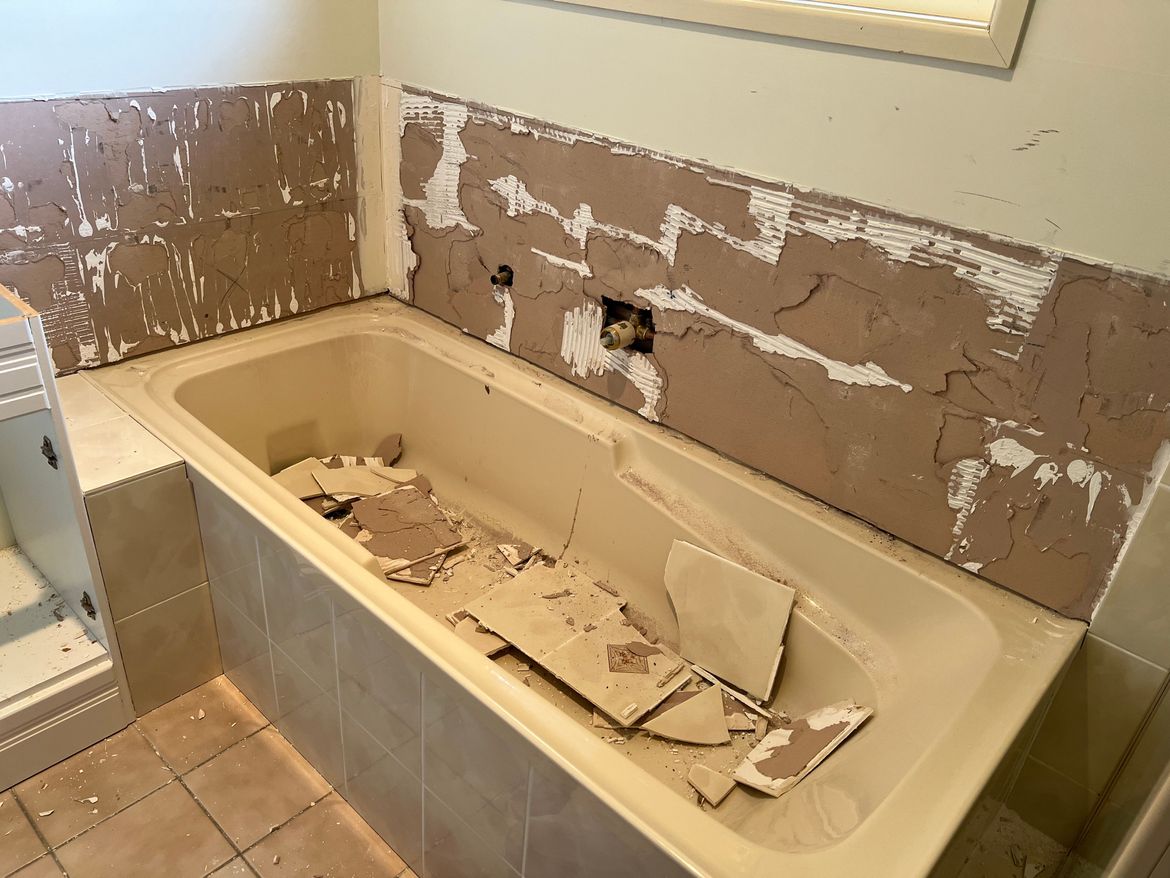

- In my case, I had removed part of the wall behind the tiles near the bath to inspect the plumbing (cartridge sizes etc) inside the wall.
- In this process we discovered that we could not use our desired tapware due to cartridge sizes - and we did not want to call a plumber to re-fit the plumbing behind the wall.
- Instead we chose an alternative flick mixer for the bath and shower (later simply re-painting around where it met the tiles to match).
I then decided that instead of painting these wall tiles and repairing the gap, I would lay new tiles myself - something I had never done before!
It did mean however that I had to re-do the wall behind the bath - installing new noggings and cement board!
(Let's just say my husband was a "little shocked" to come home and discover an entire wall missing?! 😳)
Removing tiles behind the bathtub
Replacing wall behind the bathtub

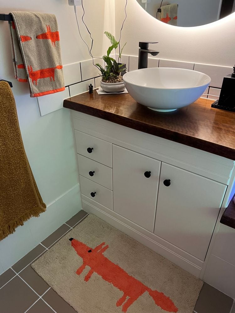

- Paint vanity unit (if keeping). (I replaced the top of the unit with a live edge slab, but kept the base and just painted it.)
- Prepare live edge slab for vanity top:
- For a lustrous finish do LOTS of sanding
- Apply a touch of stain if desired
- Use a good quality varnish so it will stand up to bathroom use

- Do a test-fit of your basin and vanity top.
- Because our basin was higher than before, we had to purchase an extension and new trap for the waste water.
- Ensure your tapware is in an appropriate position near the sink.
- Mark hole positions for waste and tapware.
- Drill hole for waste in vanity top, and for basin tapware.
- Install vanity top onto base.
- Install basin into vanity top, along with tapware and waste plumbing.

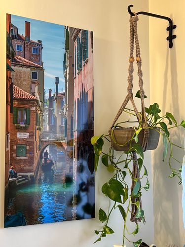

Hang pictures on wall:
- I chose metal prints which look just fantastic!
- Consider purchasing unique digital images online from places such as Shutterstock and send to your favourite online printing store.
Install plant hooks and plant up some greenery in hanging baskets:
- Devils Ivy will thrive in very little soil, and is pretty forgiving if you forget to water it for a while!

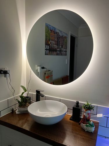

Hang a mirror:

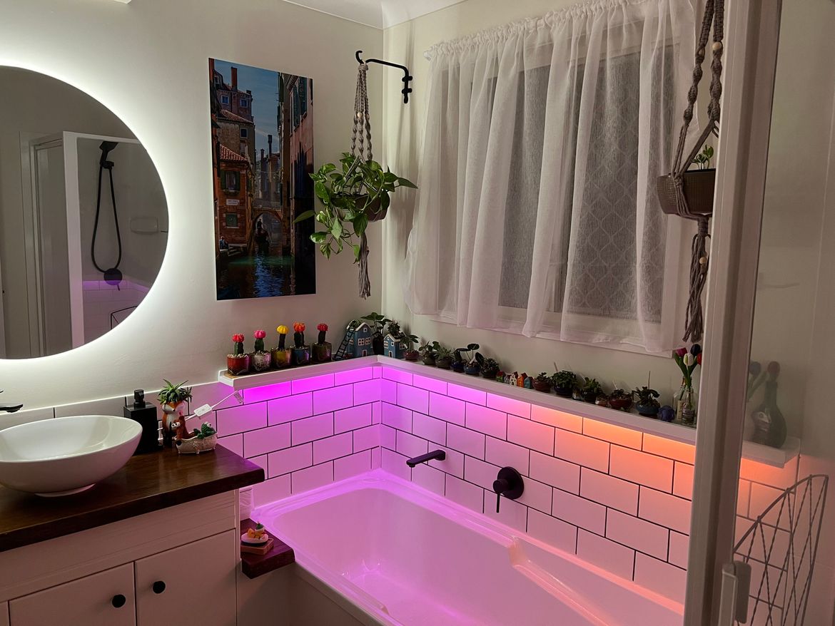

- I made my infinity mirror from scratch - it wasn't difficult at all.
- Use a smart LED light strip or plug a standard one into a Smart Plug and it will come on automatically at night!

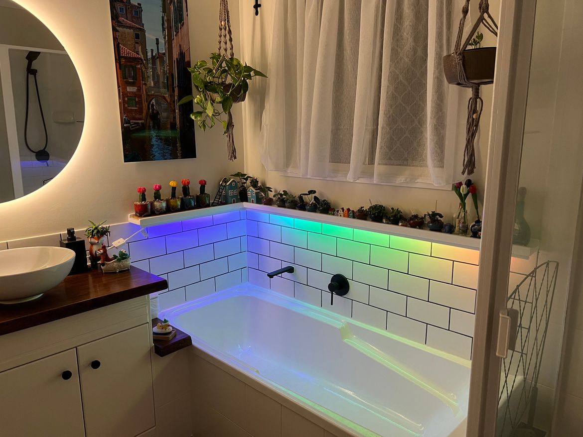

I made a purpose-built shelf to go around my bathtub:
- I attached a smart lighting strip underneath it.
- It turns on automatically at night, and I can change the colours and mood of the lighting from an app on my phone.

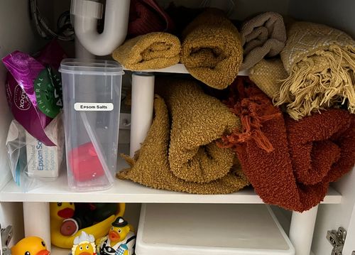

I also made a couple of stacking shelves to fit inside our vanity unit, for storing towels and bath-time goodies.

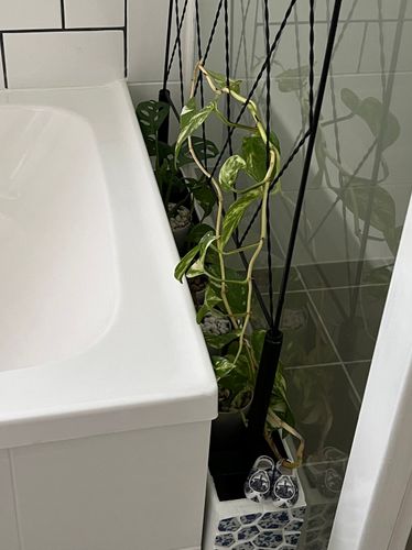

I also made a pot plant holder to go between the end of the bath and the shower:
- It holds a small metal trellis to support plants twisting their way up the support.

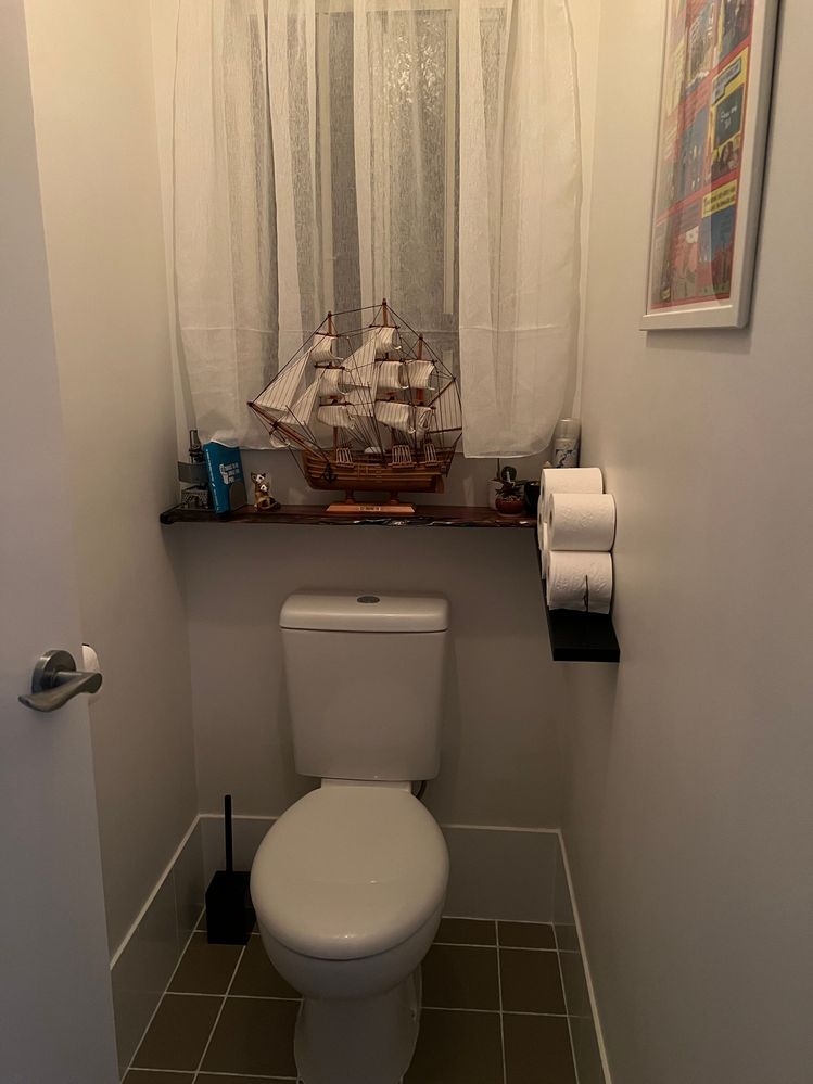

Add funky toilet roll storage to amuse your guests!
What about another matching live edge shelf in the toilet

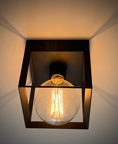

Have a think about lighting too - I ended up changing out my lights for something a little more modern and industrial:
- In the toilet it was just a bulb and DIY shade that we could do ourselves
- In the bathroom we needed the electrician to install the new lighting above the mirror for us.
