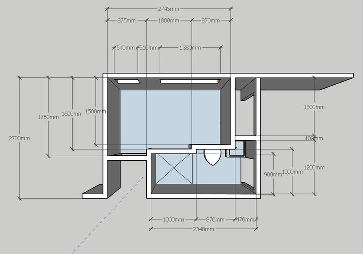

We are planning to renovate our bathroom and possibly add an ensuite by combining the toilet space and taking some of the BIR.
We would like to do the renovation ourselves (where possible) and this would be our second room renovation (laundry already completed).
The challenge we have is we already have a small bathroom and the only way we can create an ensuite is to cut the BIR in one bedroom and link it. We want to avoid window or major wall moves so that limits us to the configuration. Below is our current bathroom layout
And here is what we have thought up so far. I know it's a little funny with the corners, but the idea was to maximise the flow of the ensuite whilst keeping it as compact as possible. We would rather not use up the whole BIR and do not want to move windows so the wall positions below are really our only option.
It would be great to get your opinion on how we can lay the rooms best to maximise space. A shower over bath would be ideal in the main bathroom though open to suggestions if it is really needed these days?
Any comments/feedback greatly appreciated

Hello @dmorganti
My apologies for the late reply. Thank you so much for sharing your question about your bathroom layout.

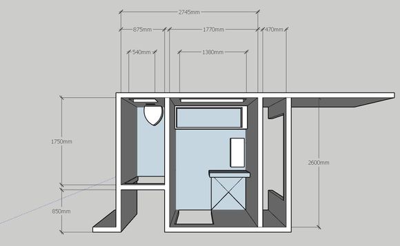

I'm sure this is an exciting time for you as the possibilities for your bathroom renovation are numerous. I've kept your dimensions as you've stated in your first post. Everything you see on the drawings is close to real-world appliance sizes.
Below are my suggestions:
You can use a standard shower enclosure in the ensuite but it will not allow you to use the full length of the wall unless you change your window. I strongly recommend using a heat-light-fan combo to make sure you get good ventilation in both bathrooms. If you wish to see the layout in another configuration please let me know.

Thank you @EricL for drawing that up for us and the further recommendations.
Using a bifold door in the smaller bathroom is a really good idea for space saving and we were planning on putting an integrated wall toilet in the small bathroom to maximise space. I think we will go with something very similar to what you have drawn up, including moving that door forward and keeping the walls straight.
I believe we need a structural engineer to have a look before we start anything as I am quite sure there is a load bearing wall between the bathroom and bedroom so this will slow us down especially since Melbourne has gone into another lockdown! Progress on getting this started may be slow, but our aim is for the end of this year.
