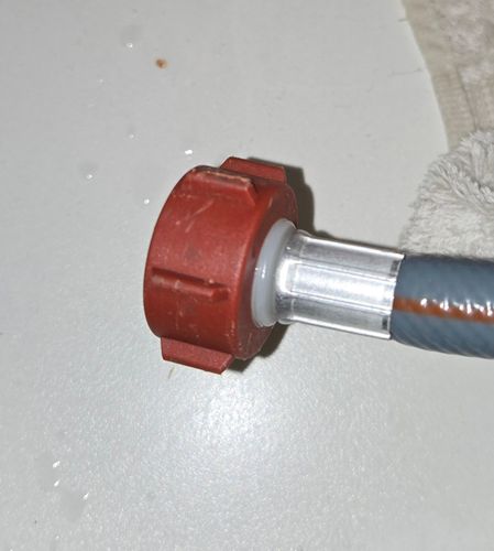

Hi! I have a sudden water leak right below this blanking cap to the hot water inlet for my washing machine. How can I fix this? Any help please?
Welcome to the Bunnings Workshop community @kksrivatsa. It's terrific to have you join us, and many thanks for your question about stopping a leak.When you say right below, is it the cap that is leaking? If so, a cap on a threaded outlet would typically be sealed with plumbers' thread tape or potentially an internal seal. It sounds like the seal on the cap has failed and needs replacement. Alternatively, in some rare instances, the cap itself might have split if it is made of plastic.
If you can take a picture of the area where it is leaking, our helpful members might be able to provide further advice. Let me know if you need a hand uploading images.Please let me know if you have any questions.Mitchell
Hi Michelle ... the leak appears right below the Red Cap in the image. My initial thought was that the Washer inside (image below) is leaking, but that does not appear to be the case. This is a relatively new washing machine - 1.5 years old only. Thanks!
Can you check around the red fitting to see if there is a split in it @kksrivatsa? It would either be that the fitting isn't tightened enough, the washer needs replacing, or there is a crack in the red fitting on the hose.
